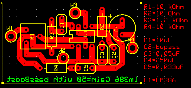

I iceman Member Joined 2003 smidefors.se 2003-08-06 10:25 pm #1 2003-08-06 10:25 pm #1 I made a pcb for LM386 headamp and wonder if this will work? I want to use both gain=50 and bassBoost. Attachments head_lm386.png 13.8 KB · Views: 249
