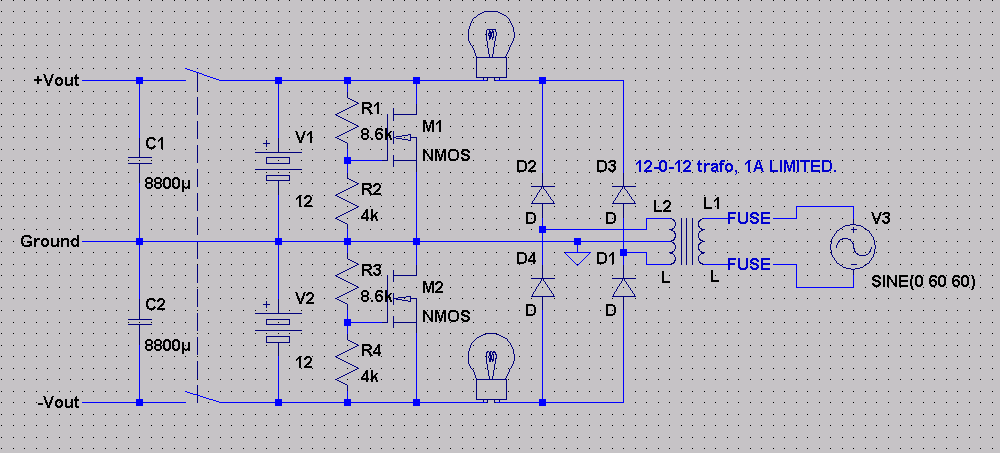

Hello all.
I currently run my bench off of two 12V 7Ah lead-acid batteries, but if I'm to use my latest amplifier designs, I might need help keeping them charged. I use the batteries because I don't have a transformer that will supply the required current.
So I thought of this.
The batteries are kept charged constantly, and the trafo is protected by the current limiters. Large transients will be pulled from the batteries, with a limited amount of help from the input transformer.
How will this do?
Thank you,
- keantoken
I don't see how this could work. The MOS transistors will be reversed biased by the charger, and they will be equivalent to a 12ohm resistor in series with a diode. Is this your intention?
And if the reversal is just a mistake, it won't work either: such current sources only work with depletion devices, such as jFETs.
I realized my mistake after posting. At any rate, the base concept is to use a CCS as a current limiter so as not to ruin the trafo.

A pair of 12V 5W bulbs would probably be sufficient as current regulators. They are simpler, cheaper, and more robust than any semiconductor regulator.
You have to make sure the open circuit voltage of your transformer + rectifier cannot rise above 14V, otherwise you risk damaging your batteries in the long term.
What about the impedance of the batteries? My reason for preferring the CCS variation is so that the trafo will be allowed to improve the line regulation, without high series impedance. Is this reasonable or do the batteries already have a fairly low series resistance?

What I want to do is have my batteries constantly on float charge, and never have to worry about taking apart my bench supply to charge them. I was thinking that if I couldn't buy a transformer with high enough current, I would still be able to test hungry circuits because the batteries would take care of the transients.
I don't like the idea of switching, because it's more complex, more expensive, and requires PCBs, which I can't make yet.
If the trafo puts out too much voltage at floating output, I can just make a shunt thing to pull down the voltage by drawing some current at excess voltages.
To limit current, I can simply use lightbulbs as suggested.

So here is the schematic.

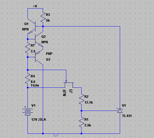

Okay, out of curiosity, I though I would see how little components I could use to try and make a discrete charger like the one in the post above.
Charging current will lower with temperature, so I would suggest to use a fan and put Q2, Q3, and J1 somewhat away from power components and "upwind".
The only reason this shouldn't work is if I don't understand FETs properly. I'm assuming the FET turn-on voltage is around 2.5V, so the FET begins to turn off when charging current goes below somewhere near 30mA. This lowers the voltage.
According to something I read, SLA batteries have a 5% discharge per month. Since the float mode is triggered with current sensing, would we have to match the current exactly with the self-discharge current or would the battery self-compensate? I heard that FETs variate a lot between same devices, but I don't know whether this tolerance would have enough of an affect to cause problems.
I am buying the Antek 0515 transformer (15V, 50VA), and with my 8800uF caps, it should be enough for what I want I think, but I would still prefer to have the batteries to stiffen the supply.
If I were to simply limit voltage to 13.8V, would the batteries be fine?
- keatoken
keantoken,
Here's some feedback.
1. The article you posted pretty well tells you what you need to do to charge SLAs. The battery will never reach full charge with only 13.8 volts applied, and you still need to limit the current; especially if the battery voltage is very low when the charger is turned on.
2. I'm not an expert on batteries, but for batteries in the 5 - 10 A Hr range, NiCad may be the next best choice. I believe NiCads require 2 mode chargers for best performance (life).
3. If you don't want to use an automatic dual mode charger, you might consider a manual one, where you manually switch in and out a high current charge circuit that will be in parallel with the 13.8 volt supply.
4. You need to realize that batteries can put out very large currents under overload conditions and that could cause safety problems. Fuse the battery for safety.
5. Almost all JFETs (not MOSFETs) are depletion mode devices. This means that at Vgs equal zero the device current will be at the maximum (Idss). As you reverse bias the gate (wrt the source) the drain current will decrease (like a vacuum tube). (Thus the FET regulator you posted won't do what you want.)
6. All semiconductor devices can have wide parameter variations from device to device. (Check the data sheet on BJT current gain, or a JFET on Idss, or a MOSFET on Vt.) Any "open loop" circuit where it is desired to operate transistors in their active region will give disappointing performance. Therefore, feedback is almost always used. Note that a voltage follower circuit uses negative feedback. A common emitter circuit with a (bypassed) emitter resistor has negative feedback.
7. Precision analog circuits require feedback. Period
Rick
