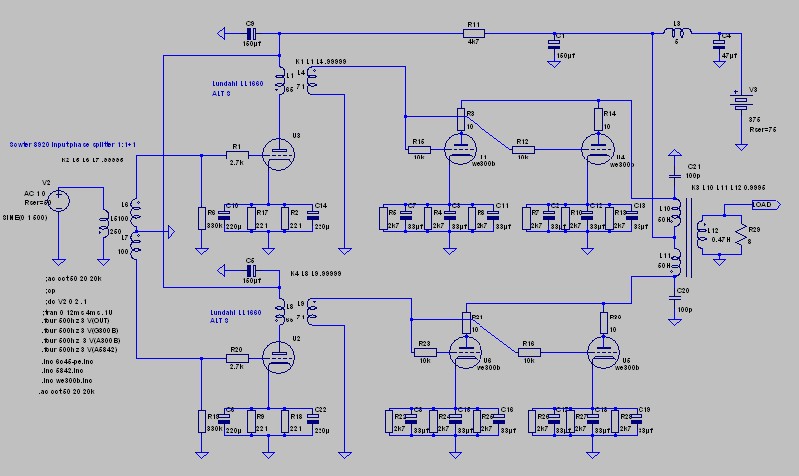

Will this work? the driver tubes are either ECC99 or 6C45's.... Phase splitter is a Sowter 8920 Transformer. Each phase of the driver stage is IT coupled to two paralleled 300B output tubes via a Lundahl 1660 transformer in SE to SE configuration.

A cautionary note: with simple cathode bias, the 4 "finals" have to be CLOSELY matched. Obtaining CLOSELY matched quads of 300Bs could be quite difficult.
Implementing Dennis Boyle's combination bias would provide a means by which imperfectly matched tubes are compenstated for.
Use unbypassed 220 Ohm cathode resistors "under" each "final". A bias supply combined with 4X individual bias adj. pots. allows the setting of the "finals" at identical idle currents.
