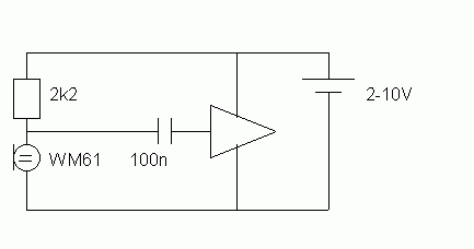

Hi Matt,
No, this will not work. You've short circuited your input signal to the amp with the battery. A better way is to do it like in the picture below.
The external drain resistor of the FET in the capsule should not be too big, as the output impedance of the capsule is not so high (for most electrets it is about 10kOhm). High drain resistors cause some compression of the signal and more distortion. Typical values that can be used are 2k2 to 4k7.
Steven
Steven

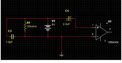

Ah yes now that I look at it it is clear what you have said. I didnt really look at the diagram to see if it would or not work, I just copied it from somewhere else.
Although the circuit is faultly is does infact work to a certain degree it does successsfully charge the plates and retrieves a signal, but at a very low level which makes sense if the output is shorted.
I have now made the small adjustment from mine to yours and it works flawlessly, albeit with slightly different vaules. Measuring a SS d2905/97 now give the same as scans measurements. I had been using a dynamic mike, this was useless for measuring as its resonance is at 2khz, slap bang where u dont want it.
The only saving grace the dynamic has is its vocal performance, im quite a good singer and had it connected into a guitar amp which produced very nice results, its got very nice clarity for a £5 module.
