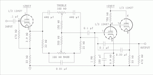

Any suggestions on improvement would be great, I know its not going to be perfect.
I drew this up based on the svetlana design using an EF86 strapped as a troide for the first gain stage and I decided to insert a tone circuit and balance control with a bypass switch.
(see 6th Street Bridge: Triode Connected EF86 linestage and headphone amplifier )
This is where it got a bit muddy for me, I am not sure I have got this part correct, its based on the Baxandall design. I get the feeling I may need to insert a coupling cap somewhere in here
Im also looking if the final gain stage can easily be modified to suit an ECC83/12AX7 instead of an ECC88/6922.
While I dont intend to use headphones anytime soon, it would be nice to have it work well with them since im going to the trouble of this build.
The link notes that it really only suits high impedance headphones, I dont know how expensive and/or common these types are.
Anyway, here is the schematic:

Ignoring all else (good, bad, or indifferent), that setup has a problem with the listening level changing whenever the tone shaping circuitry is inserted/removed.
IMO, tone controls that can be totally removed from the signal path, when not in use, is correct. Few recordings benefit from the presence of tone controls and the sonic damage they can inflict on good recordings can't be ignored.

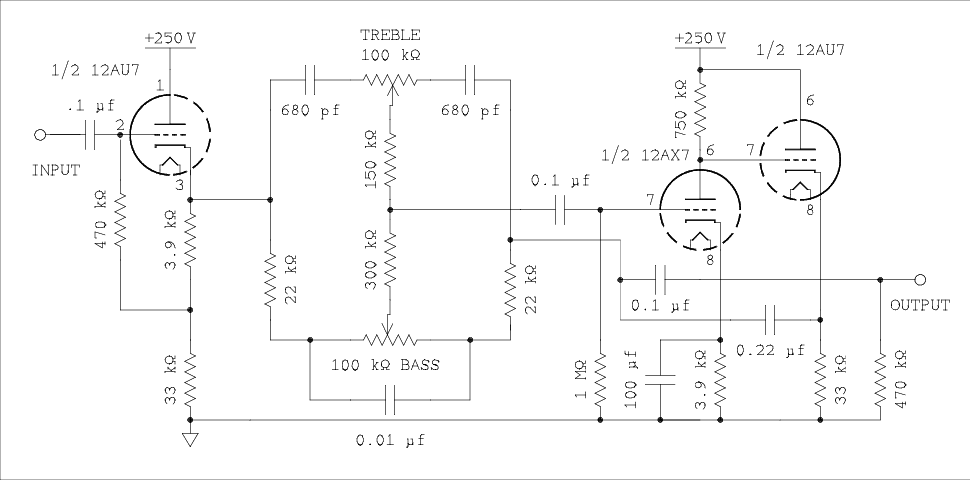

Really good tone controls are not simple, as the provided Max Robinson setup illustrates. It's "unity" gain and does not alter the listening level with insertion/removal. Two bottles per channel for an infrequently employed feature is (IMO) extravagance. The bottle count can be reduced to 1/channel by replacing the cap. coupled cathode followers with DC coupled ZVN0545A source followers.
The tone control stuff has insertion loss "baggage", regardless of where it's placed in the chain.
Max Robinson's sophisticated implementation of Baxandall style counterbalances the losses with an appropriate amount of gain.

Yes you need a coupling cap after the bypass switch, and a couple of resistors to bias the upper tube.
It looks like you're trying to build a white cathode follower, so you also need a small resistor in series with the anode of the upper tube.

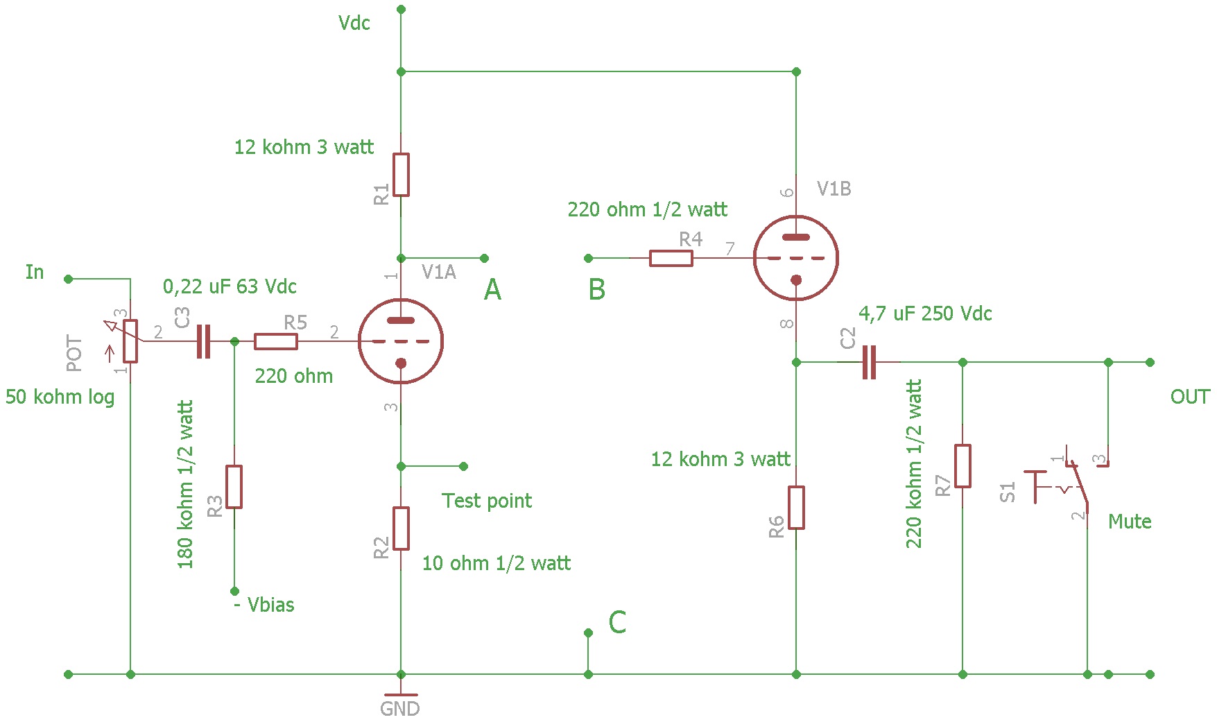

In my setup I also bypass my James TC with switches. I designed it with two NPN's (emitter follower and gain stage) to compensate for the signal loss.
The question: "Main question is whats the easiest way to implement a bypass switch to this?" is solved it this way. See my circuit diagram of the amp I made. Perhaps wil publish some pictures but not sure if somebody at all is interested.

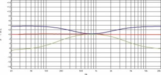

Hi

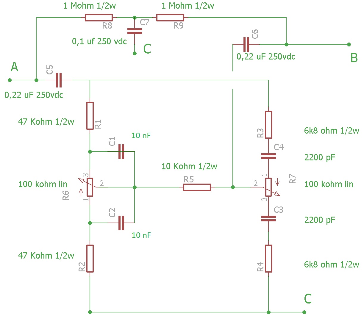

as wrote time ago, I have done this:
Is a simply and effiicent diagram
You can use or not the tone control.

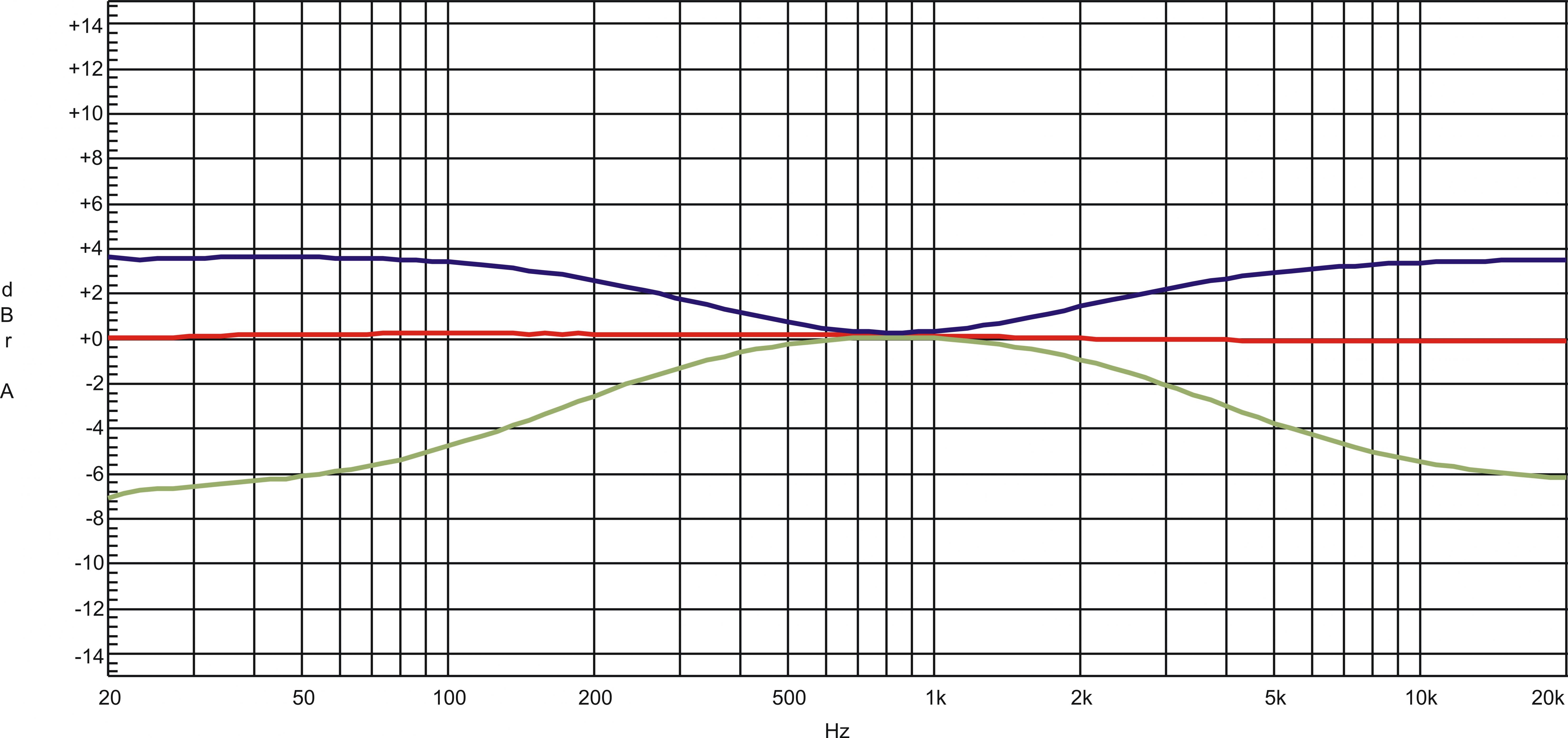

Changing the tube you can have a similar gain.
The ECC88 with control or 6N6/6H30

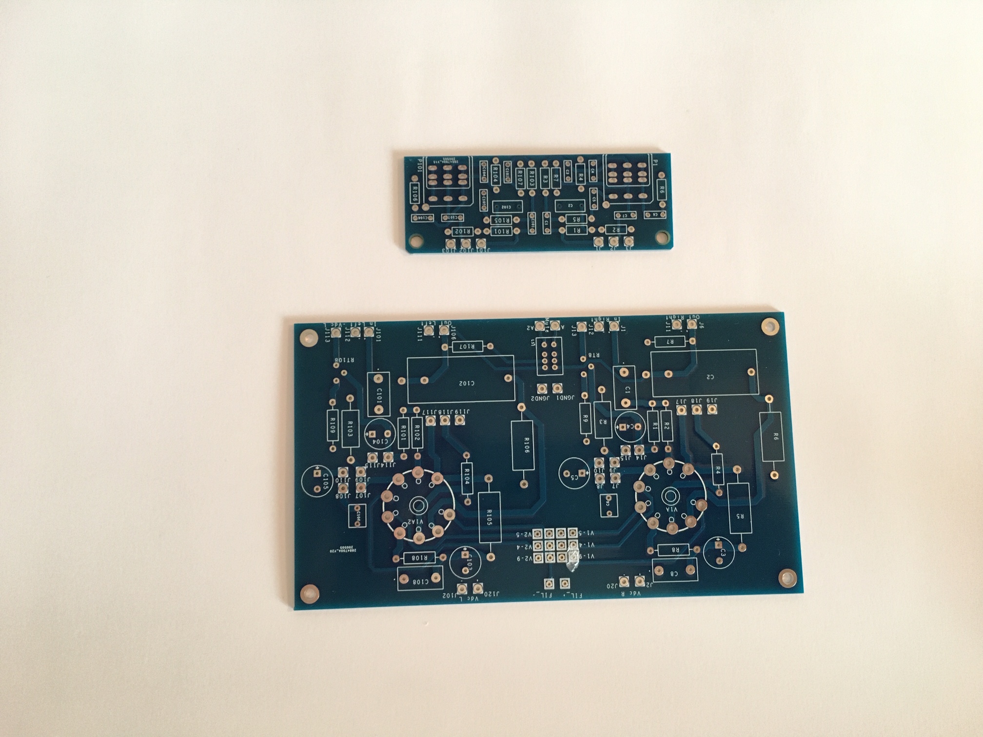

And the pcb is connected with only 3 pad each channel
