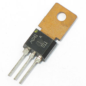

41011 sounds like custom made BjT's from RCA/Harris - check also the logo

the 41011 is screwed to a heat sink that's then screwed to the PCB. I'll have to look on the heat sink side.
I remember a Motorola symbol on either 8099 or 8599

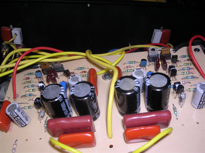

Hi gp4Jesus,
I've repaired a few of these amps. They aren't that bad actually, and the design is relatively straight forward. Belles is being silly about his claim to "IP" for that older design, and you want the info for service reasons to repair an existing amplifier. If it makes you feel any better, he wouldn't respond to me either. Therefore I simply fixed it after recognizing the basic design elements. If I had one in front of me now, I could talk you through it.
Basically, the rear PCB contains the voltage amp section. The boards mounted on the heat sinks contain the current amplifier stage and receive the two drive lines. Does that explain the connections on that cable? The transistor on the heat sink is the heat sense transistor for bias control. I have attached a couple pictures of the amp I did back in April 2006.
I didn't reverse engineer it as the amp is not that complicated. One thing you must remember when repairing amplifiers is that sometimes the amp goes DC. This will reverse bias one of the diff pair transistors and damage it. At best, the characteristics may change. Worst case, you end up with hissing, popping or intermittent open failures that cause intermittent DC offset to rail (nice eh?). Therefore, replace all pairs of transistors with matched pairs.
Note: Transistor pairs matched by measuring beta may be completely mis-matched as the temperature affects the readings a fair amount. Match transistors using a jig, basically a diff pair with current source, two matched collector loads and matched resistors from base to common. Measure between the collector loads. The better match will have a lower differential voltage.
Also, I think the predriver transistors had to be mounted differently. Look carefully at the picture of the heat sink. They are mounted on a pair of screws (hey - that's how I found the original ones mounted!). You can also see that I've cleaned the flux off the PCB. That is the only way you can check for good solder joints, solder bridges, cracked traces or poor solder wetting. If you don;t clean your flux off, those defects will be hidden from you.
-Chris
Edit: Download the pictures so you can make them larger to see more detail.

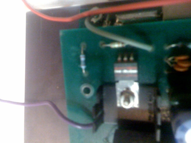

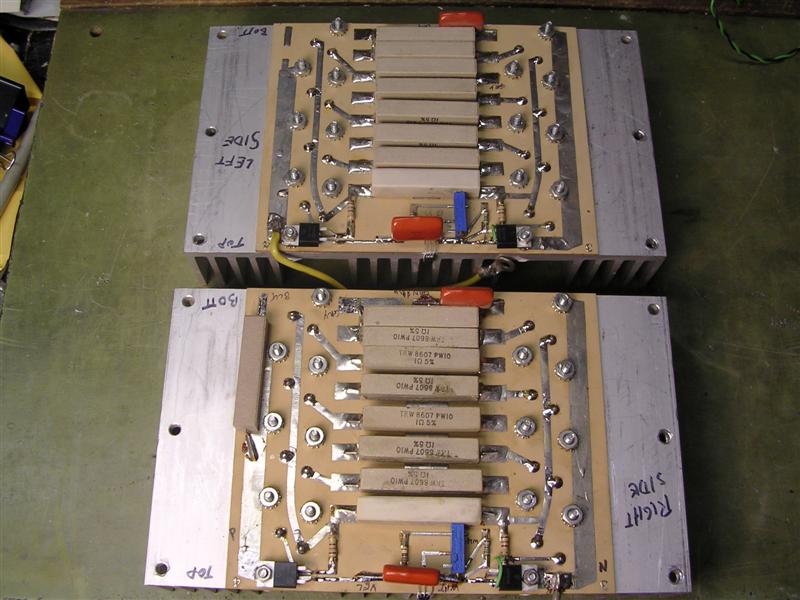

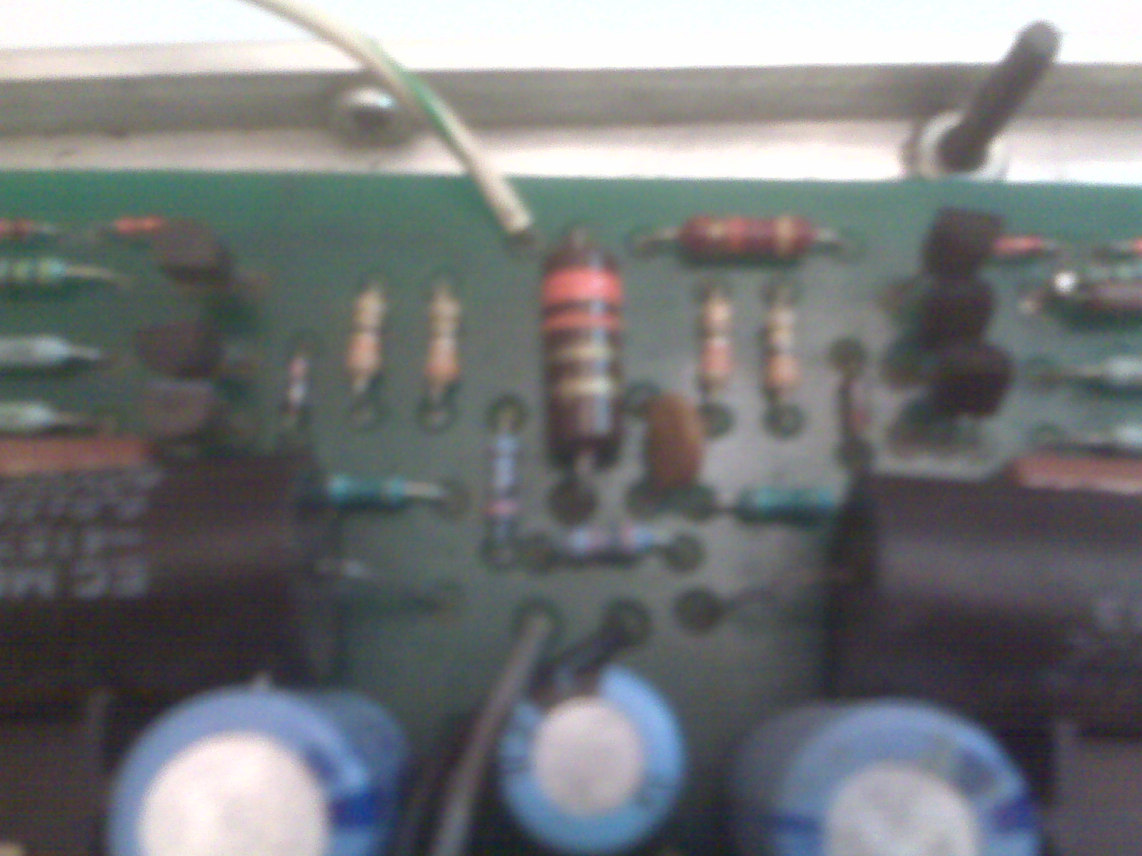

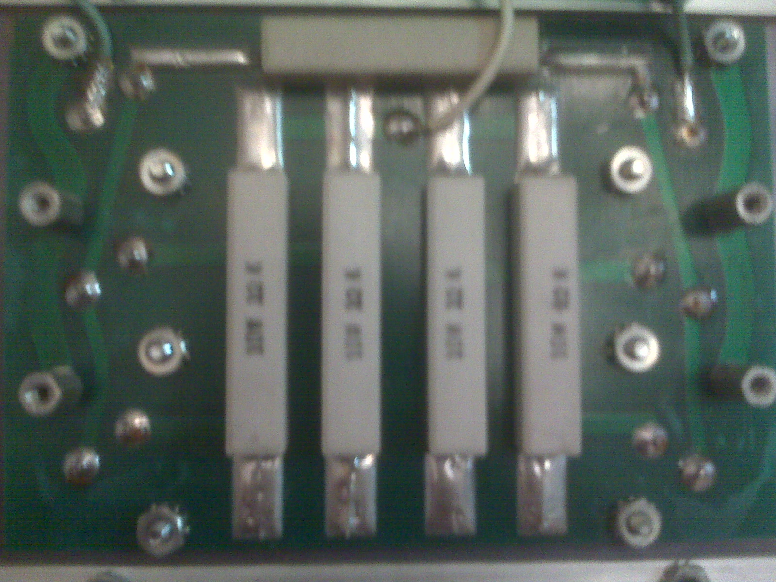

a few bad pics from a blackberry

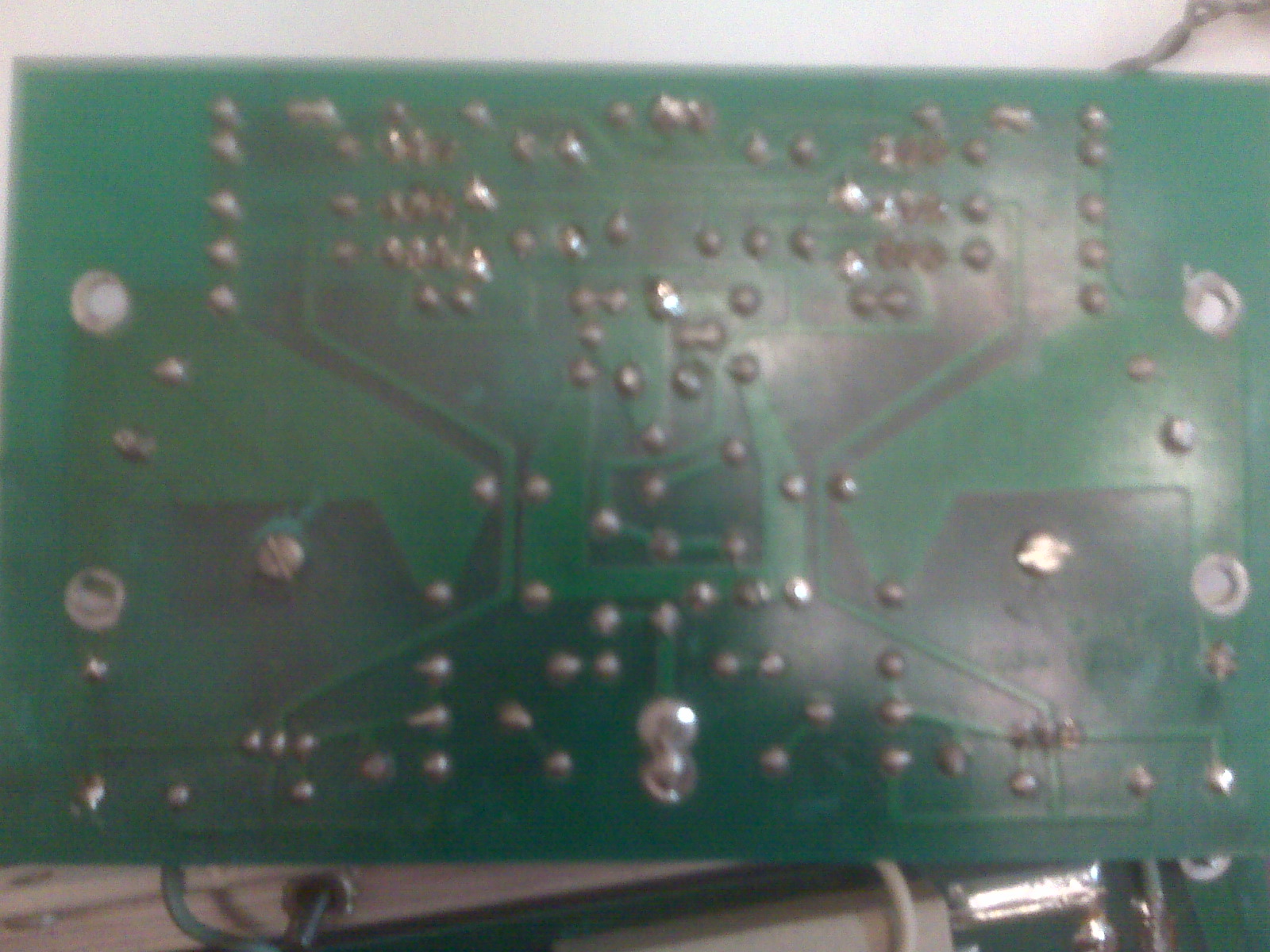

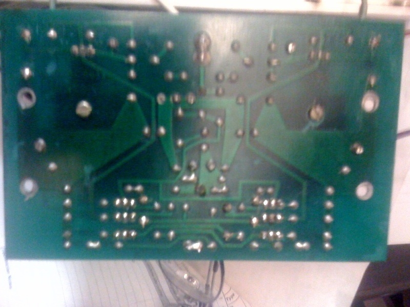

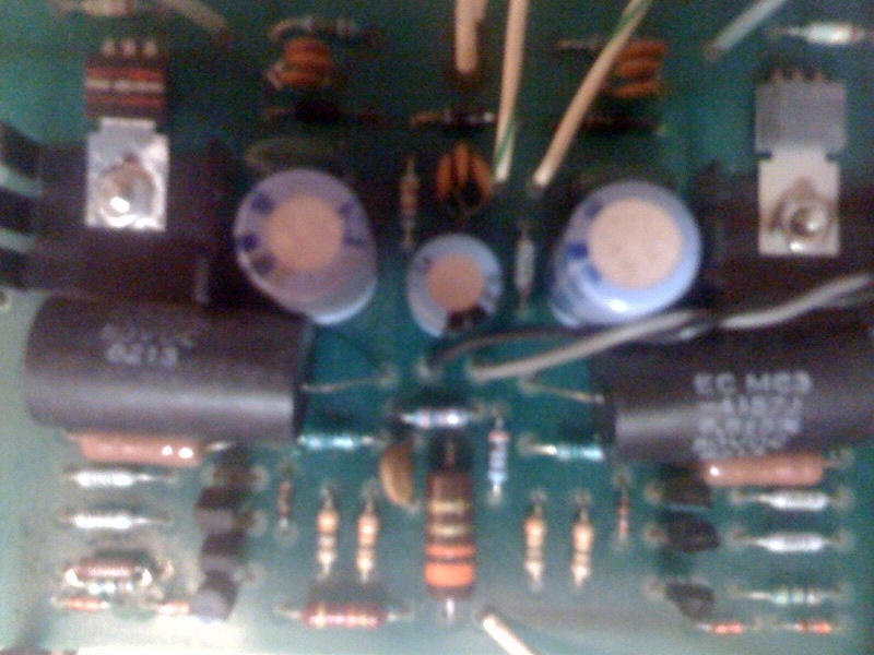

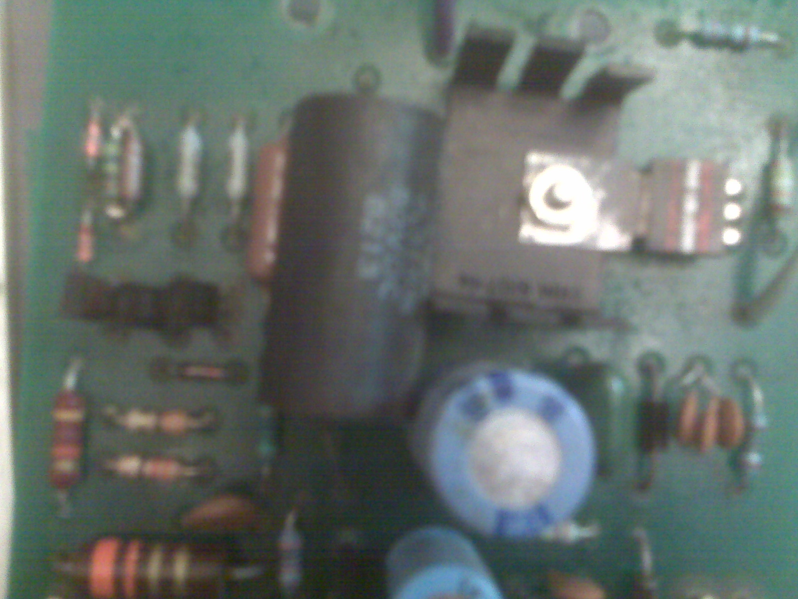

subject pretty much says it. driver board is about 98% symetrical
1st pic: "output board" says it. the reverse is the heat sink with the 6 devices for this channel-that's it. Don't know how this works w/5 resistors but...
2nd pic: this half of the board connected to negative PS rail. Look carefully in upper right, you'll see the multi-colored driver transistor w/no other markings attached to a heat sink.
look to the left. Peaking around the left side of a large black bi-polar cap is the tan thing that may be a radial cap or a resistor.
just to the left of that, centered, are the MPS* 8099s & 8599s. That big resistor "divides" the negative from the positive.
* MPS-prefix of same
3rd pic: "dif transistors" a shot of both columns of MPS 8099s & 8599s
4th pic: "artwork" on the reverse side of the driver board.

If we have the last picture (voltage amp board, solder side) in higher resolution and the according high resolution picture from the component side (top view) of that PCB, we can create the schematic diagram of that amp. It looks like a mirror symmetric topology with push-pull NPN/PNP differential input amp.
Any potentiometers on board?
BTW - the asked variable resistor (for bias resp. idle current through the last stage) is to find by picture 2 about post #12 (probably Vishay/Spectrol) und looks like this:
http://media.digikey.com/photos/Vishay Photos/VISHAY^SPECTROL- 043P103.jpg

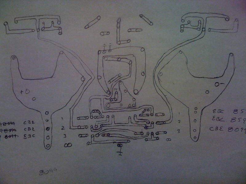

more photos
1st pic: Hand Drawn Artwork (HDA)-approximetly to scale to 4th pic. note mostly symetrical. in next post I'll attach a scanned HDA W/components along w/a better photo of both sides of boards.
1. note left hand land area w/"+;" postive PS rail; 1, 2, & 3 - 8099, 8099, 8599 transistors respectively. #1 & 2 collector's connected to pos rail. #3 emitter connected to same. Driver transistor in upper left corner; base connected to transistor #2's collector
2. note: right hand land area w/"-;" negative PS rail; 1, 2, & 3 - 8599, 8599, 8099 transistors respectively. #1 & 2 collector's connected to neg rail. #3 emitter connected to same. Driver transistor in upper right; base connected to transistor #2's collector
3. note "~" in the middle of the middle of the pic just above small reverse "L" land area w/3 connections: Input connection
4. middle land area-larger reverse "L" shaped w/7 connections, grounded thru large 3.3 ohm resistor; input shield connected
5. resistor between the #3 transistor's bases. 2 diodes* in series connecting LH #3 base to pos rail; 2 diodes* in series connecting RH #3 base to neg rail.
* *may be Zeners
6. 3 caps, 1 polarized, between rails & inverted "U" shaped land area. note 2 ground connections near top-1 for speaker Ground, the other to PS neutral/ground
the following applies to both PS Rails and sets of transistors:
7. connections on rails (above resistors connected to #1 collectors) connected to small elbow just above #1 emiter by 2* series resistors*-one end of diode connected between them*, the other diode end connected to #2 emitter
* assume both are resistors; the first may be radial cap on Rail side. see pic w/2 collumns of transistors-tan "whatever" peeking under big black 6.3V cap. 3.3 ohm dividing view.
8. #1 & 2 emiters connected thru separate resistors to #3 collectors in OTHER set of transistors
I could include more as I have another copy of HDA with all components drawn in-makes terrible photo
9. multi colored driver off neg rail-counterpart to 41011 driver off pos rail. violet wire neg PS feed.
pic w/2 collumns of transistors. Tan whatever (Tans) peeking under big black 6.3V cap. 3.3 ohm dividing view.
Refer to note #7: Resistors closer to center than "tans," in series w/same. vertical diode between & below them.
Refer to note #5: series diodes in bottom left and right & resistor connected to #3 bases
I pray this helps you help me
tony

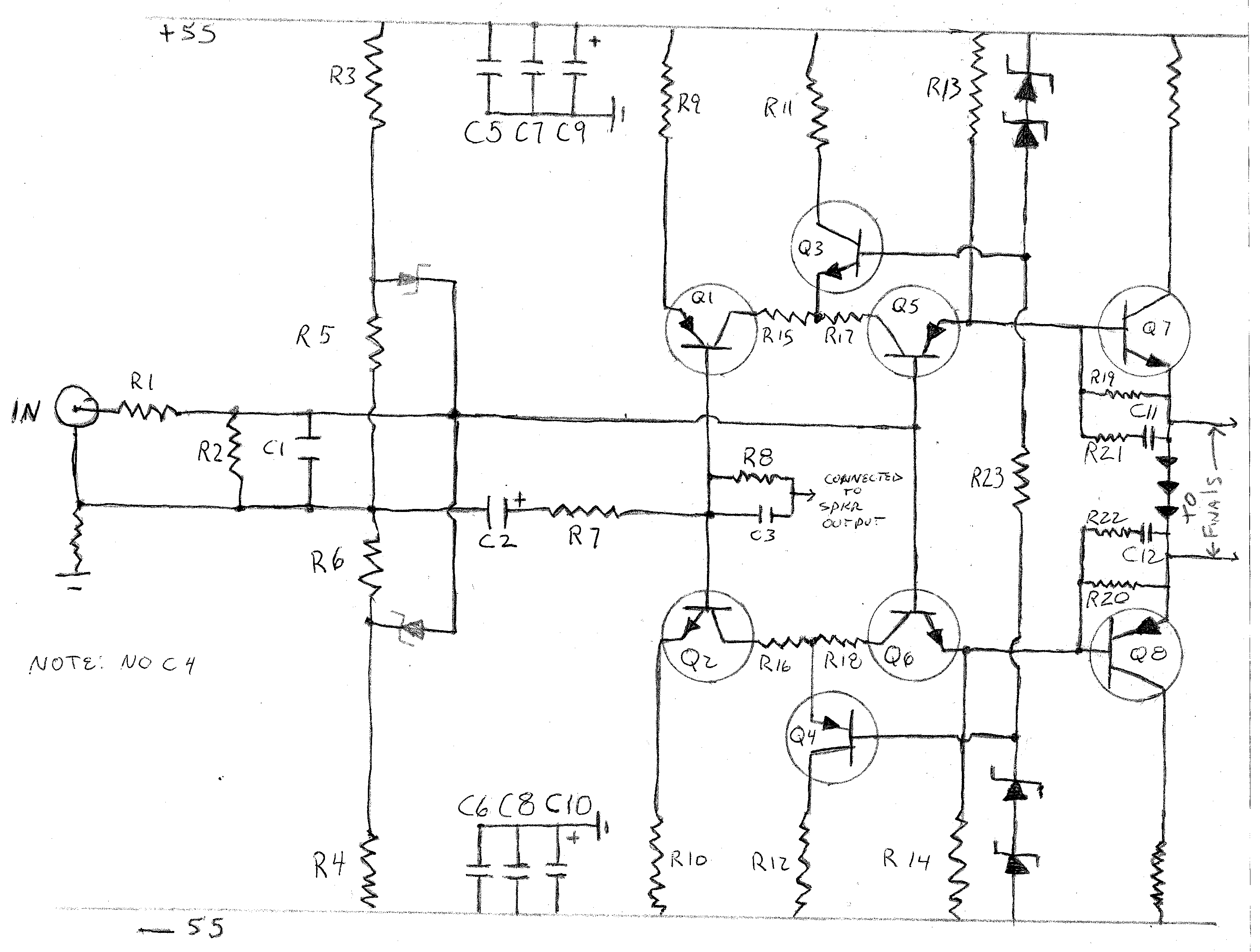

schematic finished! No simple bias adjustment mod
Took me 4 tries to get from the 1st, confusing, lines crossed every which way, to a simple, flow, (hopefully) easy to read for some who hasn't had the hardware in front of them.
I believe one of you gurus can come up w/THE "bias solution."
I compared it to some other schematics-2 each: Hafler & Pass. I believe this design will not allow for the typical bias pot.
In the next edition I will adjust spacing in some places, complete the parts list, & post the schematic & parts list.
Just before I went to bed (@ 5am today!) I discovered the driver transistors, when viewed from "pin side," has one corner different than the other 3. W/this in mind looking @ the other, I quickly realized the "striped" driver is really the same type... UPSIDE DOWN(!) [as the other driver (041011)]
Also, in 3 places, I see 3 paralleled components w/the #15 on them & nothing else. 1 reversed polarity from the other 2. I thought they were disc caps. DMM testing reveled fixed resistance.
Next reply: schematic & parts list

regarded the driver types "041011" and 040011 I think, the correct type is
"D41D11" and "D40D11" from
"Semiconductor Data Handbook 1977" "General Electric"
I have found this about follow URLs:
D41D11 datasheet and Application Note, Data Sheet, Circuit, PDF, Pinout | Datasheet Archive
D41D11 General Purpose PNP Output & Driver Transistor-The Electronic Goldmine
D40D datasheet and Application Note, Data Sheet, Circuit, PDF, Pinout | Datasheet Archive
in cross reference list about
http://www.kikyu.co.kr/image/uppdf/PDF200903121136.pdf
I have read this:
D40D11 2SC1014 2SC1243 D40D7
ECG210
D41D11 2SA624 2SA703 D41D7
D41D11 ECG211
D41D7 2SA624 2SA703 D41D11
but I haven't success the master resp. genuine datasheet from General Electric. Perhaps one of the members have this data book from the attachement resp. from 1977 and can scan in and posting the appropriate pages about this transistor models.
belles drawing
Thanks to tiefbassuebertr; you lead me to the upside down NPN driver transistor D40D13.
And now some thing to whet your appetites:Attached is a drawing I hesistate to call a schematic in fear of violating Belles IP (Intellectual property) that's about 25 years old!
some disclaimers & assumptions:
1. Q1-Q6 as the NPNs in this collection were marked on their faces "EBC."
2. EBC looking left-to-right @ the faces of Q7 & Q8.
3. I assumed the 2 diodes* connected to Q5 & Q6 were Zeners* because they looked like the 4 on either side of R23. Yes its possible I have the bias reversed, drawn based on what I interpreted as their* cathodes.
4. R12 has something in parallel w/it - markings suggest a cap. Will check the other channel for same
5. forgot to label resistors between the drivers and PS rails-let's call them R23 & R24; 100 ohms BTW
6. R15-18 same value. O O Bk gold 33 ohms I believe.
Finally I think R23 could be the "Bias" resistor.
I leave this to those w/ far more brains & experience than me.
Next post I will provide more detail w/a parts list. a couple of the resistors do not use standard color coding requiring removal to test.
Thank you all very, very much
tony
