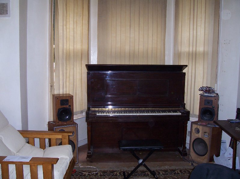

The new armchairs are larger than I envisioned and I like them enough to be getting the matching 3 seater sofa. A huge upright piano and an extra large suite in a small room. lol
The piano is now in the bay to make extra room. I lost a bit of bass from the RAMs (maybe a bit boomier too) but boy do the lower octaves on the piano have some welly now!
As you can see from the pic, only one option for speaker placement and I've no idea what difference the extra bit of ceiling in the bay makes.
Do you like my Wharfdale resonators? 🙂 Beware 'temporary' solutions.
