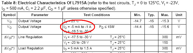

I read through the ST Micro data sheet a number of times looking for an indication of the minimum required current draw and didn't see anything. However, I don't know the meaning of all the speicification abbreviations. Is there a shorthand notation that indicates minimum current draw for regulation?

LHMAudio said:I read through the ST Micro data sheet a number of times looking for an indication of the minimum required current draw and didn't see anything.
Hi, see encircled portion, from the ST datasheet for the 7915AC (p5)... 5mA is the minimum load. Load Regulation spec says the same thing... Hope this helps...
