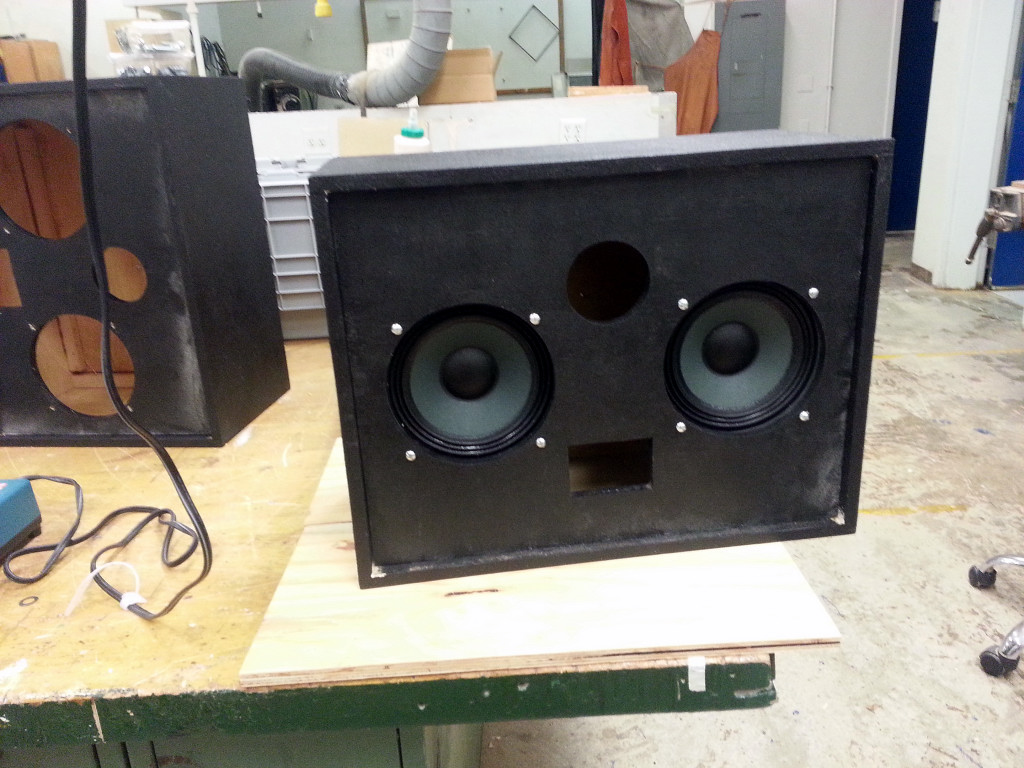

My recommendation, If you are going to spend the time and money to build a cabinet, buy some cheap speakers that will do the job:
Use two of these per cabinet. I wired them in parallel for a 4 ohm load, and I made two cabinets. I added a bullet tweeter crossed over with a 3 uF mylar cap to provide some sparkle. I mounted the speakers in a 1 cubic foot cabinet made of half inch plywood and used a 2 inch by 3 inch square port. I made two identical cabinets. They are clean enough to play electric piano through at reasonable volumes ( a 2 X 50 watts class D amp at half volume) and sound cool when fed by a Marshall super lead cranked to 11 (both cabinets wired in series for 8 ohms).
The cabinet is tuned to 70 Hz and is reasonably flat from 70 Hz up. It's good enough to use as a second set of monitors in my home studio when I want to get louder than my Yamaha's will go. I don't recomend using this setup to play bass at anything above bedroom levels. You will rip the cones out of them due to Xmass limitations.
Dayton Audio PA165-8 6" PA Driver Speaker | 295-015
I made them in a high school wood shop about a year ago. They are still working out better than I expected. This is a camera phone picture taken before the tweeters and grills were installed.

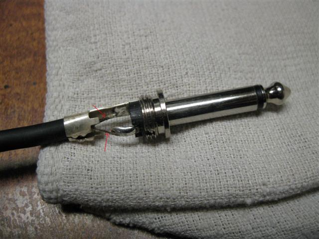

Thanks guys...one more thing please...will it be ok to cut one end off a guitar to amp cable and put electrical connectors on that end to put on speaker like you would do in a car, and have the other end of cable with original end to plug into speaker jack on amp head?
[well, 2 things]
and if I do cut one end off cable for speaker, which wire of cable is + and which is - so I don't mix them up...or would it hurt anything?
[well, 2 things]
It's not important but for consistency consider + the wire which goes to the plug tip and - the one who goes to plug body/ground.

I would be seriously worried using a guitar cord for a speaker cord, they can NOT handle that type of use.
Conductor gauge is far to low.
True, guitar leads make very poor speaker leads, but
for testing into a small speaker they are adequate.
Mains 5A twinflex with a 1/4 jacks is a much better
general speaker lead solution than guitar cables.
rgds, sreten.
