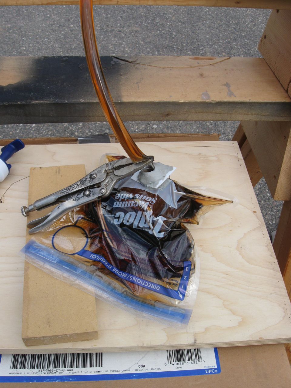

I had purchased a NOS old Stancor PT for the El Cheapo. It buzzed loudly, and I wanted to try and salvage it. I assumed it was a void between the lams (old Stancors don't appear to be the highest quality things in the world, looked to be just dipped in varnish). I was tossing around methods for at-home vacuum impregnation. My neighbor, a materials scientist who uses vacuum impregnation to laminate composites, felt I could do as well with the bags as with any other affordable option. I tried it with some basic urethane varnish. I heated the varnish on the grill, transformer in the oven. I put the varnish in a jug, ran a tube to the bag and used a long nosed vice grip as a valve. I sealed everything up with latex caulk stuff. (The whole setup was my neighbors idea).
So, basic idea, heat everything, varnish in the jug, trafo in bag, pull a vacuum, then open the valve.
Ultimately, it didn't work. It is possible the transformer was too flawed, i.e., the vibrating lams were sealed in with varnish and even the vacuum couldn't get more in there. I was also in a hurry, and didn't let it impregnate for more than a minute or so when I should have waited 10.
I do believe the method has merit, but deserves to be executed properly and surely won't solve every last problem.

Hi there Paul (pajandal): Hope you try another method to get more/new varnish into the OST. SUBMERGE the OST in a vat of varnish, heat the vat over a grill (standby with a fire extingushier), let the heated vat sit for several hours. This idea was recommended in a bicycle maintenance book (now lost) for lubricating bicycle chains with parifin (a dryer form of oil, not greasy on your leg). It works well. ...regards, Michael
That transformer is long gone. Vacuum impregnation is a step well beyond just submersion. Varnish is pretty thick, and the gaps it needs to fill are pretty tiny. Submerging in varnish might be better than nothing, but certainly won't fill all those little spaces. What it will potentially do is make those spaces into unreachable bubbles, which is probably why I couldn't salvage the unit (I suspect it was just dipped with no vac at the factory). The idea with the vacuum is to pull all the air out before introducing the varnish (much better than sinking in varnish and then introducing the vac as others have suggested).
I heated the varnish over a grill. Somewhere there is a dedicated thread where I mentioned the temp my neighbor suggested, but I used a cheap deep fry thermometer to monitor the temp. You can certainly extinguish a varnish fire, but I'd hate to have to replace the grill or scub a bunch of burnt varnish off of it!
Triumph or Norton used to recommend that way of lubing a non o-ring motorcycle chain. Shoulda been titled How to spend an afternoon lubing a chain Thank goodness for ChainWax, paraffin based spray lube.
Maybe next time a combination of pressure and vacuum to dislodge any bubbles.
