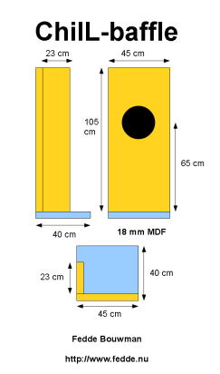

Great and nice work. You have made the design that appear in the page of Wild Burro Audio, a 'folding screen' style. Also recommended the 'QUAD ESL-57' style open baffle:
JE Labs Arkiv: Open Baffle
I also are interested in the Betsy, but I like more the 'Magneplanar' style of open baffle. Anybody have try the Betsy in this model of open baffle, please, can say your impressions?:
The Chill-baffle speaker page

I like the Chill baffle design.

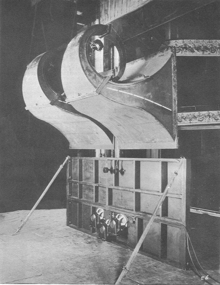

Well, horns are folded up baffles, so the pioneers chose one or more 18" woofers on OBs to support their mid bass - lower treble horns [note the gap]:
