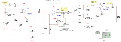

It is too soon to publish any circuits as I am experimenting with almost every aspect at the moment and the sound is still not quite right.
I have transcribed yesterday's circuit from the breadboards and it looks like this.
The first stage was added in a hurry to give us more distortion late last night. Without the first stage we get a "clean" channel that overdrives when the gain is turned over 50%, but it never really distorts too hard.
The tone stack is the usual Fender adjusted to match 100K log pots which I have had handy as well as provide the contour of the Princeton Chorus. The pots should be all audio log.

Thanks for posting, otherwise it would have been only a guessing game.
1) it looks good 🙂
2) you do *not* need +/-60V Op Amps, 50V RMS, etc. 😉
You are doing fine with what you are showing.
3) with those rails, 20X gain in the first stage is about max you can risk with "normal" pickups.
It will clip with an EMG or a Super Distortion pickup, so I suggest you lower U2a to 10X, to play it safer.
4) you don't need higher rails for U1a
Since the diodes are in the feedback loop (I was not sure about your configuration before), and you have "only diodes" there, no resistors, peak voltage will be peak diode array saturation voltage.
*You* are deciding this, so pull some diodes until you are sure you don't reach rails.
5) you are using a non inverting configuration for U1a, so to that "own" generated signal, you also add signal present at its input (pin 2), so if you put, say, 5V (clean signal by the way) there, those same 5V will present at the output, mixed with the distorted signal.
And I think there is where you have a problem.
A little clean signal mixed with distortion helps clarity, but here it may be overpowering.
Another reason to lower U2a gain.
6) the rest looks fine, with the only small detail you forgot to scale the treble cap, C2, which should be 470pF
7) be realistic as what you are trying to achieve.
You can get a very good sounding SS preamp, which is excellent, but tubes clip in a very different way, totally unlike diode clipping.
You can simulate both and look at the very different waveforms.

Good luck.
1) it looks good 🙂
In fact, when clipping diodes are introduced in tube amps, such as infamous Marshall's JCM900 (and a few JCM800) sound is later described by Musicians as harsh/brittle/fuzzy/you name it.
Good luck.

Let me reply :
3) Yes first stage was a quick bolt on very late at night when my son said "what would the distortion channel sound like?". I will need to make sure there is no clipping under normal circumstances. We have 3 electric guitars, two with EMGs , but the old Gibson is still the loudest on its bridge pickup.
However there is not much I can do if someone plugs in various stomp boxes and pedals at the input with the volume knobs to max. This is a major and often overlooked part of a design. You have to draw the line somewhere. You cannot account for everything. Obviously using a tube that can swing to +/-100V at the input certainly helps. We can also add back to back zeners at some arbitrary voltage but that is not soft clipping. Still no substitute for a 200V tube.
This is one of the parts I want to get right - having a +/- 50V chip at the input will certainly help. Shame my bench PSU only goes up to +/-25V. 🙁
4) The diode array as you say determines the peak votage, which is more or less the rail voltage (less the capability of the op-amp, less the 2K resistor). Adding more diodes increases this peak voltage and removing diodes decreases it. Using a lot of small voltage drop schotttkies or germaniums helps shape the curve gently, rather than using say a zener which would be abrupt and almost as bad as the op-amp clipping.
In terms of sound quality, removing a few diodes results in clipping earlier, thus producing more distortion. Adding more diodes suppresses the signal more gradually.
My ideal would be to use just enough diodes to suppress 20-30% below max rails level - some peaks would still escape and reach the rails but with the extra headroom it would still not clip.
In the simulation I used a lot of diodes to drop 15 Volts in either direction. In the actual breadboard I ran out of diodes and used a combination of germanium and schottkies, 26 in each direction, keeping the signal from clipping just under 8-9V with max rails at 17V.
5) I am not sure I understand that. Are you saying that stray capacitances around U1 will feedback distorted singal from pin 1 (out) and 2 (Vin-) back to pin 3 (Vin+) and thus create some sort of unwanted positive feedback? I will try to make U1 an invering amp to see if it makes a difference.
6) for the treble cap I checked with the scope at 50Hz and 5000Hz - I tried to equalise the treble with the bass when the respective pots are turned to max. Around 220pf gave me same treble as bass. I used the ToneStackCalculator for initial design trying to copy the Fender Princeton's curves. I decided that the Mesa Boogie's Lonestar stack is not good, and looked at the Princeton Chorus stack, with uses 50K pots and achieves much more bass, so on the tonestackcalculator I tried to match the curve of that. It still is not good, too little bass, treble is OK. Very subjective matter BTW.
However, my son's friend buight an Egnater valve amp head, and while he was playing I was messing with the clean channel's tone controls, and believe me I could not hear a difference with the treble past 12 o'clock.
7) the whole idea behind it is this - and I may be very wrong.
a) there is a difference in the tone with amplifying the guitar singal by 50 with a tube without clipping, then tapping 1/10, resulting in a mathematical "Av=5" and with simply amplifying by 5 in an op-amp.
b) if I amplify by 50 and get a 50V pk swing, then use 400 germanium diodes to "shape" this signal (saturation at 100V), I will emulate the tube which also clips at 100V and plays with maybe 1% distortion at 50V.
But I may be very wrong. 🙂

No,I do not speak about signal feedthrough or parasitics, I speak about having at the output (and in phase) *any and all* signals present at the +input.5) I am not sure I understand that. Are you saying that stray capacitances around U1 will feedback distorted singal from pin 1 (out) and 2 (Vin-) back to pin 3 (Vin+) and thus create some sort of unwanted positive feedback? I will try to make U1 an invering amp to see if it makes a difference.
Even if you short the diodes , you still have the full input signal at the output.
That does not happen in an inverting amp
Maybe they start clipping at the same level, if you choose the proper amount of diodes, but beyond clipping waveform will be very different.b) if I amplify by 50 and get a 50V pk swing, then use 400 germanium diodes to "shape" this signal (saturation at 100V), I will emulate the tube which also clips at 100V and plays with maybe 1% distortion at 50V.
So the first change is to make the amps inverting so that the input signal does not appear at the output, especially if the output is "modified". Had never thought about that before, thank you.
The second problem is to find a bench PSU for +/-45V... Not an easy task and am a bit cautious to breadboard straight out of a +/-45V supply without any current limiting. And the two OPA445 chips are beckoning...
The third item would be to find a way to pack 100 or 400 diodes on a breadboard and run more tests.

Diodes are an array of between 52 and 80 in the feedback loop depending on what I had in my drawer and how bored I was trying to connect so many together.
For simulation I use NI Multisim version 12. Listening tests are a must, and the curves on the scope after distortion and filtering are nothing to do with the simulation.
I believe that to get a smooth distortion you need to "bend" the curve slowly and incrementally. Otherwise you might as well let the op-amp clip due to its output protection circuitry or because it has reached close to the rails.
This means that the feedback circuit has to be such that it will not activate the op-amp's various protections or limiters in anyway. Some op-amps are much better than others in driving higher loads at full range. I think we did detect an audible difference between the TL072 and the OPA2134 but I cannot say categorically. I am however sticking with the OPA2134.
