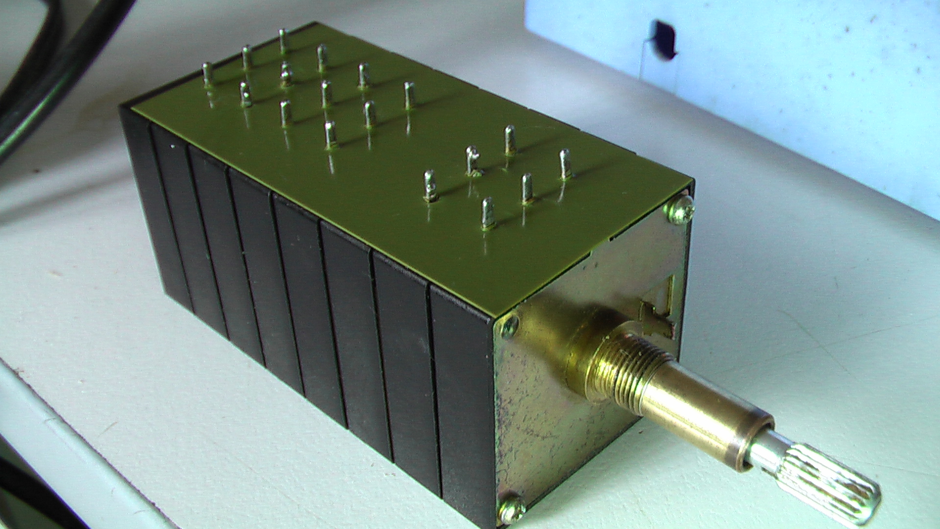

I bought a Yamaha CA-2010 integrated amplifier from 1977 with a balance control which doesn't work. Opening the device, the problem is immediately apparent: a technician has disabled balance control. See picture.
Why would such a thing be necessary? I am asking here before I restore it to stock condition.

First thought is that the balance control has become faulty (actually a common issue) and that obtaining a replacement of the correct type wasn't possible. I think some of these balance pots are a dual gang log/anti log type. So not a common stock part.

This is a genuine balance control (half of the rotation is just a shorting contact, for each side)
and not just a dual pot, so all that the jumpers do is bridge a contact when the control is centered.
If the control is noisy after removing the jumpers, try DeoxiT spray cleaner before replacing the control.

Blance/volume pot is an integrated unit in the CA-2010. Mine failed, I was able to strip it down, clean, still didn't work, needed to insert a shim to improve wiper contact. Some people are not so lucky. Most people run with balance centered so don't "need" that feature...
Indeed, the technician had unsoldered and resoldered the pot onto the board. Sometime in the past, the pot must have developed a fault. The jumpers were put in to solve a problem of some sort. I think I'll leave them as they are.
I did the same thing in 1982 when my 2 yr old Fisher SS amp had a faulty balance control. They were a poorly made item and I didn't need it in the circuit, so I just bypassed it. I bet the one in your amp is the same. Don't need it? Leave the bypass as is.

mbz already mentioned it, it's very hard to get a replacement of the potentiometer unit, I've seen one sold for more than for the whole amplifier.
Besides the obvious reasons of faulty pots, there are other reasons. The amplifiers coaxial balance wheel behind the volume knob isn't available anymore. The switch tips and potentiometer knobs were used on other models of the series and even for later models but the coax ring dial was only used by the models CA 710 - 2010 and are much more rare than you'd think. That means, the only way to get a replacement would be to get it from another amp or to build one yourself. So if your amp is missing that wheel then that's very likely the reason, to save a bundle.

You call 44 years early? May I remind you that this is not a single or stereo potentiometer but a 6x pot? If you multiply the rate of failure that's an extraordinaire long life! These amps usually get faulty at the Mercury relay, the often used switches or contact problems of the connectors of the wiring or the wires itself.

I think one of the "channels" of this multi-channel pot may be beyond repair, so the channel for the balance was used instead, since it was judged to be the least essential.
That doesn't work because the balance potentiometers are linear instead of logarithmic for the others.
