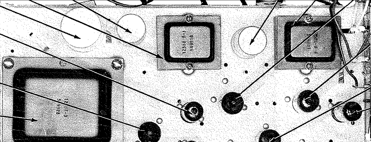

So I'm thinking for my next tube amp build I would really like to do a little integrated 6AQ5 push-pull, so I was researching some of the greats, and apparently the Voice of Music 1404 integrated amplifier (581 console) really stands out as a super performer based upon many comments I have read.
I have a one page schematic, as well as a pdf copy of the SAMs posted below for the model 581 console, which used essentially the same chassis. It very clearly shows that the left and right output transformers are different- one has a primary impedance of 5700 ohms, the other is 7000 ohms. This is confirmed in the schematic, which indicates a different DCR for each primary (325 vs 340 ohms per side). These are not two "alternates" or an accident, this is a deliberate design choice to use a different load line (but same operating point) for left versus right.
Does anyone know why this would be done? I have never seen that before.

If you pull up the Sam's, it shows a picture of the console- speakers are two identical stand-alone columns, speakers/crossovers are identical as far as the schematic. It's a stereo unit, with a balance and ganged tone controls. The more I think about it, I bet this is an error in the schematics. Maybe they got cute and were trying to show alternate versions. I'll email the guy at the Voice of Music Enthusiast's website and maybe he can confirm. Just thought maybe it was some fancy gimmick for some reason.
Yes, can't think of any technical reason to have two different OT's in one amp.

If you zoom in on the "Chassis Top View" on page 2 of the pdf-file you can see that the type numbers written on the output transformers differ from each other (one ends with "A-1", the other ends with "B-1"). So, they very likely do differ by design.

I think they are talking about "alternative parts". Look at the sign in the schematic on top of the OPT, and the note "see parts list for an alternate value and application". Then the part list for OPT describe them as "alternatives".

Yes, but if you look carefully at the OPT box in the parts list (that I posted an image of in the first post) The alternative for 12588-A-1 is 12588-A, and the alternative for 12588-B-1 is 12588-B. The part numbers are different. A's are for channel A at 5700 Ohm. B's are for channel B at 7000 Ohm, and the illustration on the .pdf shows one A, one B, photos from real life of these amps show one A, one B (whether A and B or A-1 and B-1). Nowhere does it say you can replace an A with a B or A-1 with a B-1.I think they are talking about "alternative parts". Look at the sign in the schematic on top of the OPT, and the note "see parts list for an alternate value and application". Then the part list for OPT describe them as "alternatives".
I'd say that the ''part number'' printed on the part photo is a graphic number and not the original top photo that might be seen on an OEM service literature and so is Sam's way of showing possible parts a service person might find back in 1960. You are building from scratch, right? Pick the closest OPT you can get for the load line you want.
Interesting example, though. Sam's could have put a small notice box saying that the photo included alternate parts depicted. The other error is a simple missing decimal point, yes? Typical type of Sam's error.

Sams picture appears to be a photo to me. Also, I have seen photos of an actual amplifier and they are indeed labelled exactly as this - A on one side, and B on the other. Schematic also lists different DCR for channel A vs B.
