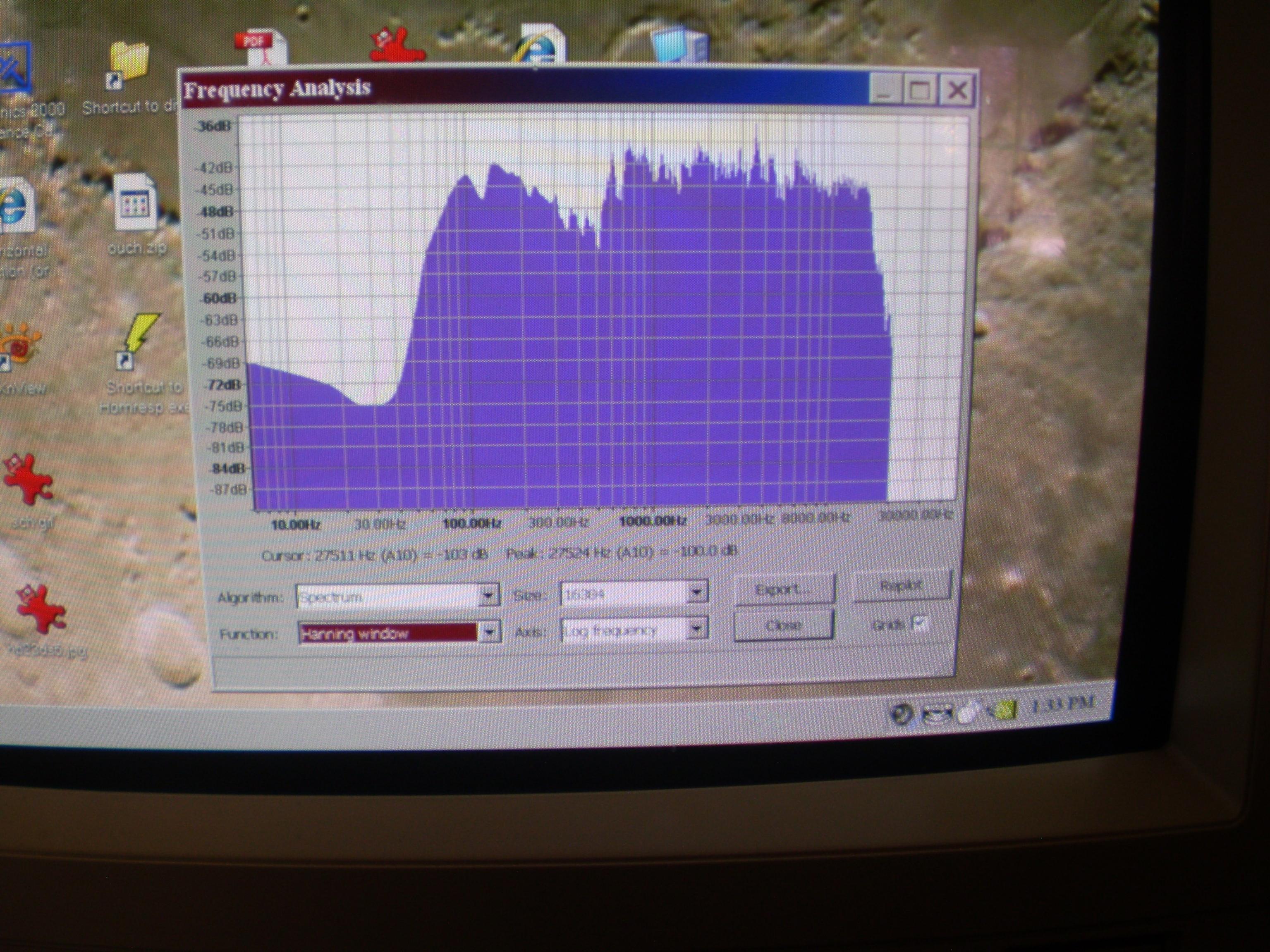

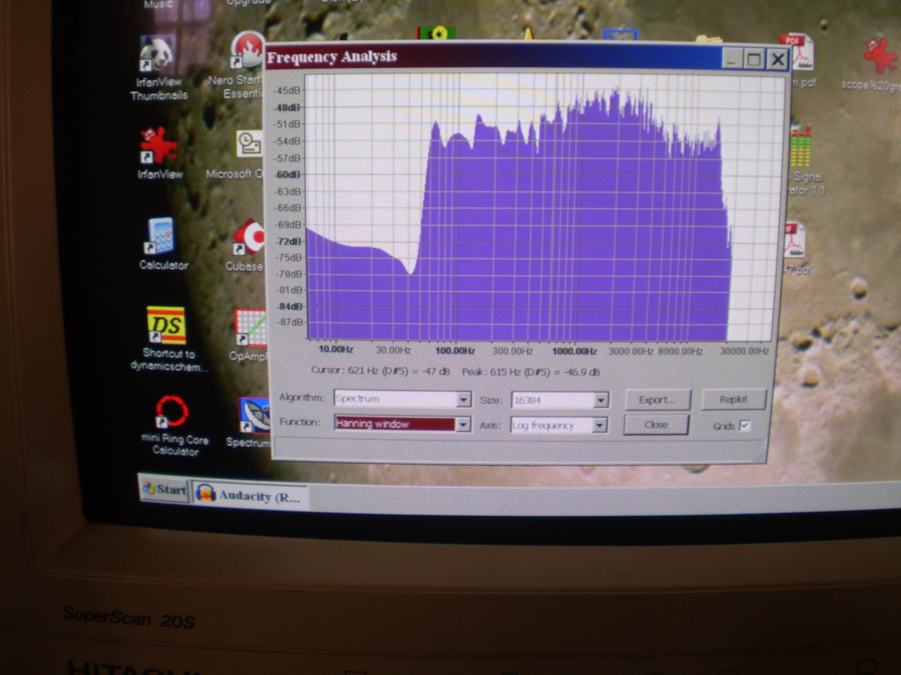

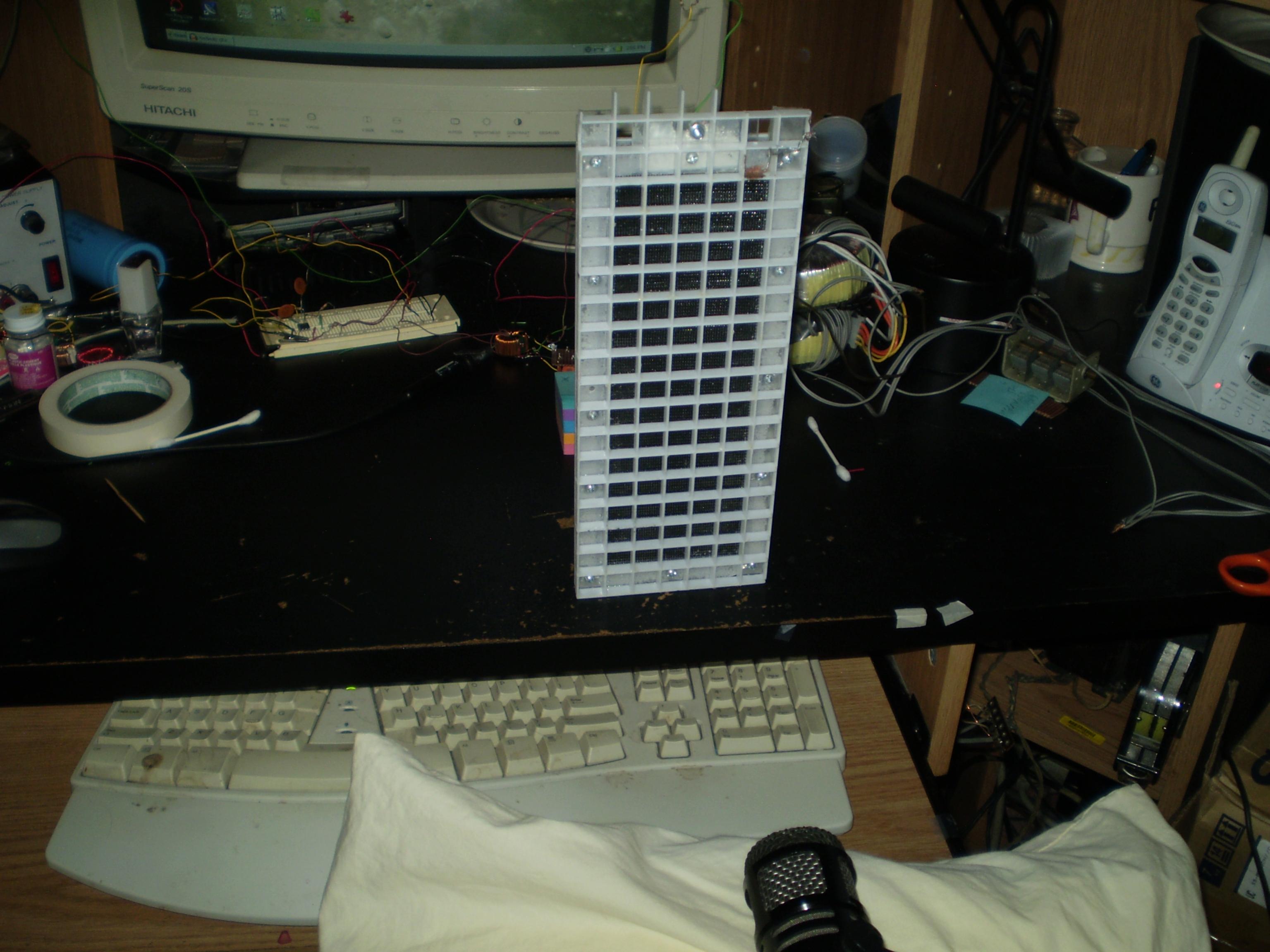

Even my smallest panel produces low frequency's nearly flat to 40hz.
Although fuzzy and hard to read this a pink noise test at 1 meter at 6 watts input.
The first set of bold numbers on the bottom of the chart from the left marks 10hz.
The test was done with no eq and the dips in the graph are room reflections.
I am running 6kv of bais on this panel and have measured the diagphram clipping (slaping against the stators) and have not experienced any arc or burned holes in the diagphram with this panel ,with a d/s spacing of .065".

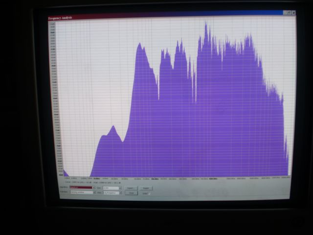

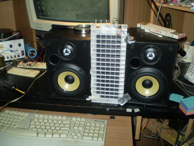

the second set of pics was done the same way except that it was a nearfield measurement.
And as you can see I'm not using some cheezy $2 condenser microphone from radio shack. jer

I agree with you on your points as I am trying to figure out where the confusion has started.
The test that I have just posted were done with a transformer.
I'm sure we need not have to get into transformer theory as to how to get to 20 hz.
Sure esl's can get down to 20hz but it is not going to be a chest pounding 20hz by any means. jer
