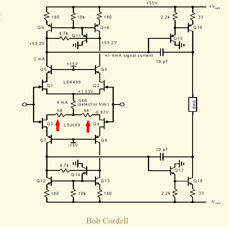

4) The N and P types are good complements in symmetric circuits
IMO so-so at best. The beta parameters are quite different which is all that matters.

Bob Cordell's upgraded Hafler, which he presented two Burning Amps ago, gets around this by using different amounts of degeneration for N and P. Picture below.IMO so-so at best. The beta parameters are quite different which is all that matters.
_
