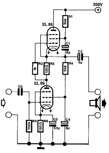

Another quirk of the European numbering system is that the PL84 is a 15V filament version of the EL86 NOT the EL84.
John
There are a few of those around which should matter to those people insisting on using NOS tubes on the cheap.
So you'd better have a good databook handy before blindly ordering ordering tubes.

Noooooooooo!
Quote: "Another quirk of the European numbering system is that the PL84 is a 15V filament version of the EL86 NOT the EL84."
Noooooo!
I've already bought many of them (around 20), cos I thought that they are similar to EL84....:bigeyes: :dead::bawling:
They are new Telefunkens with <> on the bottom, and they were really cheap (was around USD $1 each).
Doesn't matter..... I was planning to build an OTL amp with EL86 anyway...
How about UL84? Are they also similar to EL86 rather than El84?
And PF86 to EF86?
Quote: "Just keep in mind that amp was intenden to be used with 800 Ohm speakers."
Yep. I know that already....
And that's the biggest problem that I have to face to use this amp:xeye:
This might be a really silly question, but do you think it's ok to place a hi-ohm resistor (about 800) in the opt to match the impedance?
I mean like this: an 8 ohm speaker + a 800 ohm resistor = a bit higher than 800 ohm, which makes it sound more linear.
I know that this might be very inefficient, but I really think it's better than getting a transformer, which spoils the frequency response unless using tamura trannies.
( You guys know that Tamuras are expensive:bigeyes: )
PS: I saw someone in this forum, who tried this amp with an 8 ohm speaker ( 8 ohm to 800ohm!).
But he had an amazingly good result.
