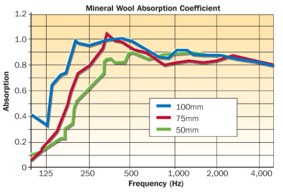

As to reducing reflections from the back-wall, it's easier to do a 3" thick pad of rockwool on the wall near the loudspeaker (assuming it's placed close).

Except it requires about a quarter of a wavelength depth to effectively absorb and the first cancellation dip occurs at...It's MUCH cheaper to do the absorptive panel on-wall than trying to integrate it into the loudspeaker design.

Practical thicknesses of rockwool on the wall will have decreasing effectiveness as frequency decreases. Below a few hundred Hz, it may as well not be there.
