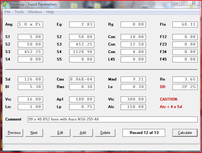

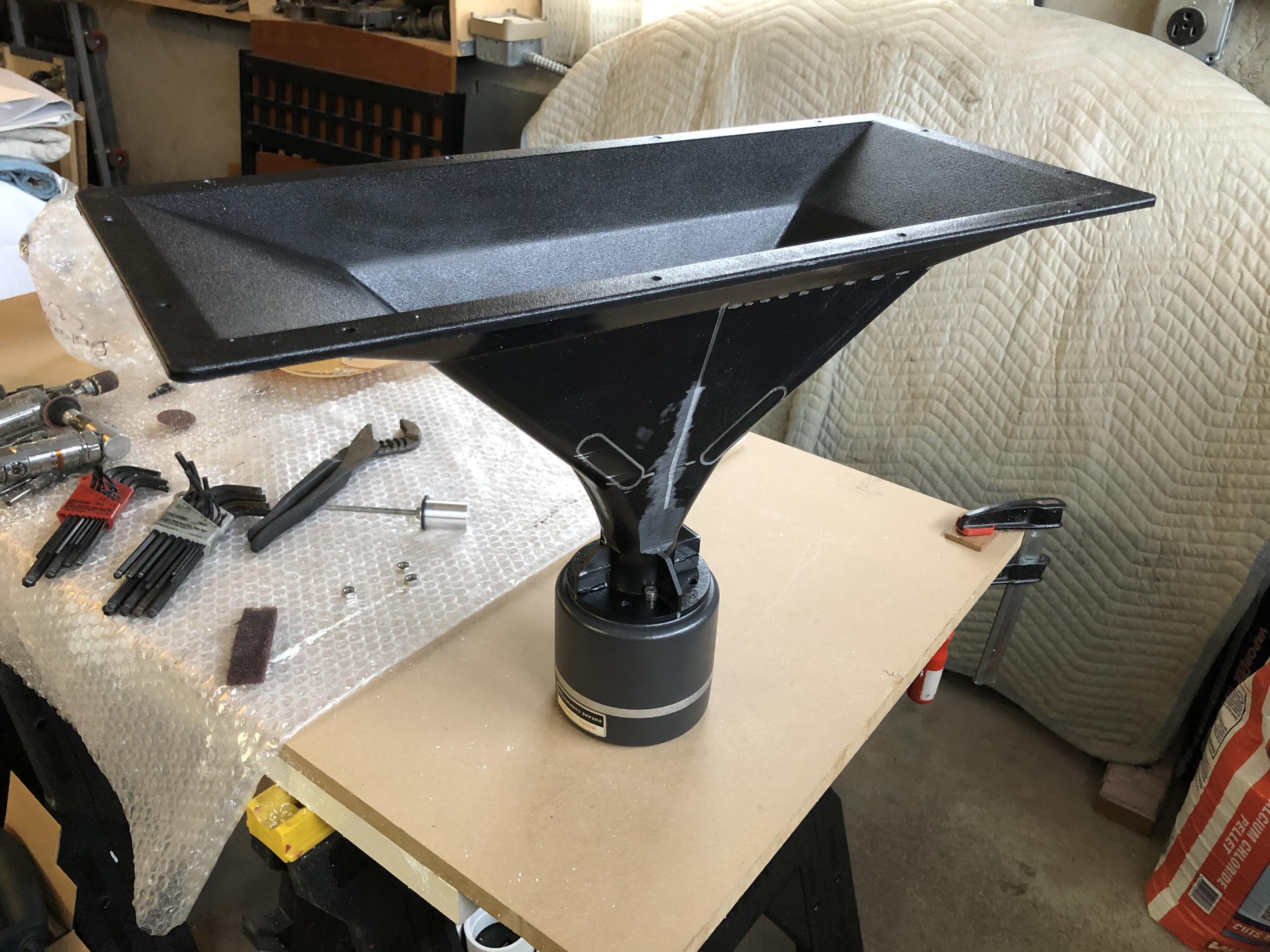

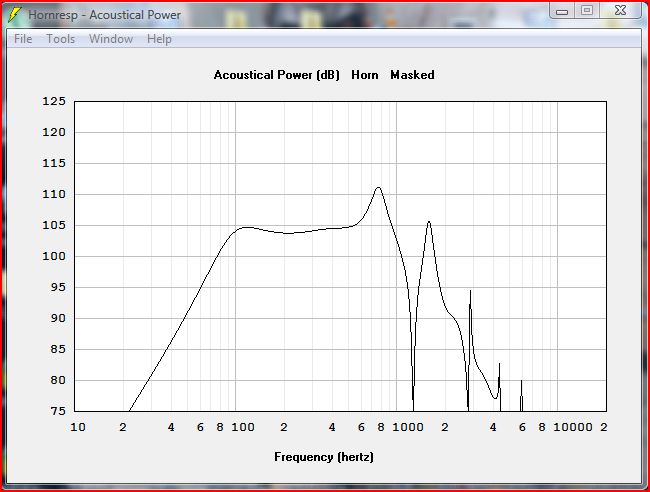

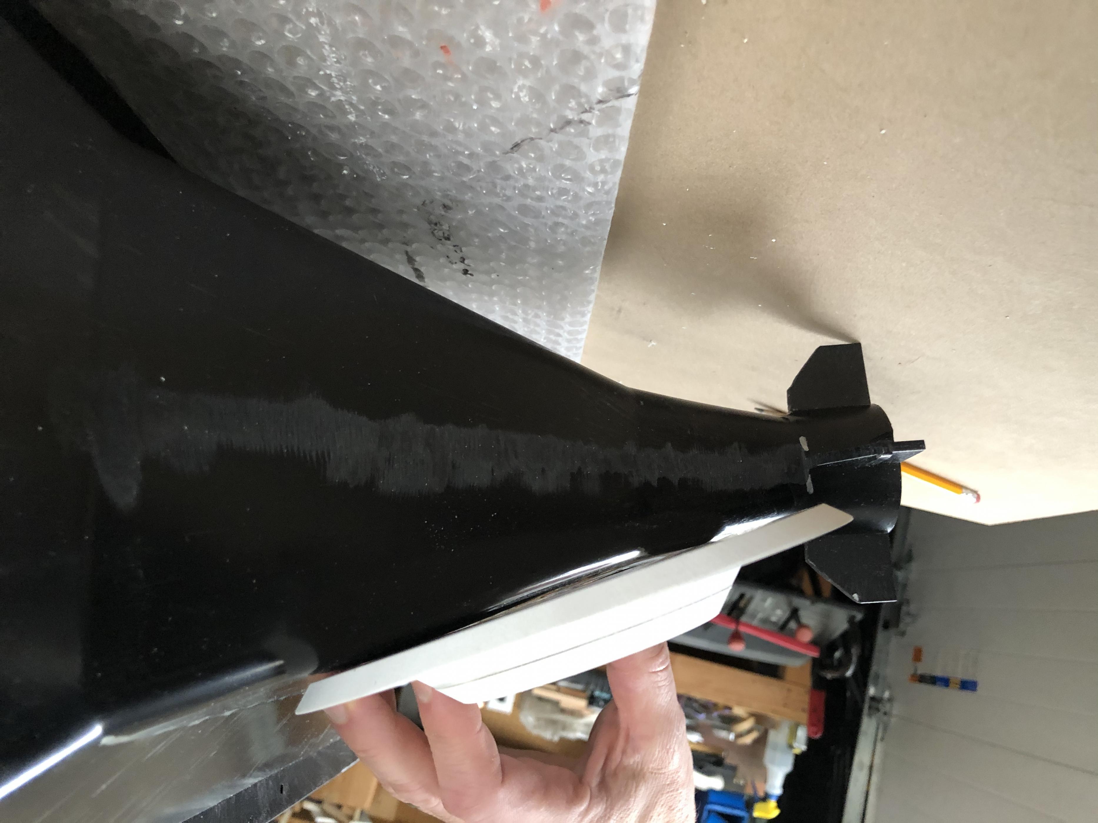

Hi Patrick
I recently tried jumping in the Unity/Synergy/MEH pool after spending a lot of time reading Syntripp, Cosyne and other threads where you Bill Waslo, Weltersys and xrk971 were all contributing (amoung others).
I’d like to know if I’m wasting my time with what I’m trying to work with and my obviously limited understanding.
I really wanted to try and maintain a point source with good sensitivity that would give me better directivity (less beaming) than the 8 inch fullrange drivers I was using in Oris front horns.
I discovered I was tired of their very small “headphone” sweet spot when I started playing with OB after my Oris got knocked over and damaged.
I thought I would pursue Bill’s Cosynene because it seemed the best documented.
The CD and Gento drivers were easy to get. I was going to try and go active so I could use the the 4 Ohm version of the Aura woofers that were still available.

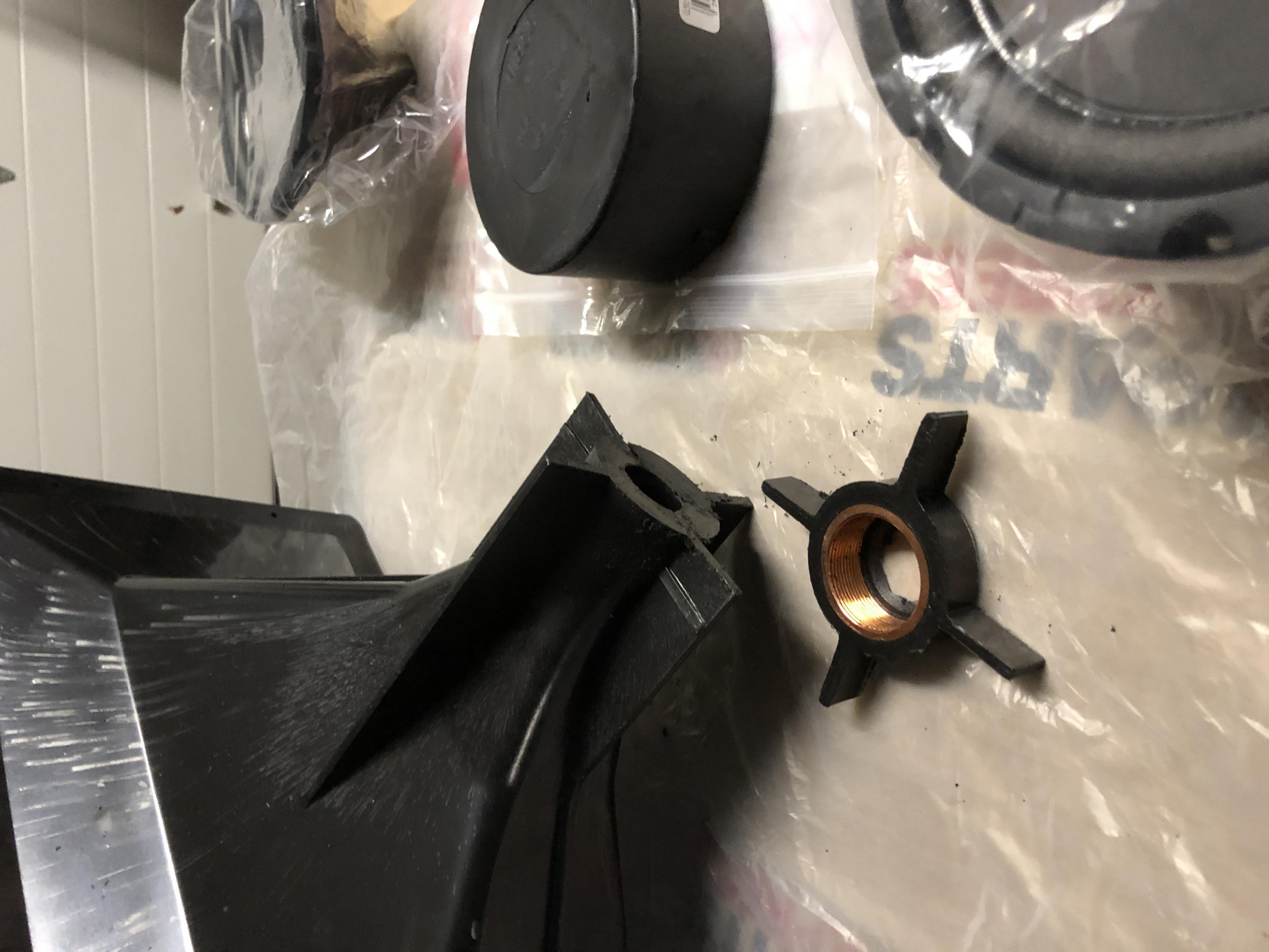

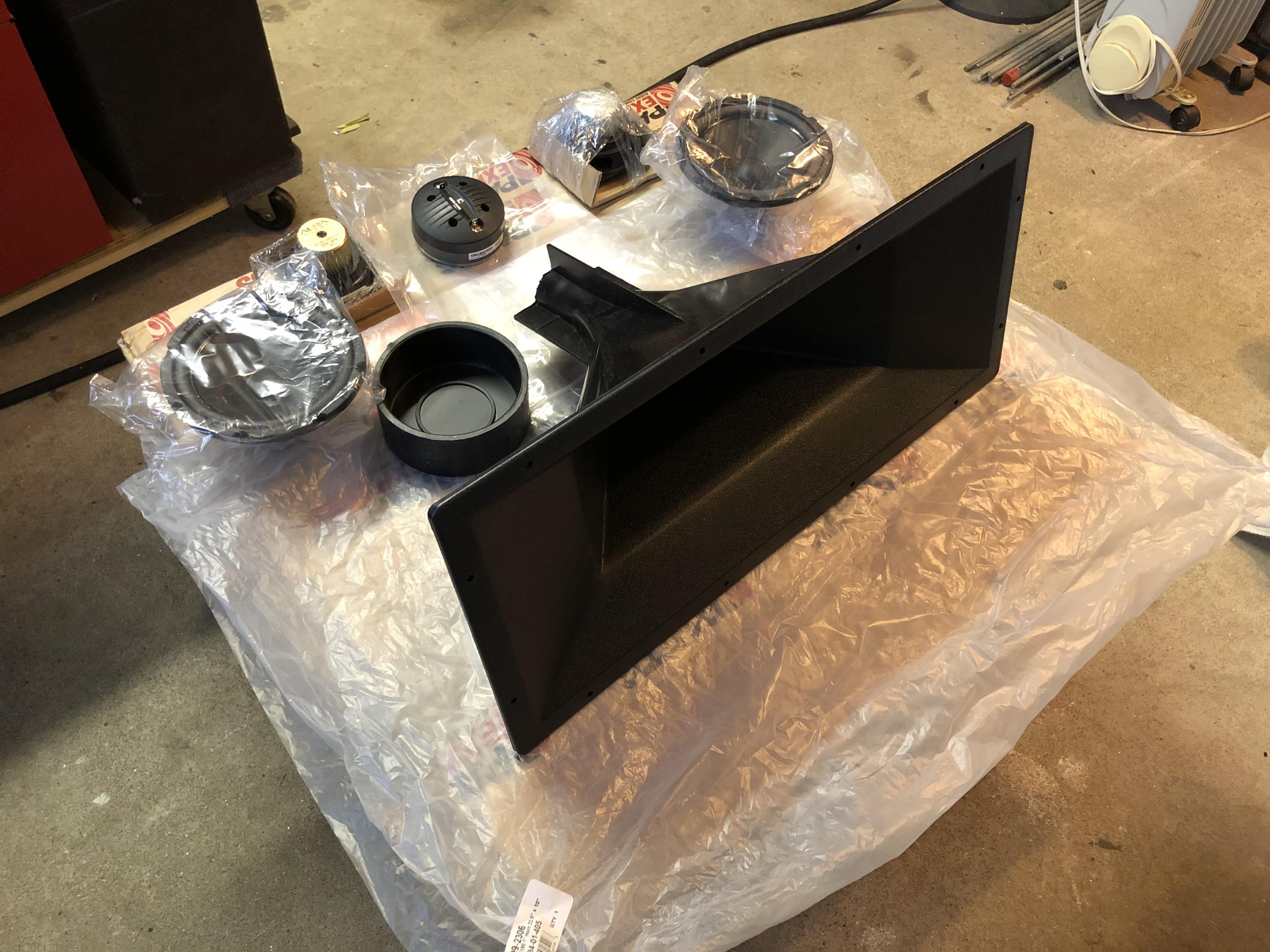

Then I discovered some fairly big B52 (90 X40) conical buyout horns at Parts Express.
TE-8180 1" Horn 22.5" x 10" 1-3/8"-18 TPI
I thought the 90 degree horizontal dispersion would work better to broaden the sound stage and that I could make my life easier with them by modifying them (rather than building from scratch) like some other projects (Small Syns).

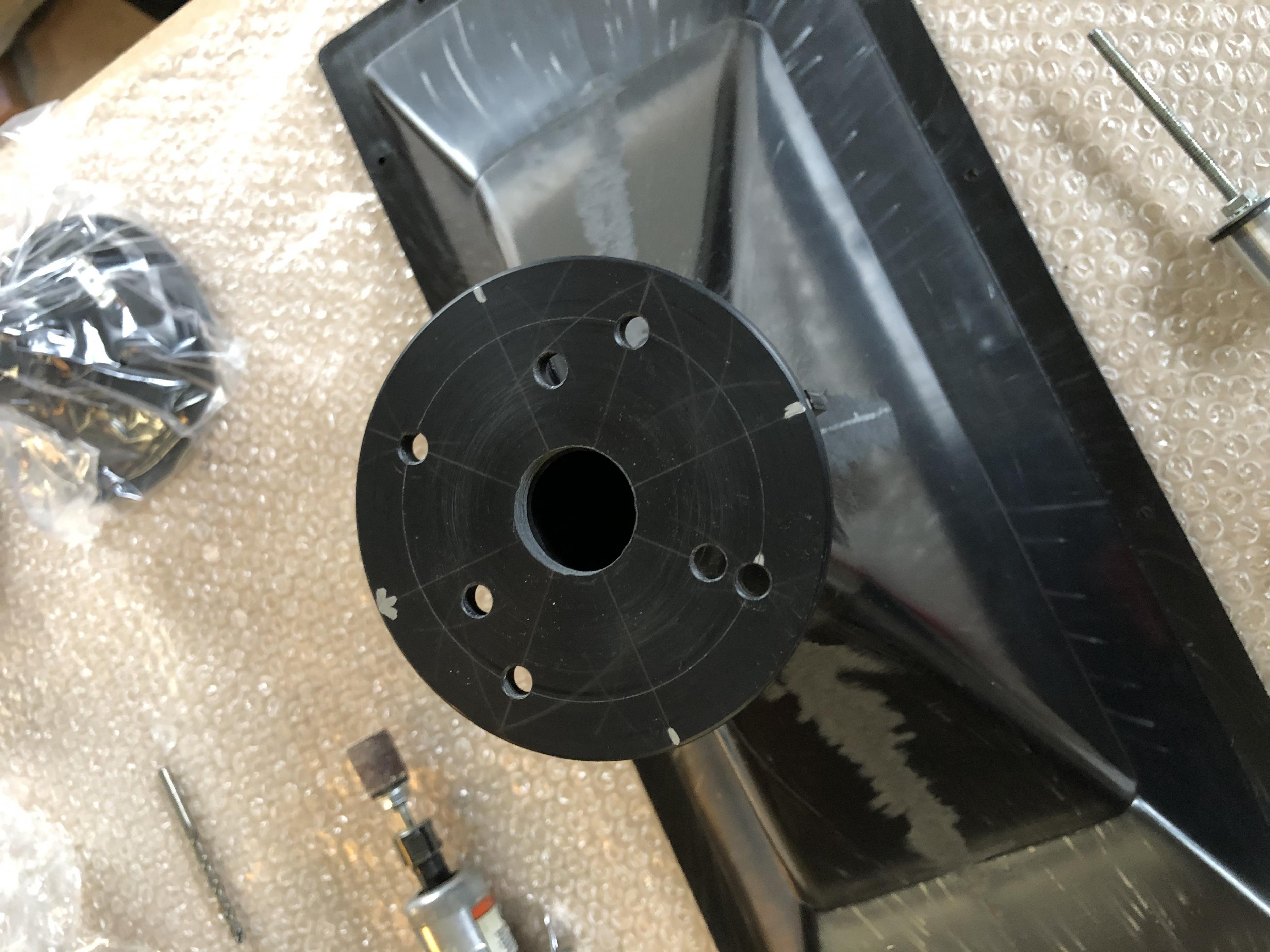

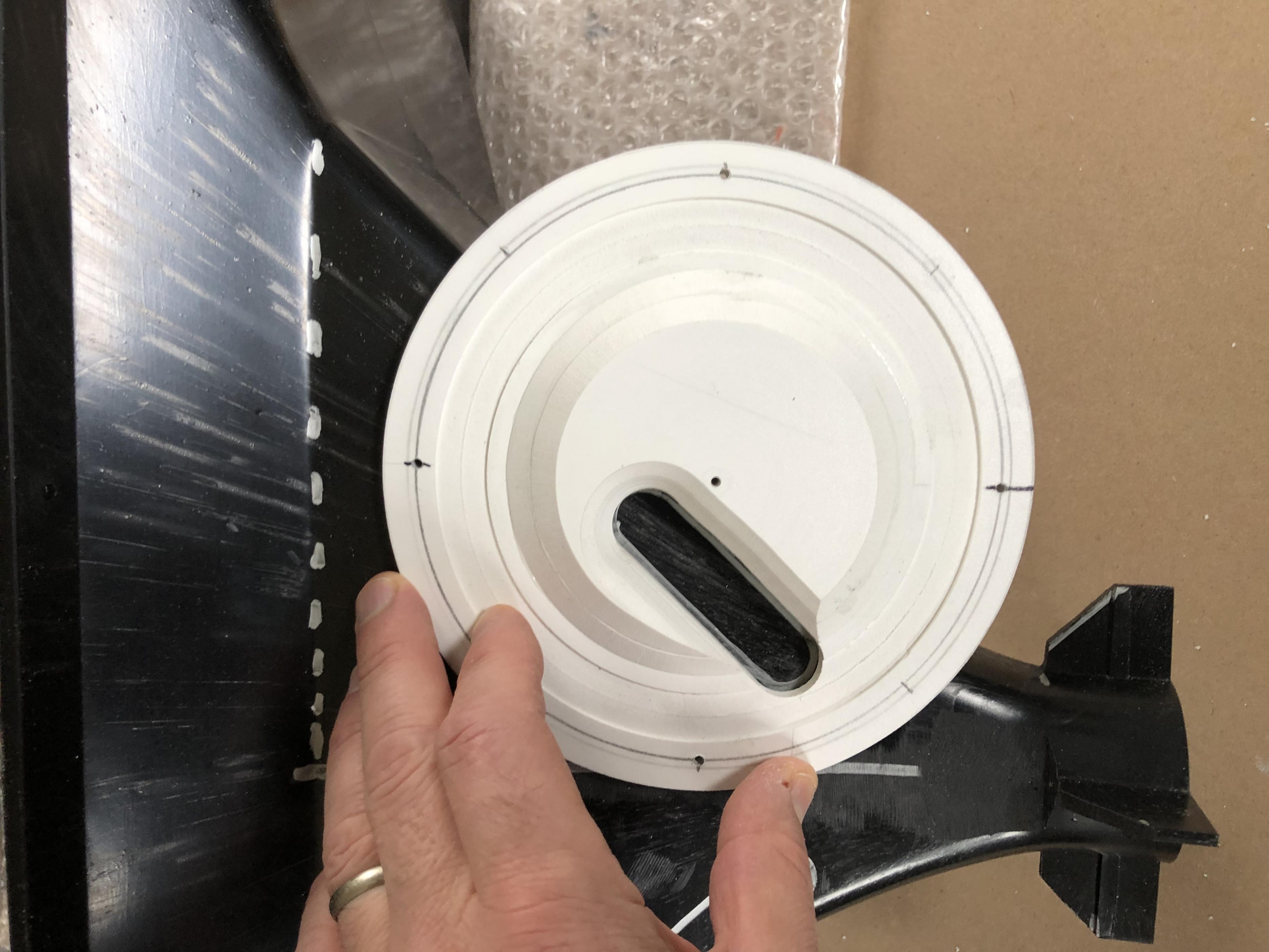

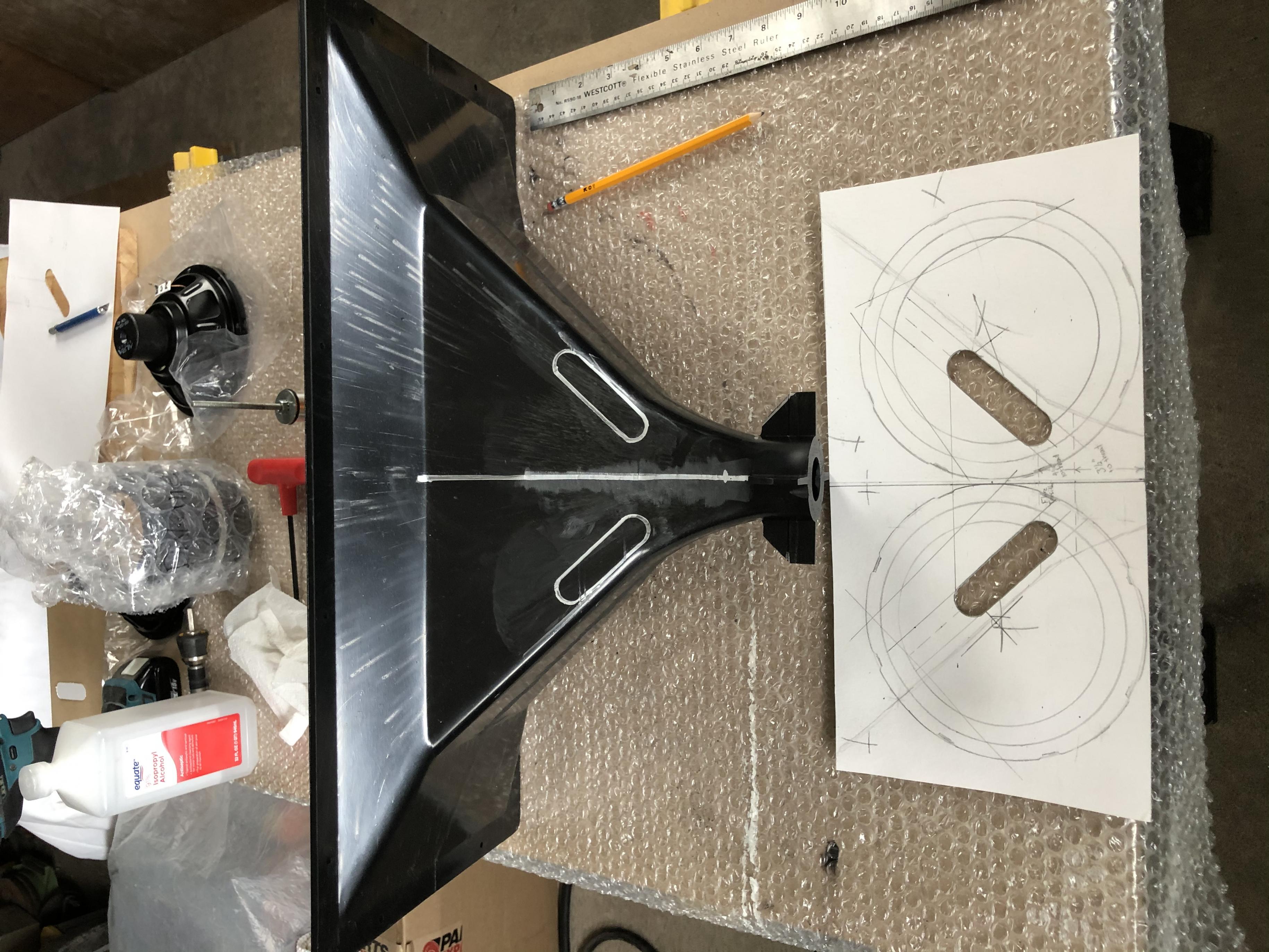

I’m pretty much at a stand still after having modified one horn to bolt up the Celestion and a Dukane 5A540 I had.
There doesn’t seem to be enough room for the Gentos and the Aura woofers.
I thought maybe I could go 2 way with just the Aura and the Dukane CD which can go down to 500Hz and cross probably around 800Hz (I was hoping).

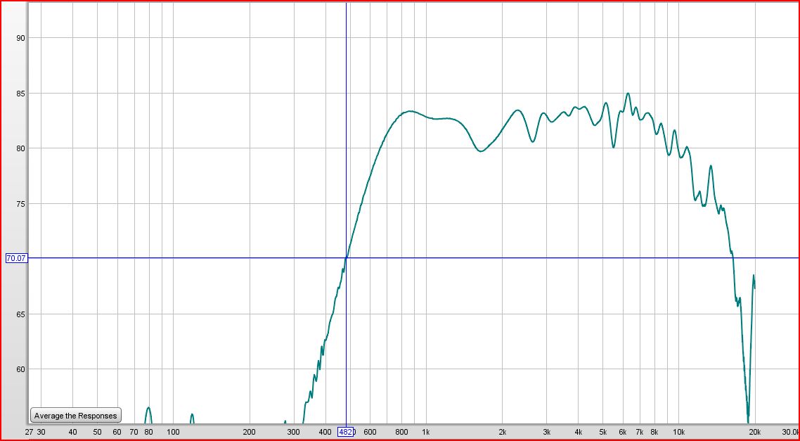

I tried some reverse engineering by taking physical measurements of the B52 horns and inputting them into hornresp.
My modeling in hornresp with the Auras shows a big spike right before they crash just short of 1KHz. The only way I can get decent response down near 200Hz is to model them in a larger vented back chamber.
I specified a very short back chamber, as Bill did with the Cosynene, to negate back chamber reflections in the model.
I actually have some other Aura NS35 I also tried modeling...they give me pretty much the same results.
I have some B&C 8pe21 I modeled which look better, but they’re too big to mount on these horns.
I was using the same woofer port size for the Auras that Bill recommended in his Cosynene article.
I don’t think I can get the woofer ports in the same location (in relation to the throat) that Bill had on this smaller horn. They would have to be about an 3/4 -1” further away if I want to bond my PVC driver mounts on the flat part of the second expansion.
I made some fillers to reduce volume under the woofer cone with the hope of extending or pushing the upper frequency response spike further up.
I also mounted up the Dukane to the modified horn without the woofer ports and measured it in my living room with REW to see what it would do. I could only center it floor to ceiling, set the mic a meter away and use a gated measurement.
I get the feeling I’m trying to put a square peg in a round hole.
