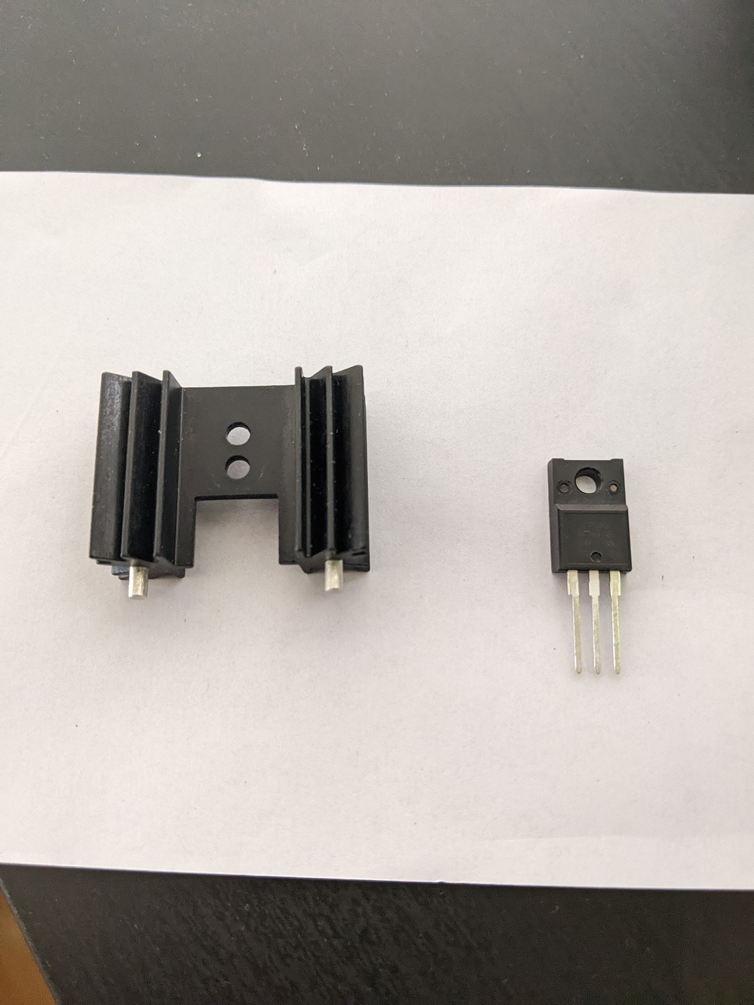

At first blush I would have thought that a heatsink would be configured to mate intimately with the heat-generating component for maximum heat transfer.
Yet, many of these heatsinks have a cutout just where you'd figure there should be more contact with the body of the unit... below the tab.
What's the thinking?
Sorry, I did mean to
Again, it seems to me that the full body length of the device should be against the heatsink.
I suspect these particular heat sinks are meant for a lesser used package (neither TO-220 nor TO-247) that has a thin metal tab extending out of the middle of the part. I cannot remember the number of it though.
Those heatsinks are tiny and handle a few watts at most, so their thermal impedance to the die isn't very crucial.
