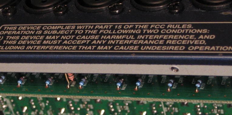

Its a Yamaha MG16/6FX There are only 10 phantom powered channels. I can see the 61K(?) 2% resistors that feed them. I wish I could get a circuit diagram, but its too new. This thing was designed to be built by the 1000s, not repaired. As a Production Engineer myself I'd say the design for manufacture was right on - its a beauty.
I'm tempted to throw a 1000Uf cap between 48V and the chassis. What do you think?

COnnect your meter to ground and then probe pin 2 or 3 of one of hte channels. Measure the phantom, then flip the meter to AC and measure the ripple on it. If there is a ton of ripple, try filtering, but I suspect the cap is un needed.

Your desk has a problem. the snake is just showing it up. it is unlikely to be anything resonant. look for the following problems.
Poor or no connection on one or more pins of the channel XLRs
poor connections it the bus wires on the channel, common on older yammies unplug & replug the channel bus connectors if it has same.
Test your pin 1 earth continuity with a metre.
Check the phantom voltages are the same on pin 2 & 3 re pin 1 on each
in short look at the desk not the snake.
