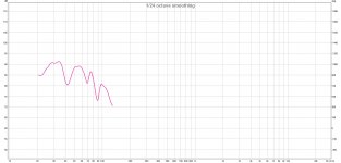

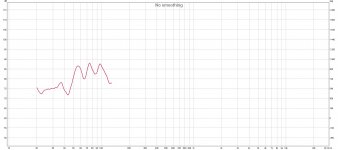

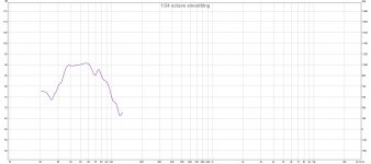

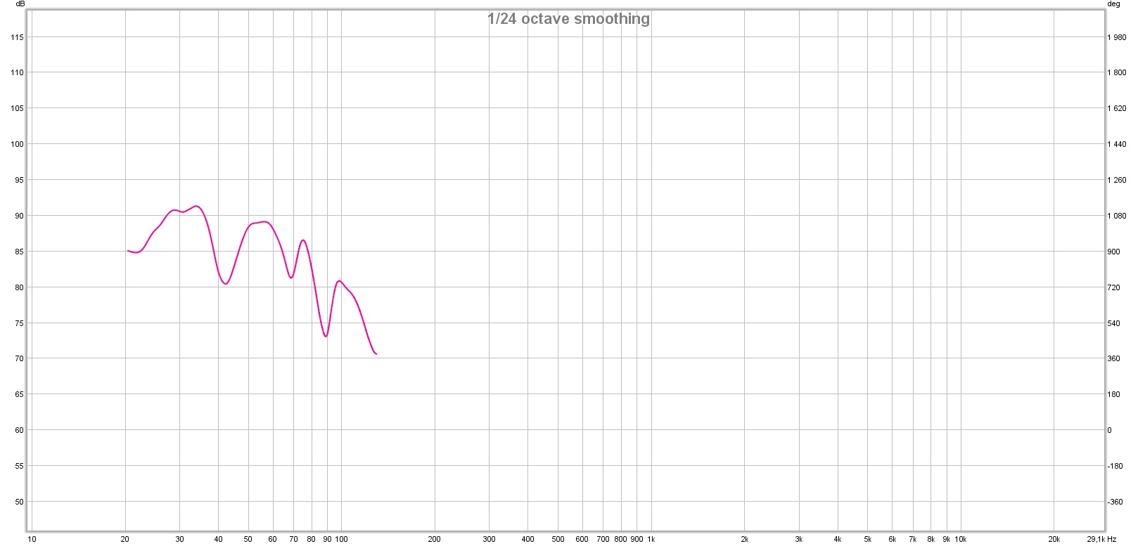

Why I'm seeing a null with two subs?
Why am I getting a null when I'm running two subs?

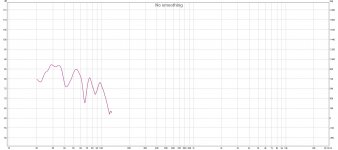

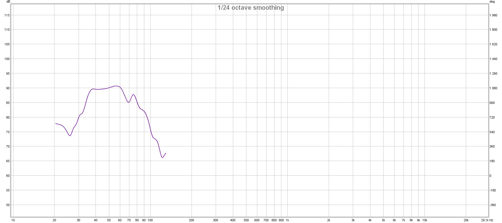

Here's how they measure separately.
attachment.php

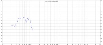

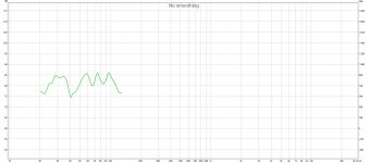

And second:
attachment.php

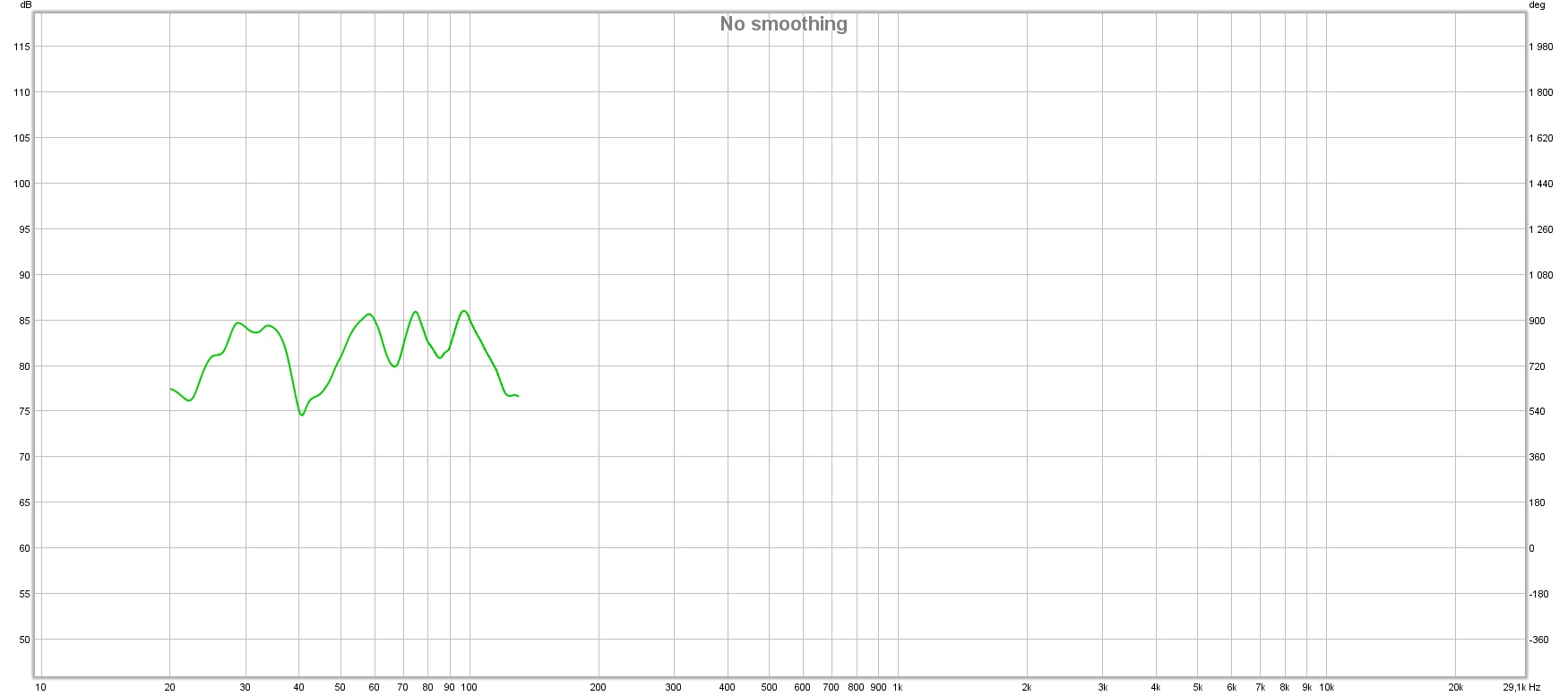

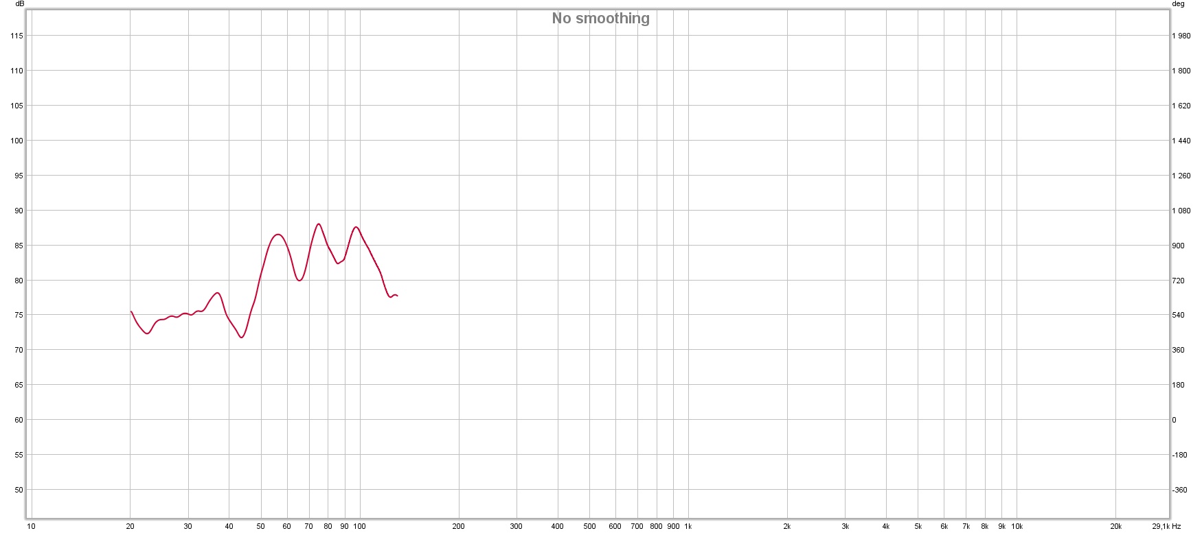

When I run them together, this is what I'm getting:
attachment.php
So what's happening? The bass between 25-35 Hz is gone.

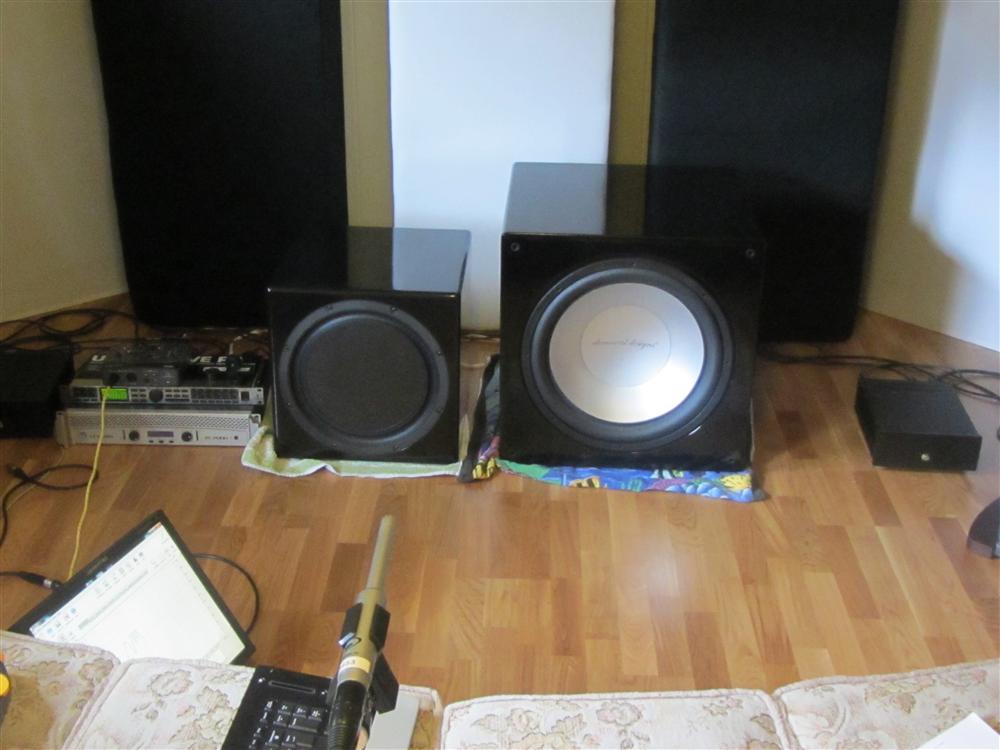

I've placed them both in the middle of the width of the room.
attachment.php

Unless you are outside over 30 feet in the air, you will have nulls. Physics.
Two or more sub lets you distribute nulls around so maybe, with effort, you won't have too many really deep ones.
Now, how to get rid of them? Bass traps. Real ones, not little foam wedges. Next tip: don't get too carried away with measurements. Listen. You don't hear LF issues like you do higher ones.
It is a whole octave wide. An odd room and/or mic effect. Worse things sometimes show up in testing. What kind of test signal?
Just find a good set of locations for the two subs and you are good to go. I am a big believer in heterogeneous locations (say corner and mid-wall) to blend the various factors of the room and speakers (like thinking statistically about sound rather than thinking determinatively).
Ben

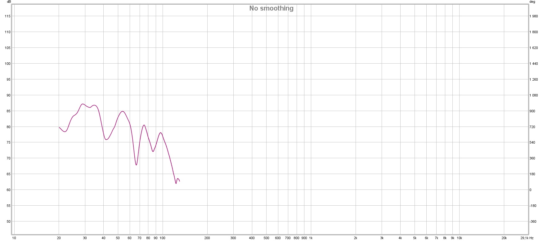

This looks more like phase canclation. I don't think bass traps will solve this problem. Looks like one is out of phase. Try messing with that and add another sub for better smoothing. When that is fixed, then you can go back and measure decay time, then fix that with good traps.
Tell us more about those two subs, e.g. are they sealed, or vented?
The small one is an 12" Geddes bandpass sub. The other one is an 18" sealed eD sub.

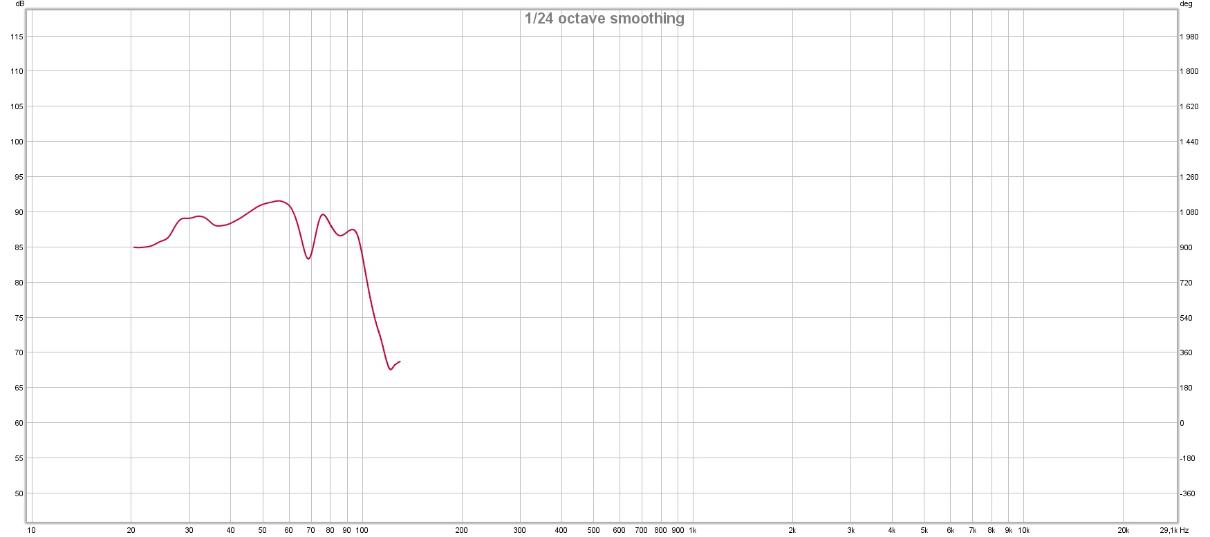

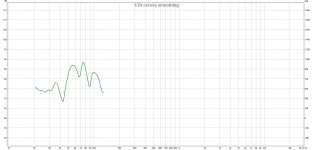

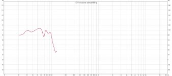

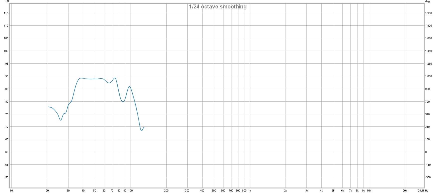

Ok. I changed the phase from 0 to 180 on the eD sub. Here's how they measured simultaneously with the phase first at 0 (as before):
attachment.php

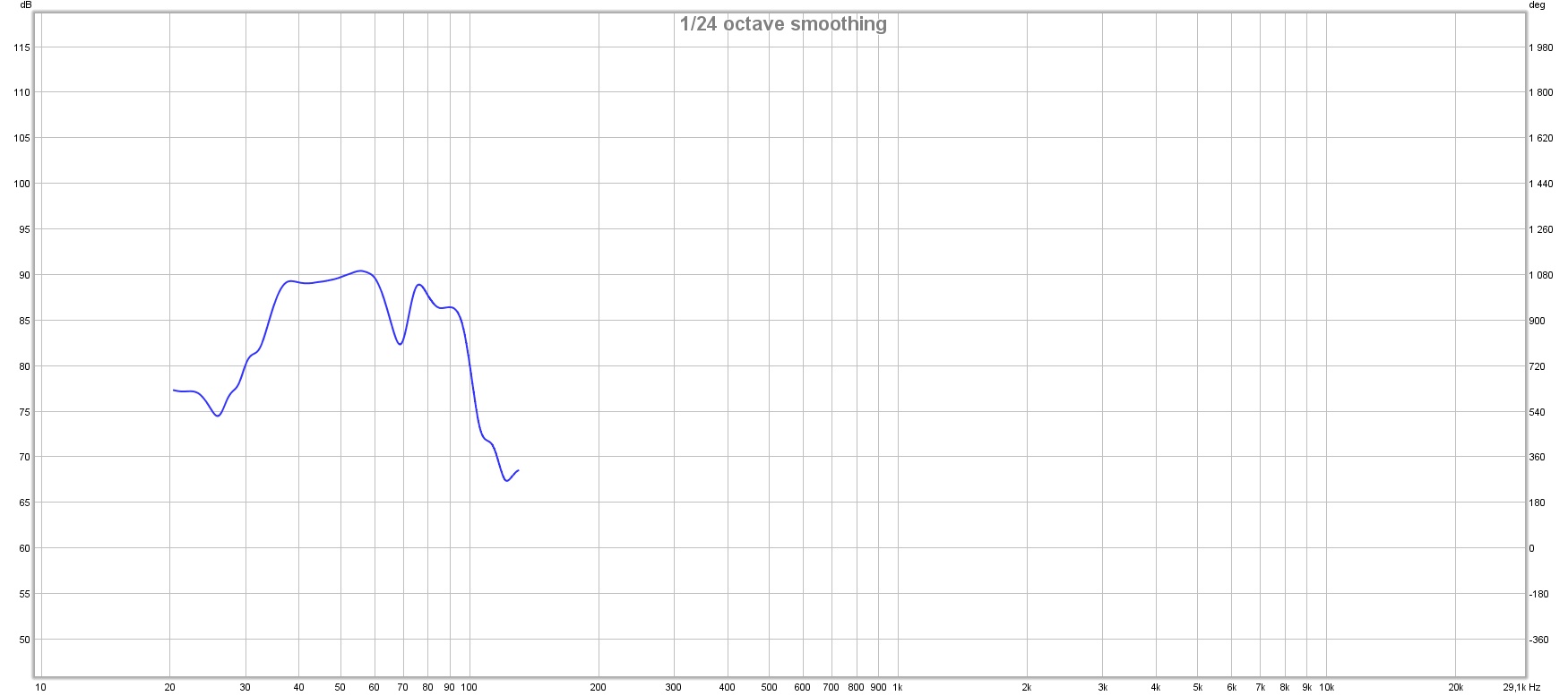

Then changed the sealed eD sub to 180:
attachment.php
So that seems to have sort it out. Measuring the big eD sub alone with 0 phase it measured fine, but as soon as I ran i together with the bandpass sub I got a null. There's less bass now at 90-100 Hz compared to the green graph (bandbass sub) in first post, but that's due to moving the sub some and more basstrapping behind the sub. Yeah I know, it's strange, the cancellation is actually stronger with more thick porous absorption right behind the sub. 40-55 cm of quite low density rockwool now on most of the front wall. I moving towards pressure based traps........
My question now is; Is this enough or do I need to further work on phase allignment? I have Behringer DCX2496 which I believe can dial in phase more precisely. How do one phase allign with both other subs and with the fronts?

With the reversed phase, that rising low bass curve is about as nice as anyone could ask for in real rooms. It will likely sound flat and wonderful. Once you check out heterogeneous room locations for the two subs, you might get those other bumps to behave better.

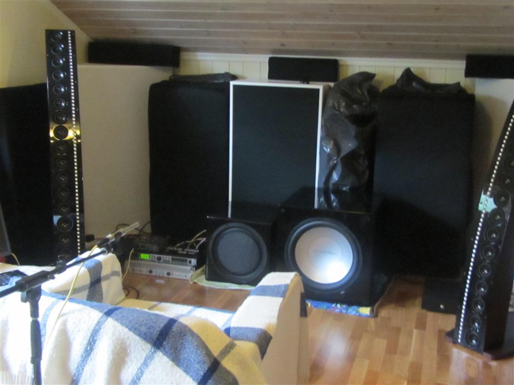

I've borrowed these subs from my hometheater as a temporary solution. The plan is to get someone build me two towers of something called hybrid dipole. Basically means one can change the dispersion as different frequencies. Dipole, cardiode, bass-reflex and sealed can work at different frequencies. This may help me level out the response some besides better treatment and placement.
I'm measung with a calibrated Dayton mic and using REW software. I don't check the level everytime but it's around 80-85 dB.
The mic is at ear height and faced towards the speakers as the picture shows.

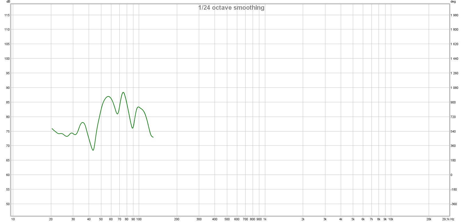

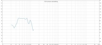

Moved the small sub to the back of the room. Getting some nice responses here. All are measured with one at different loactions. The crossover is set to 80 Hz by the way.
Is it possible to integrate the sub seamingless when it's placed behind the listener?

Time to get the mid-range running. With that last curve, you might have a vile loud bassy quality in the 80-120 region (which why the rising bass earlier might sound better). But that kind of final tuning is best done by ear since these traces mean surprisingly little for fine-tuning.
BTW, it is the consensus around here that a a rising bass is needed to sound right, not some kind of flat-looking textbook curve.
