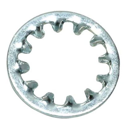

Ok, could be an idea but I have never seen a pcb mounted with toothed washers... BTW: taggbricka in swedish 🙂
Star washer in UK.

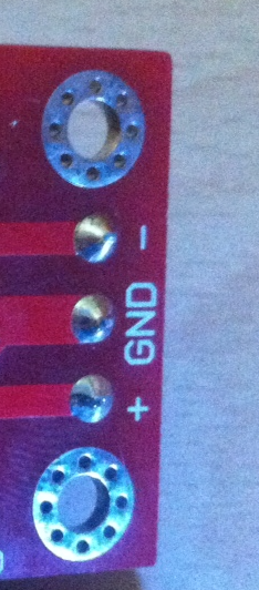

The solder on the via hole spreads the load from the screw head. Imperfections in the screw head can sometimes crack the board if it is not protected.
Makes a good earth bond as it keeps the tension under compression of the conductors. Otherwise known as a 'shakeproof' washer.
If there are any plated through holes needed, it is cheaper to make them all plated, it saves a processing step.
