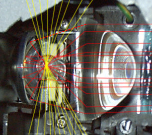

Loss of lumens at the beginning
Here is a good example (attached file) what I am talking about the loss of lumens with the optics of the light source. I am not sure that how much the case is similar with OHP's and such, but this is how the stuff was done with the diaprojector where I ripped the stuff for my semidiy-LCD-projector. As you can see it is not hard to prove the loss of 35% of the 5000 lumens that the 150w halogen has to offer in this setup. I also got new information (thanks Joseph!) about the very same lamp that was on this LCD-projector of mine originally. It's output is "ridiculous", only 7000 lumens! Here is link to the original lamp's specs http://www.lamptech.co.uk/Spec Sheets/Philips UHP120.htm and image of the actual bulb. As you can see it has a very efficient reflector on it (all around the point where the light is produced) and so I'd assume that easily 85-95% of the 7000 lumens were collected for the projector to use. The original lamp which was on this Sony is physically the same (maybe the reflector's shape is a small bit different, some small optimization to fit absolutely perfectly with the optics of the projector) but the average life was 2000hrs, not 6000hrs like the one on the website. I'll assume that the lamp was driven with maybe a bit stronger voltage to get a bit more brightness (maybe 8000-9000 lumens) and maybe cooled a little less then it is supposed for the 6000hrs life.
So... I'd advice about anyone that reads this to check the reflector and such stuff right next to the lamp. I am personally going to try to get a new reflector to my system to collect more light, altough it might be unnecessary as the loss is "only" 35% so getting a 250w halogen with 10000 lumens should be enough to get the 500 lumens out of the projector in the end. The cooling with a more efficient reflector would be definetly harder and so the lamp life would possibly be shorter.
Regards
HB

Why is the 36% of loss at the optics necessary in my case
Hi!
Some of you may think that "damn that guy is stupid, we all know this stuff already, it has been discussed on many threads before" but anyways...
I today on a bus to home with a new halogen for my projector (just a 150w FCS for a nighttime viewing, I'll get those 250w EVCs when I find a cheap transformer that can take them)... I looked at the lamp and then it came to me... "HEUREKA! IT WOULD NOT BE GOOD ANY OTHER WAY!"
Oh what would'nt be good? Well. The thing that brought me to this realization was the a bit randomly shaped small lump of glass on top of the halogen... and that is on top of about all halogens similar to this one..... so the light could not be even and as bright as it would be coming out of the sides of the lamp... and then I also made note that "Aaaaa...." there can't be a very efficient reflector at the bottom either as the lamp base is there, and the shape of the lamp is not very good at the bottom.
So, we could make a reflector to get more light from the sides of the thing and some from the top. The result would be about 30% brighter image at sides, something like 15-20% at bottom and dim looking upper part of the projected image... that really would look damn stupid. So in this kind of setup as mine it really cant be much better as it already is. 36% loss at the start is the cost for evenly bright image, I'll just have to live with that or make a comletely new setup so that the lamp base is at bottom of a reflector resulting in something like the FXL lamp has built in it already in the factory.
