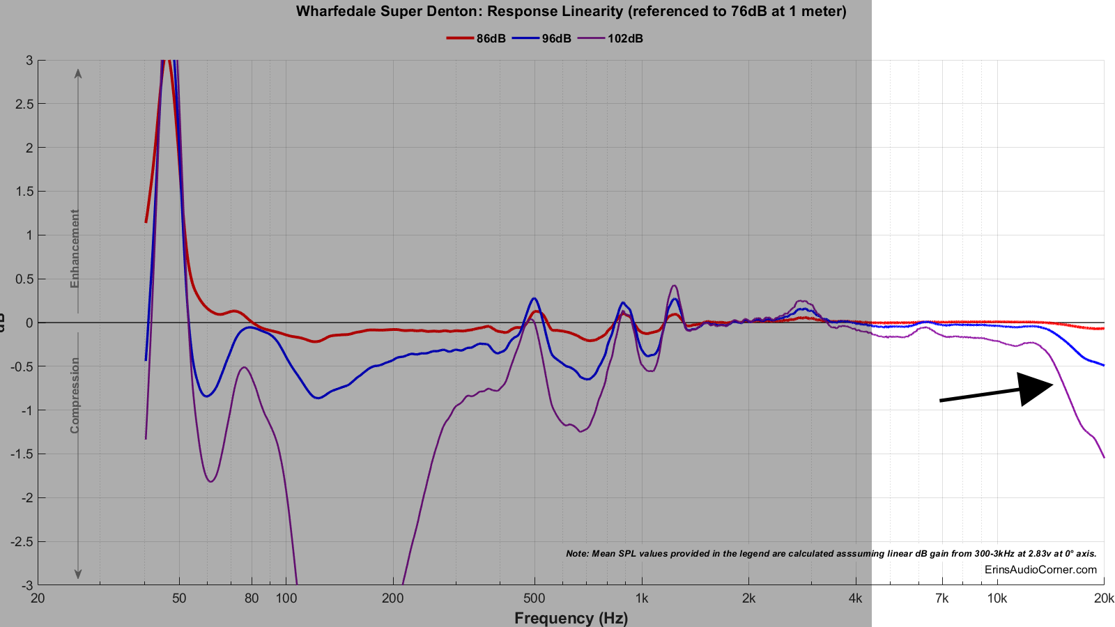

Hmm.. I'm not sure that is what I'm looking at. Here is an example of the compression I mean. The TAD video is not public yet so I'll choose another speaker. Whardfale Super Denton. Now obviously there is lots of different compression going on below ~4KHz (which the TAD has none of), I'm really only curious about the top octave.
The wharfedale super denton has a soft dome. Soft domes operate in a constant break-up behaviour which easily falls apart at higher sound pressure levels.

The TAD has a beryllium dome and shows the same, so really don't think it's related to breakup. Perhaps acceleration as you said.
Depends on the tweeter but normally they can roll off, especially in a waveguide, and the lower band is attenuated. If that's the case it actually "sees" less power mid band than the last octave. So with no attenuation you could see power compression first in the last octave.

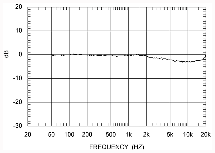

https://www.soundstagenetwork.com/i...&catid=77:loudspeaker-measurements&Itemid=153
Sorry I see only 1.5dB difference in compression between 70 and 95dB which could be expected from this low efficiency design! (86dB 4 Ohm 1meter)

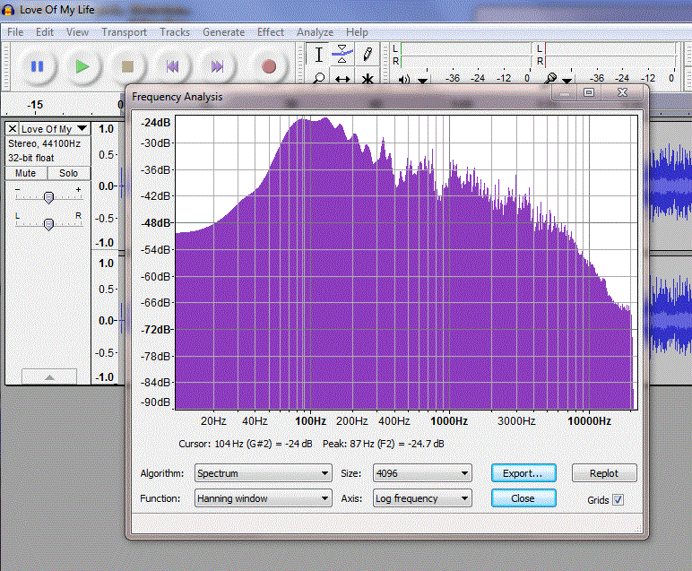

Which Acoustic Music Instruments produce extremely large amplitude harmonics above 10kHz?
Please, can anybody list them?
Well, I guess if the sound system is trying to accurately reproduce the harmonics of acoustical music, and do that for an outdoor audience that are all 100 Meters from the loudspeakers, those tweeters need to be putting out very high level harmonics.
When setting up such a sound system, do not forget that the attenuation rate due to distance, is higher for 10kHz than it is for 100Hz.
Woodstock 7 anybody?
