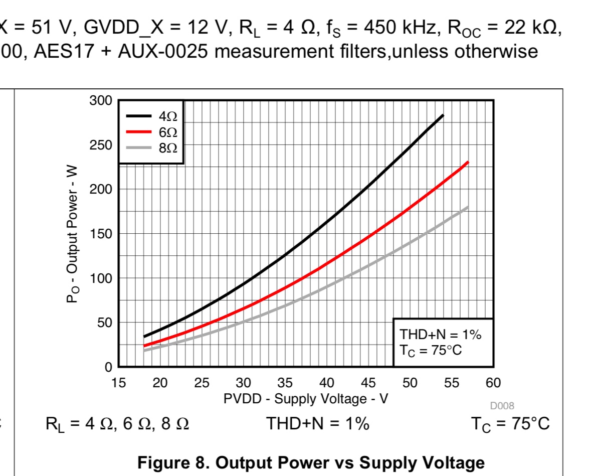

With 48V, I dont want 300W RMS at 10% distortion, I just need 200W of clean 1% distortion as mentioned in the datasheet, so its important that I use 48V.

As I said I need 200W+200W RMS for dual subs. During short moments of sub peaks they will definitely be required to supply about this power, maybe not always as music does not have continuous bass but intermittent onlyYou could ask yourself if you really need that bizarre high output power. Even with deafening volume you will not use more than a few Watts.
