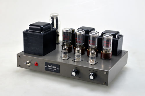

Second is a Kit and again its a noodler by Raphaelite DPK6L 6L6 Push-pull, it is a kit though but at a higher cost in the $1000 Aud range
Article: DPK6L 6L6 Push-pull DIY KIT
Model: DPK6L Tubes: 5Z3P/5AR4/5U4G×1 6N3/5670×1 6N1/ECC85×2 6P3P/6L6×4 Input Sensitivity: 210mV Power
Output: 2×18W (RMS THD<10% ,1KHz)
S / N Ratio: 85dB
Input Impedance: 100KΩ Output Impedance: 4Ω, 8Ω (optional)
AC Input: 100V-240V/50-60Hz
Power Consumption 140w
Frequency Response: 12Hz – 45KHz -1dB 8Hz – 80KHz -3dB
Dimension: 340×230×190(W-D-H)
Net Weight: 15KG
Is this closer to what I should be looking for by avoiding the 70's tone and a more modern push pull designs for my music tastes?
