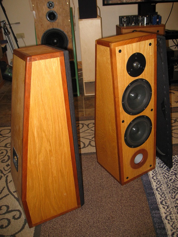

They are harder to make, that's probably the main reason. I've done a few speakers in truncated pyramids and it takes a bit of time to get all the joints perfect.

A truncated pyramid has no primary resonant modes in its sides, back or front. A knuckle wrap test sounds quite different to a rectangular box. Diagonally bracing panels in a rectangular box can be difficult too but will also break up the resonant modes.

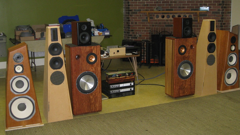

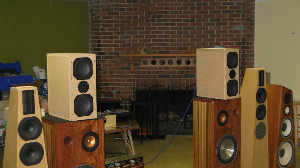

That being said, there have been several nice sounding speakers made by various members of the Seattle diy club. A few examples here.
Some lovely examples. Thanks Dave.

A single sloping panel like Dave shows in the middle image is fairly easy to do, even double (sides and top) sloping like the outer speakers in the last image are easy enough to calculate, set your saw and cut.

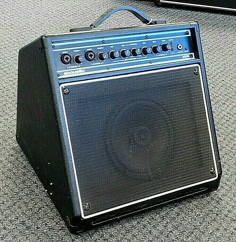

I do agree about the sonic advantages of pyramidal / triangular loudspeaker enclosures, though. My inexpensive Acoustic AG-30 acoustic guitar amplifier (intended to also work as a small P.A. system for vocals, keyboards, etc) sounds much less "boxy" than competing products with more typical rectangular-prism shaped enclosures.
The AG30 enclosure isn't exactly pyramidal or triangular, but it has only two parallel sides (the two end walls). The attached photo shows the AG30.
