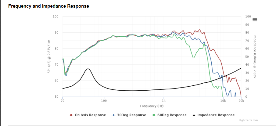

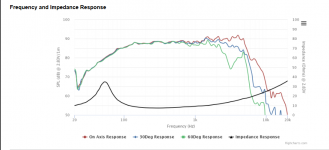

Just looking at the graph for these woofers, I would say that they should sound pretty good on vocals running full range with NO EQ, provided they are in an appropriate enclosure. Note here I am talking about running them alone without the tweeter!
I doubt that they would sound muddy. Maybe a bit thin on the low end due to no baffle step compensation, and no high end due to roll off above 4K.

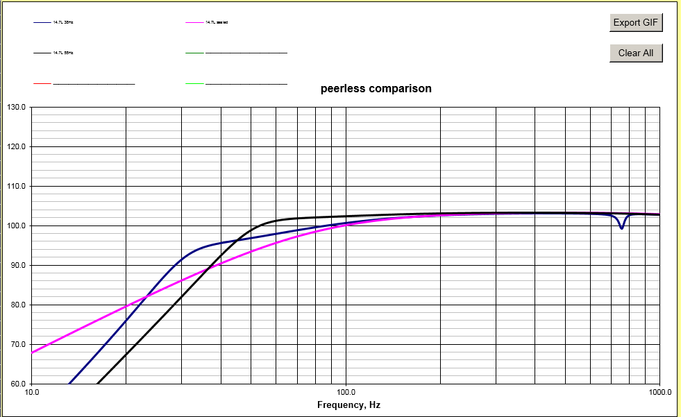

Thanks for answering the questions. The enclose Q is not relevant here as it is bass reflex, it is a parameter for sealed enclosures.
Using the specs for your Tymphany 830874, the tuning of the BR1 at 38 Hz is far from ideal. Attached is a graph showing three plots, sealed is pink, BR1 default tuning Blue, tuned to 55Hz black.
Now second thing, for bass reflex generally you tend to only line the walls not fully stuff the cabinet. If the stuffing is in the way of the ports it will change the tuning.
As the BR1 is a rear firing port you need to be careful about placement as well, it shouldn't be too close to the wall.
