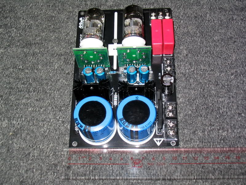

As you might have guessed ,I'm new to tube circuits. I purchased a few pre built tube preamp boards for use as a gain stage in resistor i/v on some TDA1541 cd players I have. The boards are straight forward , with very easy hook-up. 120vac , 6.3vac , input , output. Bridge diodes are included onboard for each power supply. I'm currnetly using Line voltage 120vac and a 6.3vac transformer for heaters. The circuits works fine. In my shop , I use a 2 channel reciever for testing. Everything worked fine, sounded very good , and I was quite proud of myself😉. HOWEVER , I brought the player into my house and connected to my main system. This includes a good quality tube pre amp , that I have owned for 15yrs without issue. When I connected it to my tube pre , upon turning it 'on' , the player blow a fuse. i figured it was a glitch, so I replaced the fuse with a slow blow type. This also blew. Took it back to the shop , connected it to my reciever and NO problems, players fine. Back to the house , fuse blows. Anyone have insight? Pics below

You are tying the circuit to your home's mains. Depending which way you wired the hot and the neutral to the circuit, one of them becomes the common in the amp. If you then plug that into a component that ties its signal common to earth ground, you have just shorted that leg of your home's wiring to earth ground. In your case, it sounds like you have the hot side appearing as the common. You have been lucky that you have not been shocked.
It's possible that either the outlet in your shop or your home has the hot and neutral reversed, which is perhaps why you didn't receive a shock while in the shop.

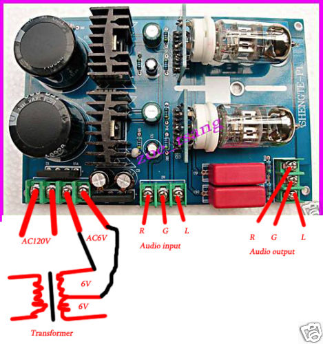

When you use a bridge rectifier directly from the wall (you're looking to die - SOON), in essence your output negative ('ground') is connected to both sides of the AC line. It isn't really, just every other half cycle.
DO NOT SCREW AROUND WITH DIRECT CONNECTED SUPPLIES !!! (until you know exactly WHAT you're doing)
If you're not having trouble connecting to some units it because THOSE transformers are covering your butt. It you touch your 'ground' and a true earth ground, you will get a nasty potentially lethal shock.
If I seem harsh, it's to keep you around. Always always ALWAYS use a transformer for your projects and experiments.

It appears I was mislead by the seller , but I suppose I should have known better. What usually makes sense, should be obvious. Please see pic below.

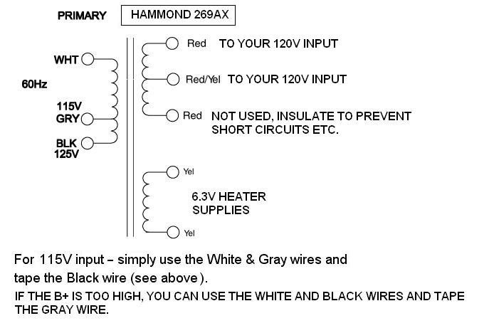

Hi Paul, you need something like a Hammond 269AX or similar. A transformer with 115V input and giving two outputs. One output will be 115V to make the B+ supply for the amplifier and also provide 6V for the Tube Heater supply.
The 269AX has a 250V output but also has a centre tap (Red/Yellow wire) so by using this, the output will be 125V when used in conjunction with either of the Red wires as shown on the circuit. Just tape up the unused Red wire so it cannot short anywhere. If you think the 125V may be a little high then you can use the additional winding on the primary (i.e. connect your main supply to Black and Gray) and this will have the effect of giving you 115V input to your amp using the fore-mentioned Red and Red/Yellow wires. Don't forget to tape up the unused primary wire whether it is the Black or Gray one.
