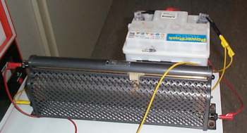

Till,
You win, that is the strangest looking pot I have ever seen and it's power with a car battery. Does it run in class A.
