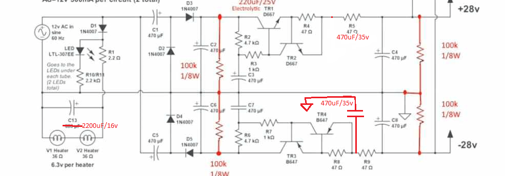

ive actually abandoned this psu circuit for my preamp in favor of a bridge rectifier/voltage double circuit after messing it up. But id like to figure out how to fix the circuit so i can learn something.
attached is a schematic of the psu circuit i was using.
While tinkering the -28v broke lose from the board and i didnt notice. It was touching the positive heater coil wire for the first pin when i turned on the amp, and it mustve created an arc. It soldered itself to the pin. And i def didnt do that.
It was on long enough to totally fry R9 til arc, snd it straight up melted Tr4, it killed Tr3.
I replaced r9, and both transistors, and the PSU is working again with stable voltage output, it powered the preamp just fine and sounded fantastic, HOWEVER, there is now a dull hum that stays the same volume no matter where i put the volume knob on the preamp. It sounds like 60hz, but im getting it out of my mid bass drivers too, which xover at 120hz. So it may be both 60 and 120 together im not sure.
im a total novice, so at that point i just built a bridge rectifier and voltage double to power the preamp from a single transformer that outputs both 12v and 26v
If anyone feels like helping me figure out how to diagnose what's wrong, id love to fix the initial PSU so i learn something about what happened. Thinking maybe i damaged a diode and its leaky now? idk

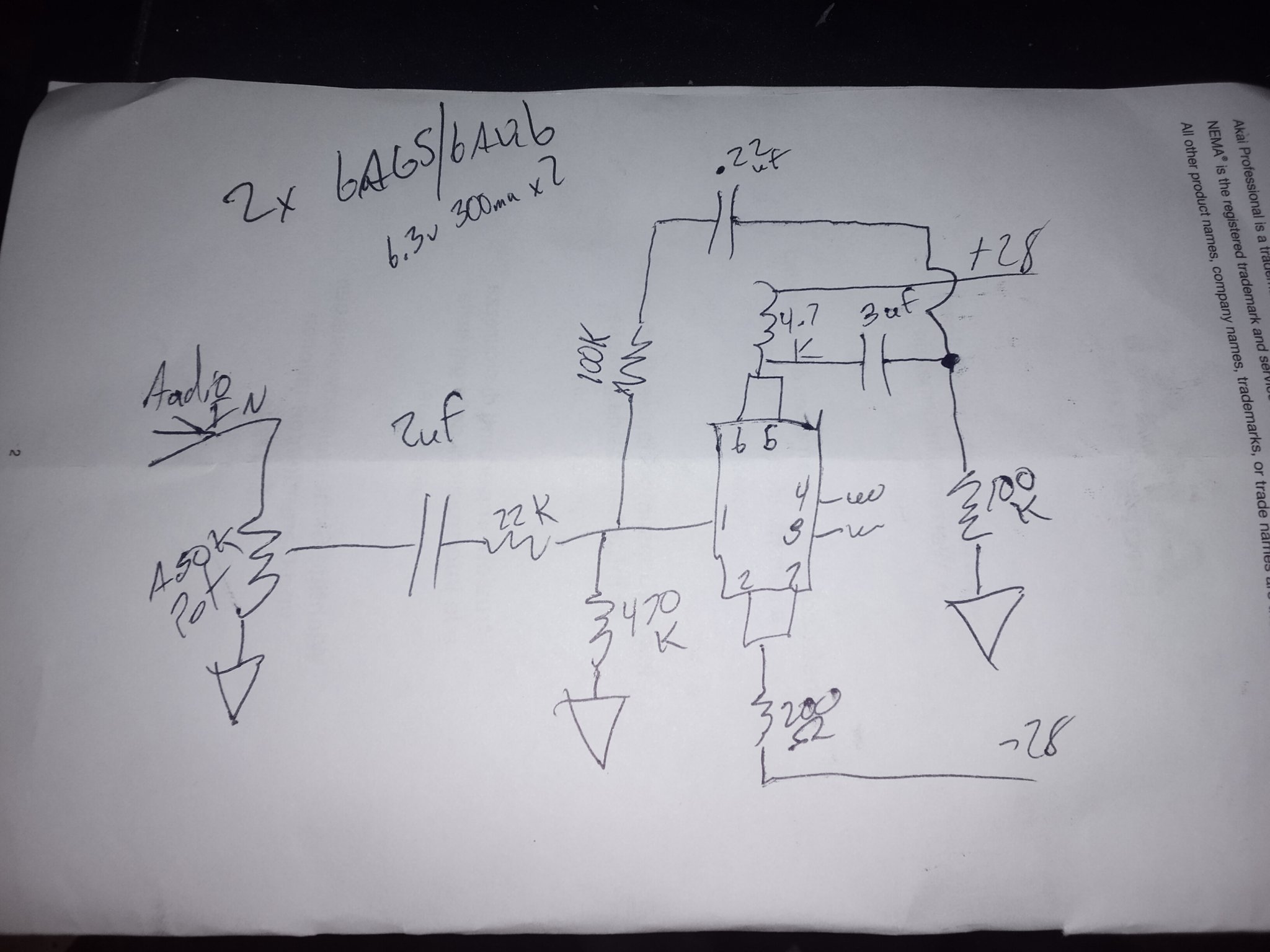

Amplifier section schematic too, but i dont think its totally necessary. But not sure so posting it too anyway
I dont think i really like the original PSU design, seems quite complicated for the result it gives, but it ran much cooler then my current one, and performed identically, and once c2-8 were all swapped with 2200 uf it was DEAD silent until the fireworks lol
Edit:: I did experiment with adding extra filtering caps, nealy 10,000uf no change. Other unused sets of tubes, no change. Gotta be the psu circuit right? I shoved a lot of current through that negative rail pretty sure.

Is the ground connected as before, the grounding should be exactly as the schematic shows. Also check C7.
So I noticed your recent posts about your continuing adventures with this little preamp. I'm not familiar with those types of power supplies (dual rail with + and - voltages) so I can't offer a post mortem analysis.
But since you've destroyed the power supply and say you don't have much of the original device left I would suggest that this is a perfect opportunity to improve what you had.
The place to start is by looking at the tube data sheet so you can optimize the circuit for the particular tube you want to use. It seems you prefer the sound of the 6AG5 to the original tube. Fortunately, the data sheet for the 6AG5 gives operating points and plate curves for operating the tube in triode mode, which is how these preamps run their tubes.
I'd suggest that you ditch the overly complex dual rail supply for a conventional linear supply. This will be much simpler to build and it will allow you to operate the tube at the operating points specified in the data sheet.
The stock design ran the tubes at a fraction of the recommended voltage. That's the biggest flaw in these. Why repeat that mistake? Since you need to replace the PS you might as well do it right this time.
Total parts count for a proper linear supply is much lower too. One power transformer will supply both the B+ voltage and the proper heater voltage. You'll also need 2 diodes, 3 electrolytic caps, 1 choke and 1 resistor. Actually, that would be the more "deluxe" version. You could probably even eliminate one of the caps and the choke.

The 6AG5 has a 6.3Volt 0.3 Amp filament, when the filament is at its normal heat (all warmed up) . . .
6.3V / 0.3A = 21 Ohms.
But, when the filament is Cold, it is probably about 5 Ohms; two in series are about 10 Ohms;
42 Ohms After the filaments are warm.
You have a single 1 Amp 1N4007 diode in a Half Wave rectifier mode.
You have 12Vrms on the transformer secondary (17V peak).
17V / 10 Ohms (two 6AG5 Cold filaments in series).
17V / 10 Ohms = 1.7 Amps peak.
Actually, at power up, the uncharged filter capacitor by itself is far less than 10 Ohms.
Ouch!
Capacitor input filters usually draw peak currents that are 5 to 10 times the DC load current (if the capacitor is driven by a full wave rectifier circuit).
Capacitor input filters usually draw peak currents that are 10 to 20 times the DC load current (if the capacitor is driven by a half wave rectifier circuit).
(I am talking about the DC load current After the tube filaments are warm).
If the 1N4007 does not die, the secondary of the power transformer must be getting very hot.

Thank you both. It won't let me quote for some reason rn. But thank you anyway. All very useful information lol.
And no, ive actually been quite shocked how cool everything was running. even the diodes and everything have stayed cool to the touch. All but a 22ohm 3 watt resistor that had no business being anything over 2ohm and under 5w. I had a 1amp transformer at first. Quickly replaced with a larger one, and it was just warn to the touch.
I already had much higher amperage rated diodes on hand expecting them to fail honestly. But this first board i built not thinking about easy reparability either.
Looks like ill be rebuilding a power supply again this weekend. Really im just using this preamp to figure out wth im doing. Keep finding myself overloaded with information im not looking for trying to find the info i am looking for, so big thanks to both of you! I did build a simpler power supply but im still giving 52v across the plate and plan on improving all that. It already sounds plenty good enough for me to keep moving on. Not like these components are pricey.

Often, it is not necessary to use DC filaments for a preamp.
But if it needs DC for the filaments to keep the hum down, then . . .
A full wave bridge rectifier works better than a half wave rectifier. Of course, details such as the Ohms value of a dropping resistor value will change.
Full wave is easier on the secondary of the power transformer, and full wave also gives lower hum, even if the capacitance of the filter cap is unchanged.

*I have made a MUCH simpler full wave bridge/doubler DC supply circuit running from 26.5vac providing stable 53v, and a full wave rectification circuit for the heaters from the 12vac output on the trans. Is a single shielded EI transformer, 26vac and 12vac outputs.
I used 3a diodes as well, and my transformer is indeed running much cooler to the touch now without the janky circuit i was using..
I also flipped around the positions of the 100k and 470k resistors in the gain stage, As im pretty sure i misunderstood which 100k resistors were being referenced as needing a value change once i began actually researching this and digging up circuits lol.
