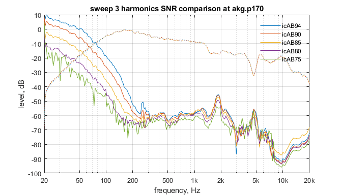

I am measuring a few 4-5' mid-/fullrange loudspeakers for usage in high-quality hands-free terminals and see the same picture. The non-LTI distortions stay the same (re main) regardless of signal amplitude, even for very small SPL (AEC adaptive filters pick up everything). The reason for that seems to be an abnormal 3rd harmonic. In mid frequencies, it stays practically the same. Therefore, I can not model drivers with Volterra. In my experience, the constant level of a harmonic can be a result of feedback ... and that's a kind of what shorting ring does.
May anyone confirm or negate that this is the effect of shorting ring?
Attached are
1) residual distortions of 100mm Infinity Reference on Queen's Dust (15s, amplified by 30dB) and
2) 3rd harmonics sweep results for various SPL, 75dBSPL ... 94dBSPL @1m.
Attached are
