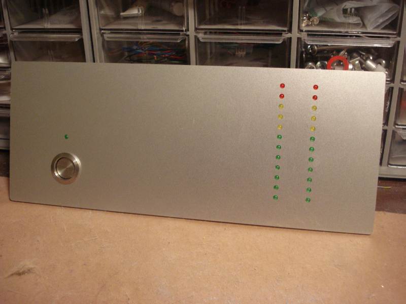

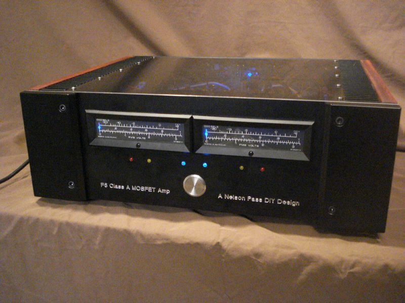

Im looking for great looking faceplates but unable to find good ones. Btw who manufactures the faceplate/chassis for Passlabs?
Where we source things is proprietary. Unless you were placing a volume
order they would probably not deal anyway.
If you look around you probably can find a local machine shop that can
mill a faceplate to spec, and then you can find a place which will grain
and anodize it.

One annoying thing about custom made faceplates in small quantities is that you run into more problems than in mass production.
Aluminium alloys, even suitable ones for anodizing like AlMgSi0.5, can show defects after the anodisation process - not before. Its like your car is finished but the body cant be painted - mean isnt it? Pitting, stains, grey areas are the key words. They are often a result of badly cast alloy,
i.e. the process of cooling was too fast.
A company told me they had 30%
anodizing failure when they bought aluminium from a supplier.
They decided to have 3 tons cast exclusively and failure dropped to 10%.
But there are anodizing companies also specialized on small quantities and prototypes. None of them will provide fail-safe aluminium
Thus you should buy more aluminium and give the anodizer a sample for testing before you start the milling work.
