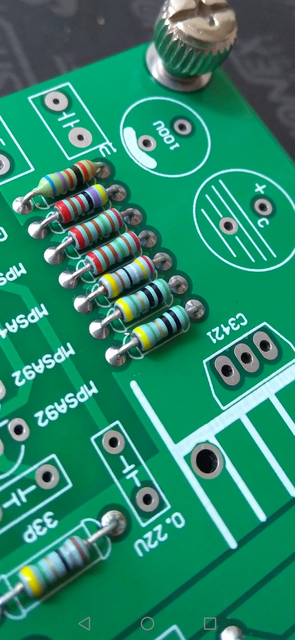

We used a lot of these in the 80's and 90's, I believe they were sold as Digikey's "house brand". Decent quality metal films with copper leads. Anyone know who the actual manufacturer was?
The box says Taiwan, but it looks like I just found the answer. The MF-25B is the earlier Yageo prefix for what they now call the MFR-25FB series. The change came in the mid-late 2000's. Ex: their current 9k53 is MFR-25FBF52-9K53, the earlier number was MF-25-B-9.53K .
Also, I see that the current Yageo MFR- resistor kits have the identical part numbers as the MF- ones I bought 30+ years ago.
