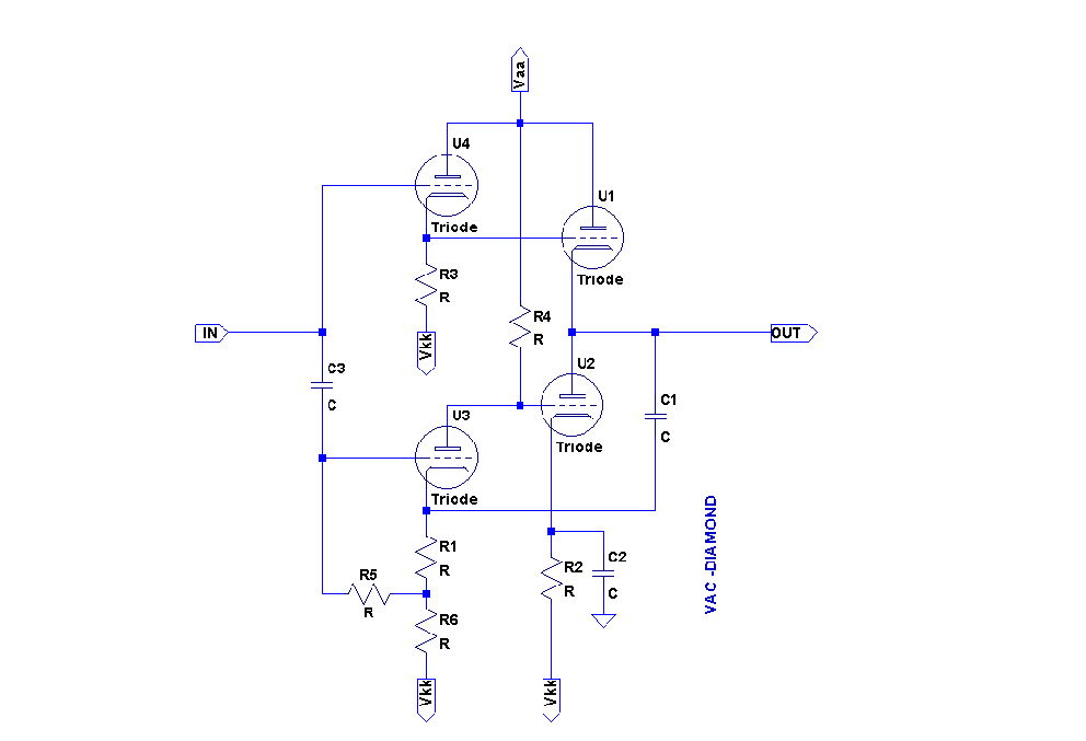

since so many of these classic circuits originated from tube/valve days, is there a way to implement a diamond buffer using our single sex tubes/valves?
I know, that's what single sex implies.
Transformers are traditionally used to overcome the lack of Pdevices
But is there a transformer less way to implement the diamond buffer with tubes/valves.
If there is, then that may give a clue to the date of origin.
probably named after mr.diamond and his amplifier circuit:
http://www.diyaudio.com/forums/soli...-complementary-power-amplifier-j-diamond.html
regards
regards
It could look something like this.
But it defeats the main advantage of the diamond, mainly taking care of the dc voltages easily and efficiently.
With tubes, you need voltage translations using capacitors or similar devices.
I doubt something like that has ever been used (4 tubes! enough to build a complete radio set)
