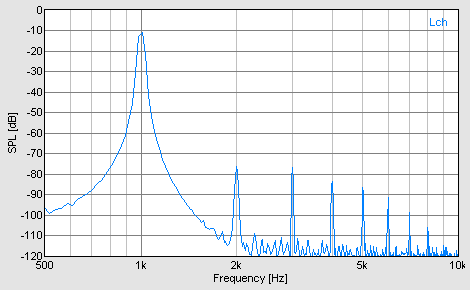

I am still trying to build a setup to measure HD in a resistive dummy load, but for now, I look at the HD spectrum on my reference speaker to make sure it is not any higher than the native capability of the speaker.
Here is an example of a very simple 8 transistor 50w MOSFET class AB amp and it's clean (no-contribution) to the speaker measured HD plot.

HD spectrum as measured on 10F/8424 and RS225-8 FAST 2-way with transient perfect passive XO:
Note that this is a sealed 24L woofer, yet the class AB amp has enough authority to get 51Hz F3 for the bass. I could never get this kind of extension with a TPA311x class D.

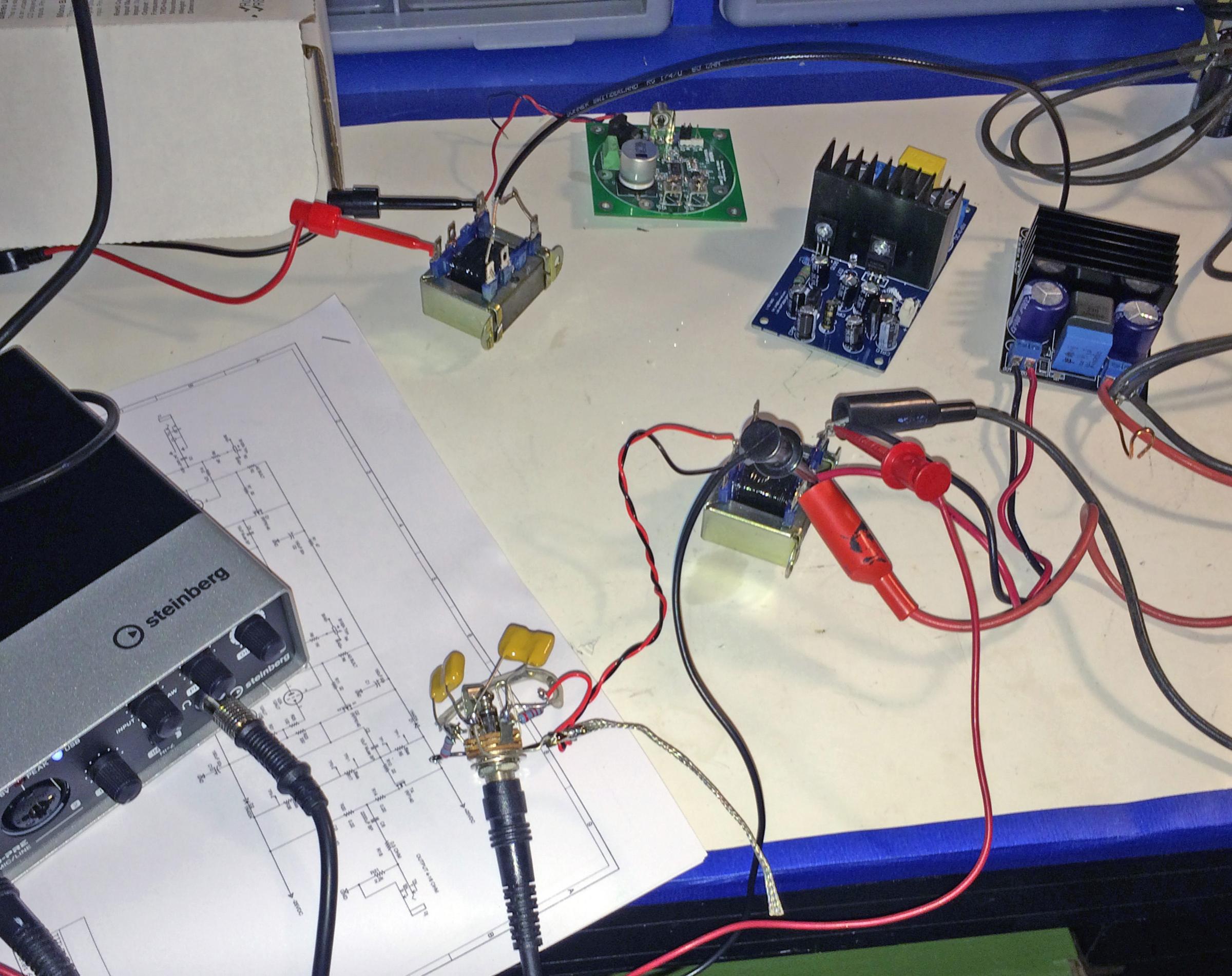

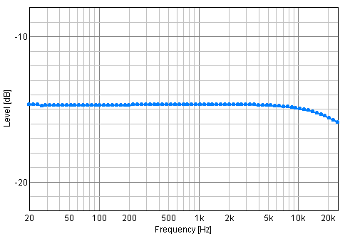

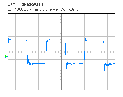

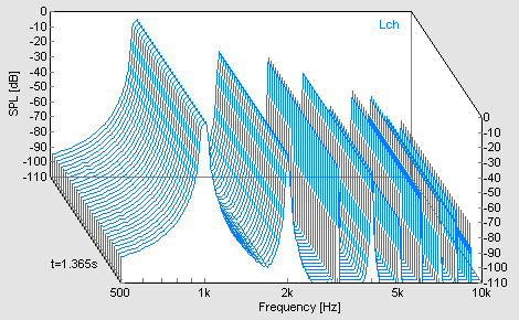

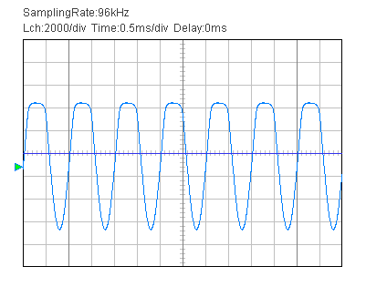

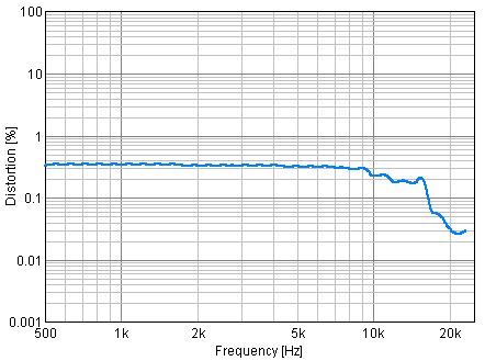

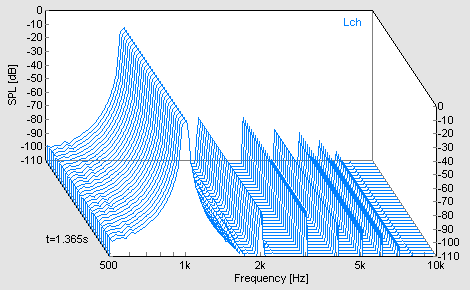

here are some plots I just took on a YJ half-bridge board. I'm liking the waveform of the clip. It looks musical.
These are all into 8 ohm. +-34V, protections disabled and gain of 4.
Still very interested in pursuing to the bitter end. Just got in some LJM modules so anxious to try.
Bought some certified irs2092 from Mouser and will replace the shipped ICs just for grins.
The TPA3118 PBTL shipment should be here in a few days.

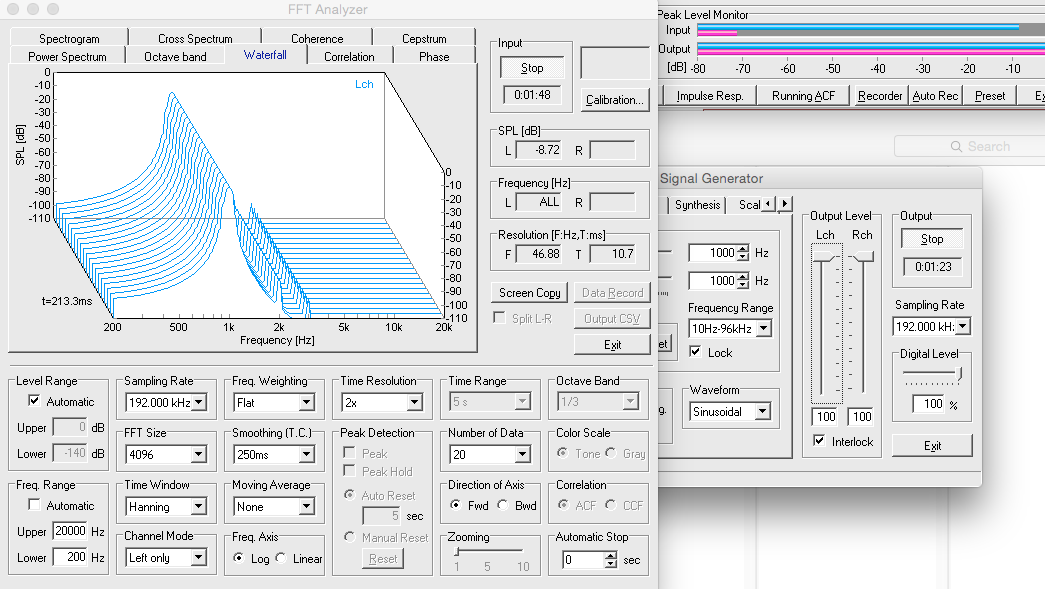

Looking very closely at the scope view, I can of course the the switching. I'm wondering if the THD and FFT engines are analyzing these minute artifacts and integrating into calculation.
The file names are descriptions.

Measuring a class D amp with a sound card (or other digitized method) can be tricky. Class D amps put out significant amplitude supersonic output (usually in the 200kHz to 600kHz range) due to switching frequency feedthrough. It's not a 'distortion' the way most think of distortion, but more like a spurious tone. Not likely a problem for listening, since no tweeter is going to be able to reproduce it at even measurable levels.
But connect the amp output to a soundcard, and you'll subject the soundcard to that highish supersonic output. The card has anti-aliasing filters, but not enough to deal with hundreds of millivolt signal levels like from a class D amp. What happens is that aliasing occurs which folds the energy into the display to make it look like audio band tones in odd places (they aren't really there, it's a result of violating the bandlimiting requirement needed for digitized audio systems). Systems like AudioPrecision have extra lowpass filtering available that can be inserted to cut the supersonic junk down to manageable size when measuring class D amps.
Measuring the speaker output (probably) won't be subject to the antialiasing. But if you want to measure the amp's output directly, you should probably make up a high-rejection all-pole filter/attenuator to put between the amp and the sound card.
