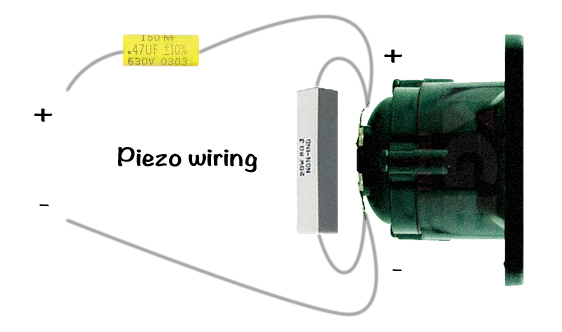

The Betsy WOW sounds excellent on an open baffle (18" x 18") sitting on top of H-frames (with Eminence Alpha 15). An inexpensive lemon squeezer piezo with an 8ohm resistor and a .47uf cap (I will try .33 to reduce its contribution a little) adds texture and air. Overall, this system sounds excellent! I'm using a Topping TP21 digital amp and it's more than powerful enough to fill my apartment with sound.

Godzilla, Thanks for posting this and linking to your blog. I just sent WB some cash to get a set of these for use over an h frame alpha 15. Would you mind posting a picture of your resistor set up? I'm so new to this and that part of the equation is still completely foreign to me. Googling lemon squeezer piezo comes up with nothing useful. haha
I'd really appreciate it.

No problem Mike! I hope you enjoy the Betsy's. They have been my 'go to' speaker for several months and I think I'll keep it this way for a while. Did you get the drivers without whizzers?
See the illustration I made for you. I actually ended up using a different piezo than the 'lemon squeezer' but they all sound about the same and would all require tweaking the 'crossover'. I'd recommend using an 8 or 10 ohm resistor (they both will sound the same) and trying a few different capacitors to see which sounds best to you. Try .33uf, .47uf, .67uf and 1uf. One of those should give you a nice blend. It depends on how much treble you want to add to the Betsy.
Keep us posted and enjoy!

Thanks so much for the illustration! That is really awesome. Are you running the betsy without a crossover?
I got the one with the whizzer. From your blog, it sounds like I'll run it first with out a tweeter as opposed to the WOW?
