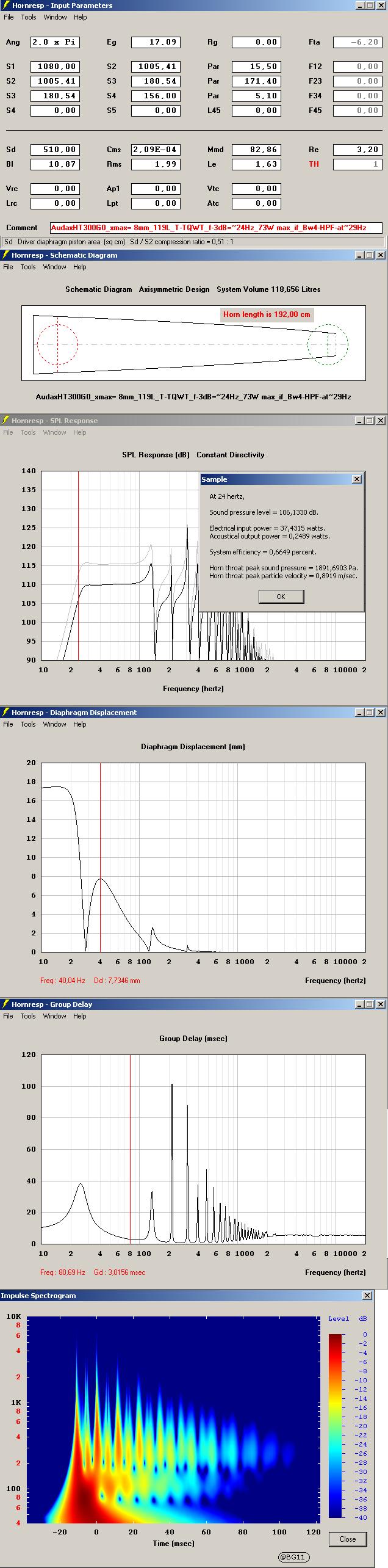

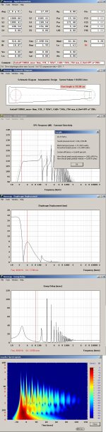

Having discovered that my Home Theatre Processor isn't very good at re-routing LFE to to my main speakers (if at all), I've decided I need a sub of sorts.
My mains are floorstanding transmission line's and their bass response is pretty flat down to about 80Hz, and they still keep going down to 25Hz, albeit quietly (see graph below).
I have 2 spare 12 inch HT300G0 Audax sub drivers that have been sitting in the loft for years, and a couple of spare monoblocs I can use to power them.
My first idea was the set the processor to to output purely LFE below about 80Hz to the sub channel. Then as the sound was to be more for 'effects' than for actual sub bass, I was thinking of mounting a sub driver within each of my sofa's, underneath. There is enough clearance, and my idea was to basically screw a 3ft x 3ft sheet of 18mm MDF to the sofa's frame, cut out a 12 inch hole, and mount the driver pointing downwards. Then I'd just connect up the monoblock and I've got a free-air LFE generating sofa!
But then as always seems to happen, my ideas start developing. Unsatisfied with the potential effort vs. result, I looked into building a proper box.
A sealed box doesn't go low enough.
A vented box has to be very large at 191 litres but produces the deepest bass - flat down to around 30Hz.
A 4th order bandpass is still large at 138 litres, but seems to produce a perfect roll off right at the point where my main speakers start to come alive. However, this box is only flat down to around 40Hz (10Hz higher than a vented box).
Which one do you think is best... And why?

You should be able to rely on the LFE output rolling off around 80Hz,
so I can't see any real advantage to the bandpass arrangement.
specs are here : http://www.cadaudio.dk/ht300g0.pdf
For subs they are high efficiency, 91dB/W/1m, 94dB/2.83V/1m.
With a high Qts fro vented you end up with boxes a lot bigger than Vas.
something like 120L tuned to 28Hz looks about right to me. Another
option is to fit passive line level low bass boost at the end of the
monobloc leads and use around 60L sealed with low bass boost.
(Or mod the monoblocs feedback loop for a peaking high pass,
say Q=2 (+6dB) at 30Hz for near the same response as vented.)
Vented will go louder at 30Hz than sealed though.
Whilst your sofa's will reperesent a very lossy cabinet, what sort
sort of volume ? Vented still just might work in some fashion.
rgds, sreten.

I'd go for the big box, but power is nearly free so you could also choose an alignment that lends itself to equalization and correct it electronically. That's what they did with the old Swan project in Speaker Builder, and it's also the idea behind the Bassis(tm) that Marchand sells.

Hi, your 4th order bandpass looks fine on paper, but you will need a LP filter @ the higher Xover f to filter out any garbage. Plus in reality with that in place, that nice looking roll off point @ 80Hz will be affected by the LPF.

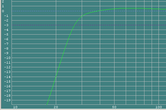

Similar to sreten's 120L tuned to 28Hz design, i did this one 150L fb = 30Hz -1db @ 30Hz
Max Power is limited to 118W @ 43Hz
Ave Max SPL = 113dB

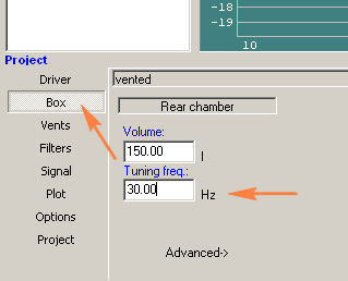

but how would I tune it to a certain frequency? I don't see any option to do that in winISD so I guess I need something else.
You just change the frequency in the tuning frequency box, the
vent length is recalculated for the default / chosen diameter.
rgds, sreten.

I'd had a play with changing the tuning frequency, but I'm not entirely sure what I'm aiming for. Is the frequency the resonance of the enclosure?
Is it just a case of fiddling with the frequency and volume until the graph has a nice slope?

Play with box volume and available space, choose a size that can be built under your couch, then experiment with tunings.I'd had a play with changing the tuning frequency, but I'm not entirely sure what I'm aiming for. Is the frequency the resonance of the enclosure?
Looking at these pictures there's a huge volume inside the sofa. Only trouble is some walls are very flimsy, and some walls are just the sofa's foam. No way to calculate anything I guess. How about a big thick sheet that seals off the entire bottom section with the driver in the middle?
Box tuning is Fb (Frequency of box), or box resonance.
The resonant frequency of the driver is Fc.
An Fb below Fc will have less output compared to one above in a given size box.
Too high an Fb in a small box, and the box will “boom” (a bump) at Fb.
Too low an Fb, and the response will look more like a sealed box.
You need to juggle box size, Fb, output level and excursion to see what the best compromise for your musical taste, available acceptable size, and your driver's parameters are.
Since you have decided against EQ, "a nice slope" would be a flat response.

...I guess those pictures are just for looking nice... 374 thousand watts?!!
IME, If a T-TQWT is built,measured and compared with the HR graphs: Difference's would be near negligible.
I only read 37.5 W at 24 Hz.😀, You need to build at least 10000 T-TQWT's to withstand that power.😱

Good idea..LFE-sofa...Why?...IMO,The submitted picture talks for itself:
b🙂
How can the distance between S3 & S4 be less than 1/2 the diameter of the speaker?
