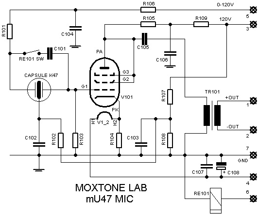

Here are a couple of specimen schematics. I would prefer to use a plate choke to avoid dropping volts on the anode - thought about the Hammond 156C, I have a few and used to use them on 26 tubes.

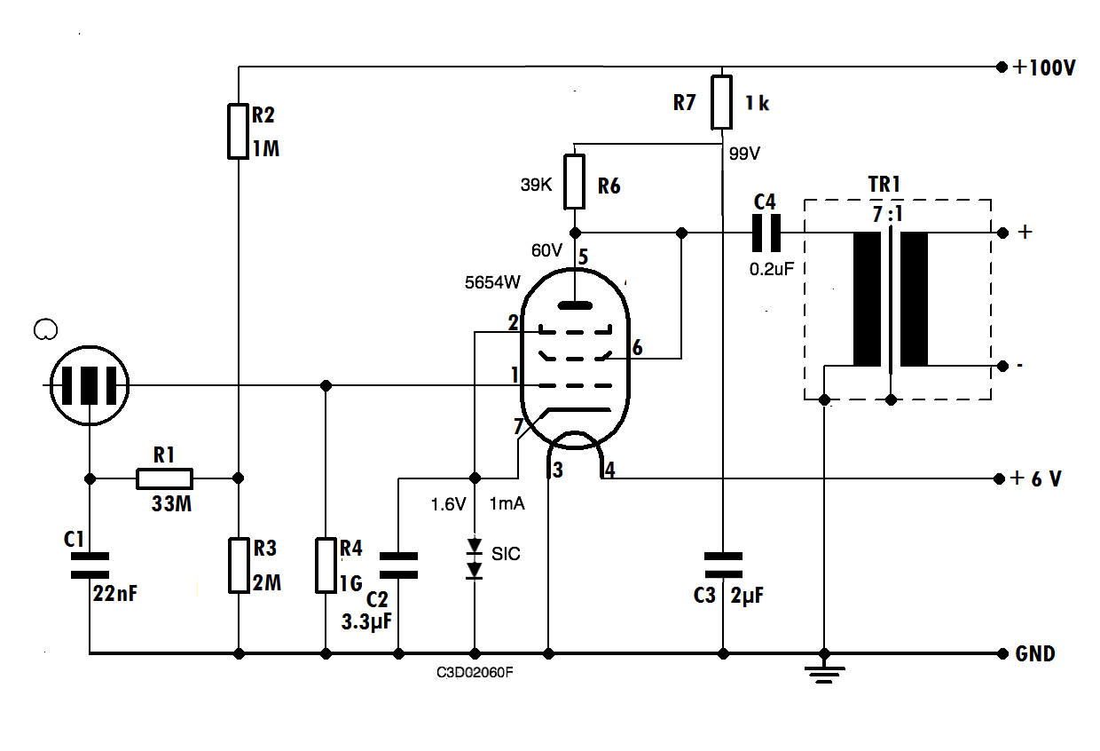

Here's a simpler circuit. I've never biased a capsule before - should be somewhere between 48v and 60v from what I read. This could be tried with the 5654 with either a resistor load or a plate choke. I think I'm getting closer - I read that 5654 is a good low voltage tube.

Anyway, I've redrawn a circuit with the 5654W to give what looks to me like a better operating point, and used 2 SIC diodes for bias. These are what I use in my regular 26 preamp, and they seem to come out at around 0.8V each. The 0.2uF coupling cap would be 2 of 0.1 Russian Teflons, FT-2.

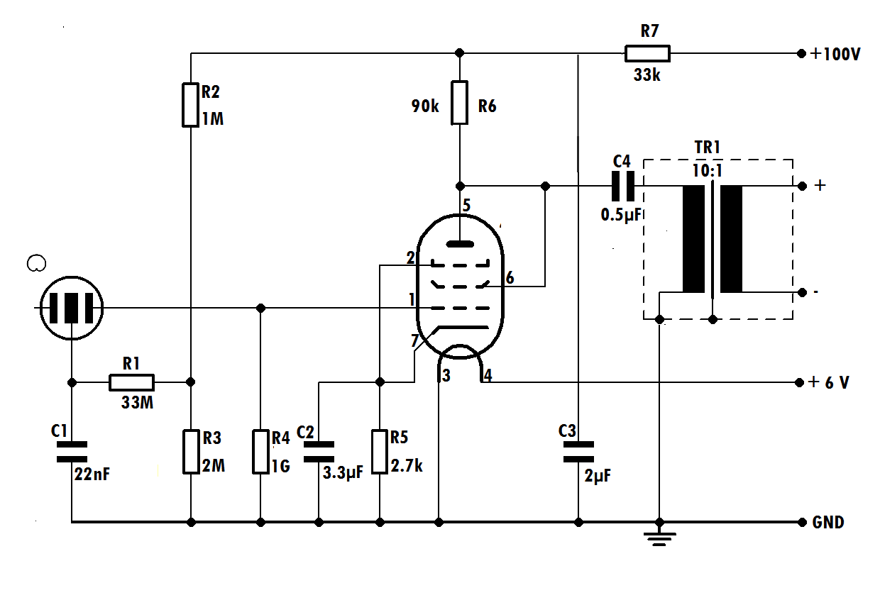

I used 6N16B with a great result in a stereo microphone, but I used them as cathode followers. When selecting the tube you want to prefer the one with as lower as possible control grid current in working conditions, to save low frequency response of the capacitive capsule loaded on grid leak resistor.
Hello Anatoliy! thanks for the email. How do you tell the control grid current in working conditions from the data sheet?
Have you ever used the 6ZH1P-EV for anything (5654W)? This will be the first one I try. I also have an EF86, and some 6e6, which is a higher current tube.
Did the last schematic I posted look OK to you? Any changes you would suggest?

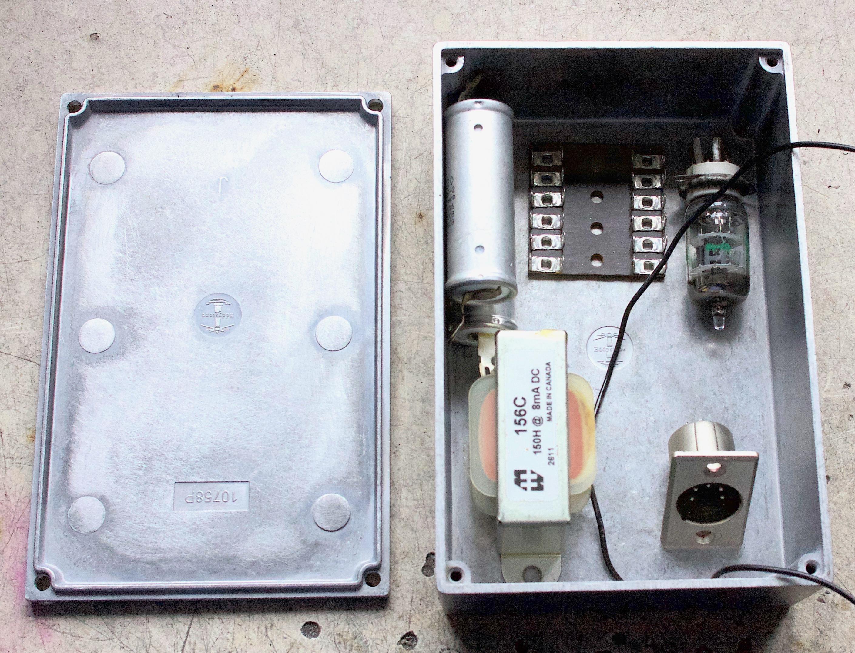

I'm not keen on subminiature tubes with flying leads - I don't need the reduced size since I plan on using a generous size case. Plus I want to do some tube rolling. Mu needs to be over 30 since I'm planning on a 7:1 OPT. Attached preliminary stage of microphone case. I may or may not use the 156C plate choke. Needs a 7:1 Lundahl transformer in there too. The two FT-2 0.1uF teflon coupling caps are what I always use in my audio builds.

can't tell that from the datasheet. I just breadboard and see if anode current is fine. If it is too low, grid current is too high for the 1G grid leak resistor.
By the way, in my microphones I use 18M only resistor, but it is bootstrapped (sharing the secret). ;-)
