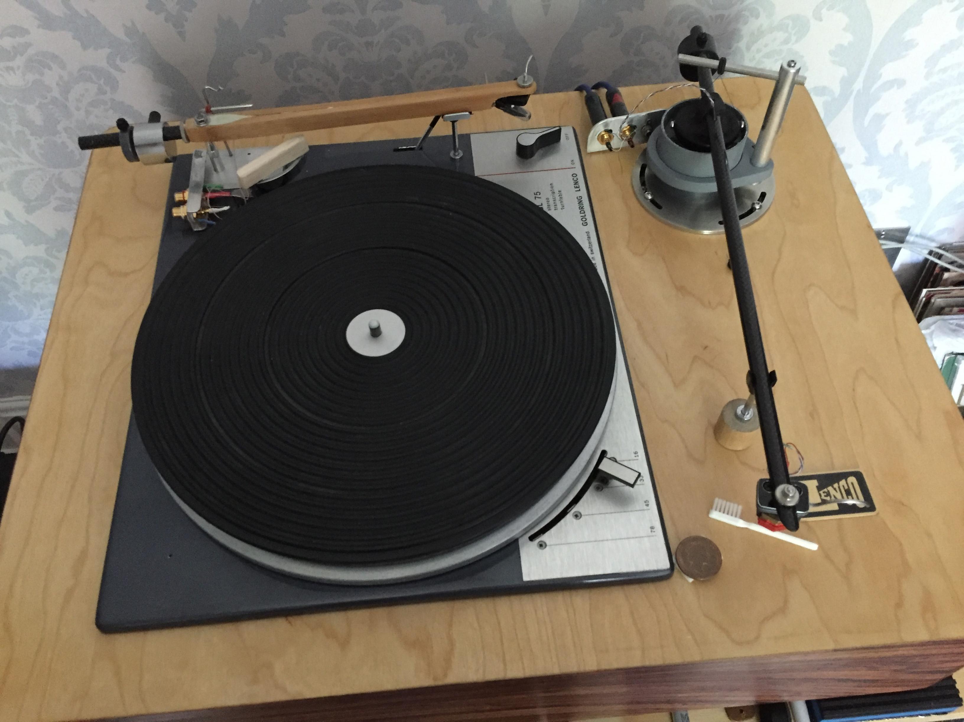

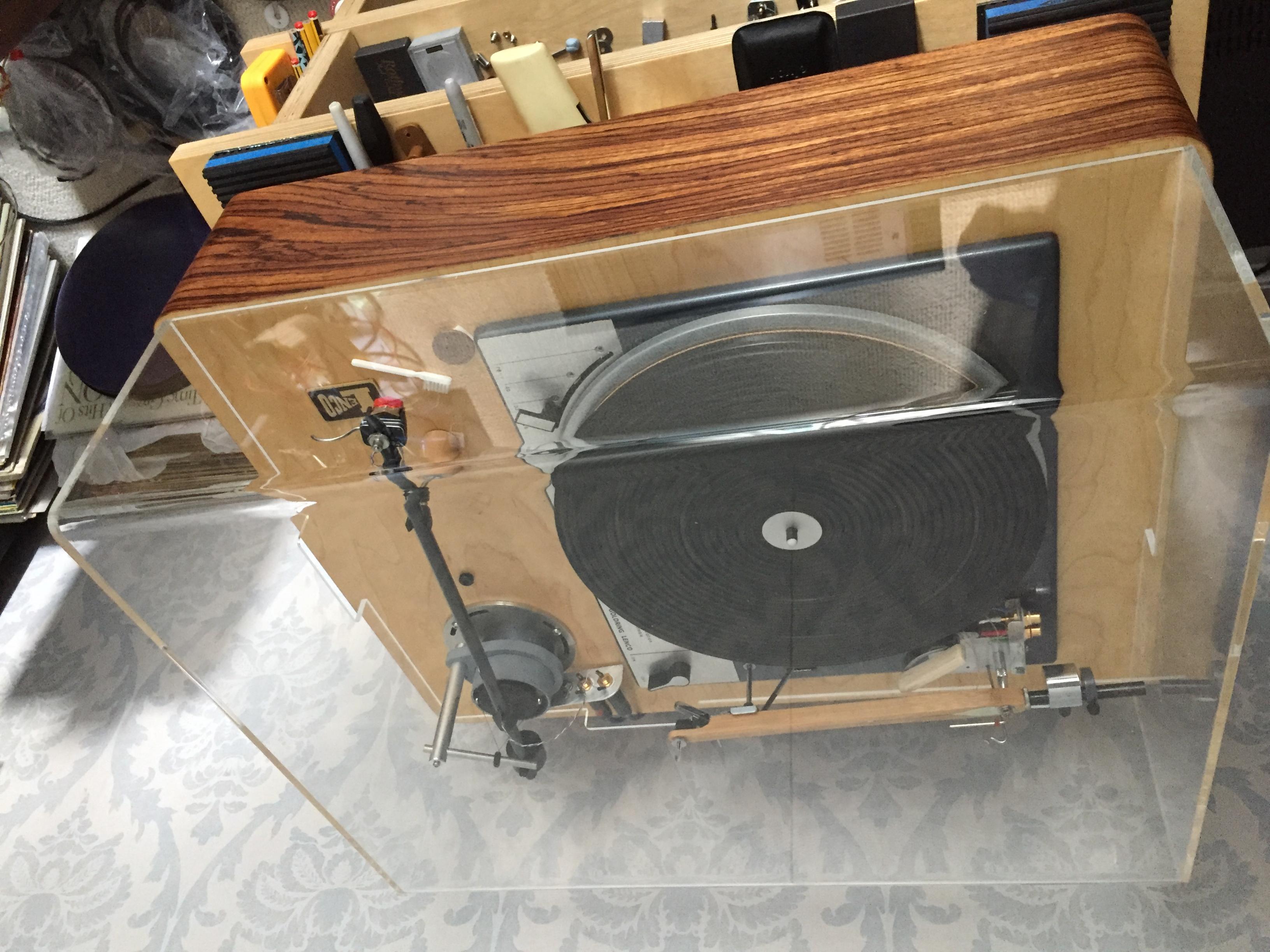

I am building myself a new plint for one my Lenco L75, and I think I make like this. See Link! LencoL75
Which tonearm?? Maybe a Grace G-840, or Yamaha GT-750, or AT 1501 II, or maybe FR-54?, or? I do not want to spend 2500 GBP on a SME 309. I will put on a Nagaoka or Ortofon 2M Black pick-up on the tonearm. My question: Which tonearms of these fits one of these pick-ups best?

The common wisdom is to find out the compliance of the cartridge/stylus suspension and match that to the effective mass of the tonearm so that the two combine to resonate at somewhere between 8 and 11 Hz, but not lower or higher than that (if you can help it).
Starting with the effective mass of the tonearm (plus headshell and cartridge mounting hardware), let's say we take the AT-1501 mkII, which is supposed to have an effective mass of around 20g.
The Ortofon 2M Black is supposed to have dynamic compliance of 22 x 10-6cm/dyne, ("22 cu") and weighs 7.2g.
According to the vinylengine cartridge/tonearm resonance tool, a cartridge of 22 cu in a fairly big and heavy tonearm of 20g effective mass produces a resonance of around 7 Hz. That's just a little too low, too close to record warps and the floor shaking from footfalls.
What if you take that same tonearm with eff mass of 20g and put in a low compliance cartridge like a Denon DL103?
The DL103 is pretty heavy itself, about 8.5g. Its dynamic compliance is stated to be 5 x 10-6 cm/dyne, but that's actually measured at 100Hz, while the measurement is supposed to be taken at 10Hz. Some internet sources claim the compliance at 10Hz should be 12 x 10-6 cm/dyne, so that's what I'll call it ("12 cu").
The vinylengine calculator claims the resonance of the Denon DL103 (12 cu) in the AT-1501mkII (20g) will be 9 Hz. That's what we want, higher than 8 Hz but lower than 11 Hz.
Now let's take a lighter tonearm, like the one in the Technics SL1200mkII, which has effective mass of 12g.
The vinylengine calculator says the combination of that arm and the Ortofon 2M Black should resonate at 8 Hz, or just high enough to be in the good zone.
What that means is that (according to the commonly accepted wisdom), you want to couple low compliance cartridges with heavier tonearms, and high compliance cartridges with lighter tonearms. Not everyone agrees with that 100%, but that is the commonly accepted wisdom.

Thank you rongon! I have A Helius Scorpio tonearm, but i do not like the way it shall be mounted. I like the way these "old" tonearms are mounted on the plint.
