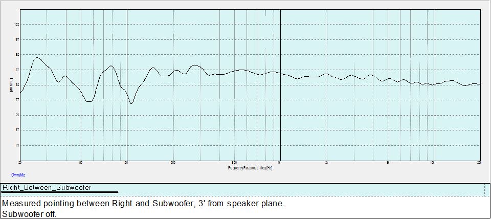

Let me show you what I mean with a graph of my main speakers in my living room at 3' away. I just took it last night as I was examining the best way to integrate a subwoofer.
Please keep in mind, this is in-room, far field response, this is not quasi anechoic! Meaning, these are great measurements from a single speaker with a 7" woofer.

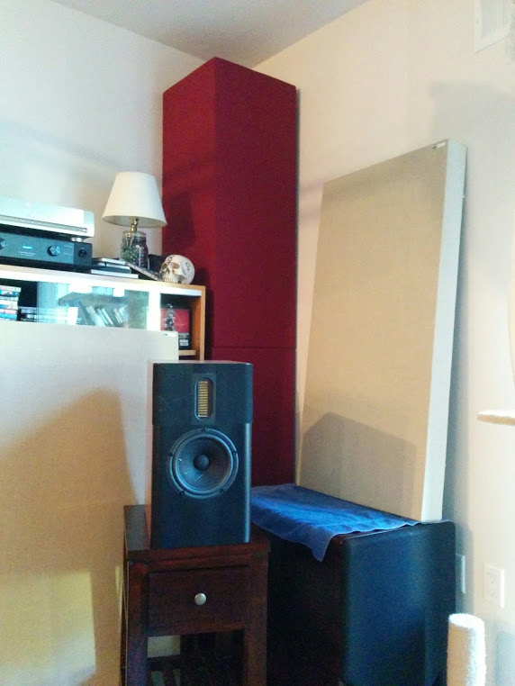

I can only get results this good due to the pair of bass traps from GIK Acoustics I am using in the corner behind the speaker. Did I mention this was taken with NO subwoofer? The subwoofer was off for this measurement. In fact for music I currently do not use it at all, it only comes on for movies.

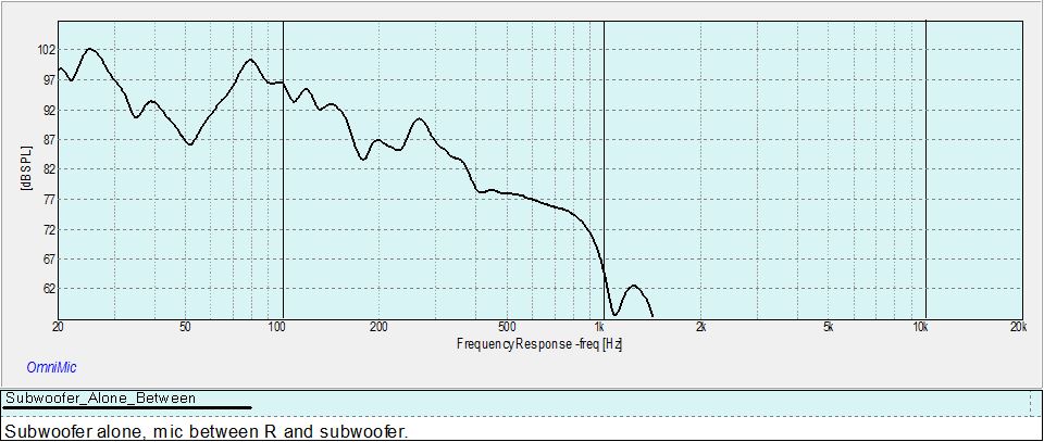

My goal when I add the sub is not to add bass to much as to integrate the bass. See the big dips in the speaker response around 100Hz and 70ish Hz? I want to remove those much more than I want to add bass. Now, let's look at the subwoofer response:
attachment.php
This is actually a very good plot for a subwoofer in a living room, however it still has some big peaks. If I were to try to add this to my main speaker response it would accentuate the room modes at 25 and 80ish.

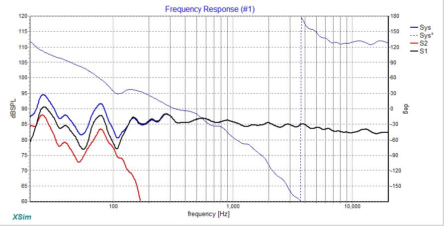

I used XSim to simulate a pair of scenarios. The first where I just add the subwoofer:
attachment.php
The top blue line is the predicted final outcome. You can see both speakers are going to accentuate the same modes.

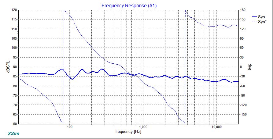

But now, what if I had heavy duty DSP on the subwoofer, and crossed the main speakers over at 80 Hz? Hmmmm...
attachment.php
Of course, this assumes that I have absolutely perfect sufwoofer response that has been perfectly phase matched.
