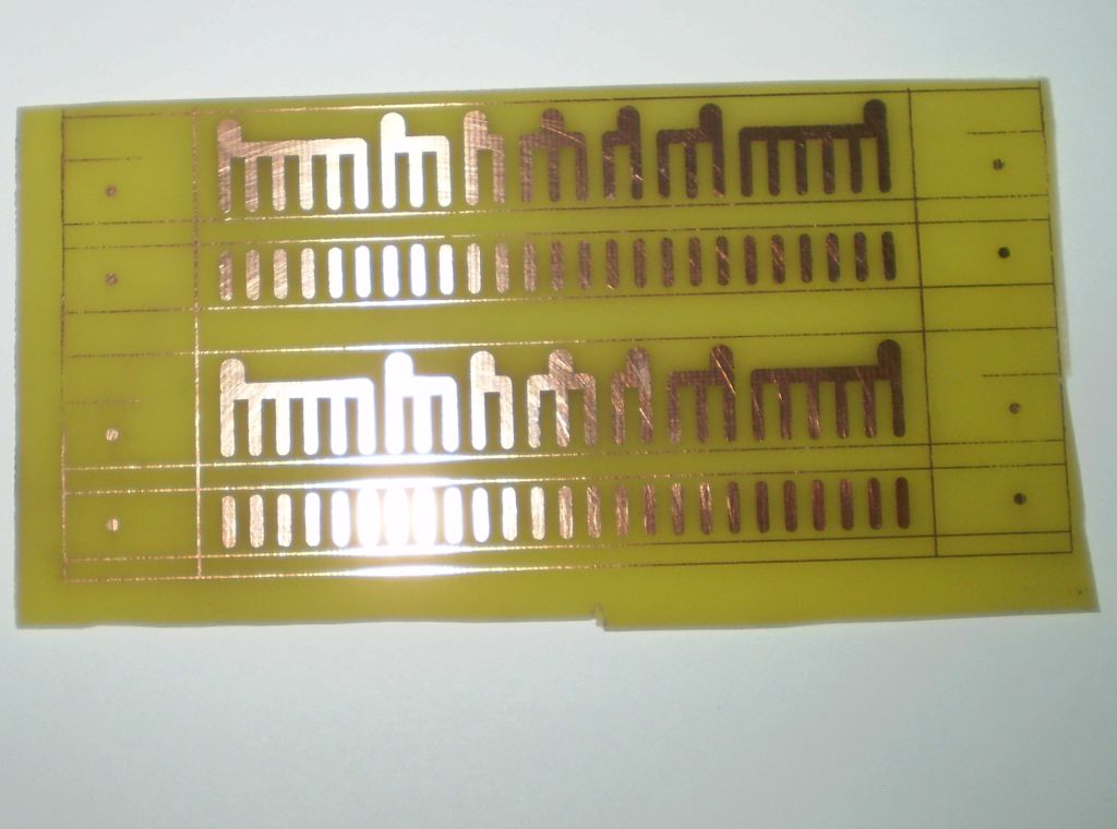

You can use Eagle to draw a polygon with holes.
Just draw a signal line in the schematic editor, give the polygon the name of the signal and use ratsnest to show your work in the top or bottom layer.
I made this in a few minutes.
That looks good. If I knew how to operate Eagle it would be a piece of cake I suppose. I did give it a try some years ago until the steep learning curve made my head explode 😀
Perhaps I should give it another try.. or pay someone to make the layout.
