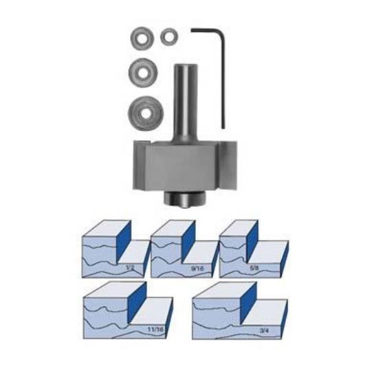

Deep - over sized router bits are hard to find - most of the step bit go up to 1/2" this starts at 1/2".
I.e. 1/2", 9/16", 5/8", 11/16", 3/4":
Buy Whiteside 1960 Deep Multi Rabbet Router Bit Set 1-7 8 D X 1 CL 1 2 SH at Woodcraft.
I looked for better pricing, but the 1/2" (max) pops up.
I don't understand the comment you're making, or the question you're asking.Deep - over sized router bits are hard to find . . .
For the casual reader unfamiliar with routers:
The router bit in the link is designed to form a little "shelf" (rabbet) on the edge of a board or a cutout. The width of he "shelf" is set by the difference between outer diameter of the cutting flutes (1-7/8") and the outer diameter of the pilot bearing. The bit comes with 5 interchangeable bearings, so you have a choice of 5 different rabbet widths - in 1/16" increments from 1/2" to 3/4".
To change the width of the rabbet simply change the O.D. of the bearing. Some quick arithmetic tells you the bearings supplied with that router bit have 7/8", 3/4", 5/8", 1/2", and 3/8" O.D. Ball bearings come in standard sizes and are readily available from a variety of sources, such as real hardware stores (if you can find one), auto parts stores, appliance repair shops, commercial power tool dealers, industrial supply jobbers, etc. (If you're in a hurry, seed a search engine with "Grainger".) If the bearing OD you want isn't available with the correct ID (bore) size, you can shim the bore of a bearing with larger ID, or add a collar to increase the OD of the bearings in this assortment. Woodcraft may offer a kit of collars, or even additional bearing sizes, to fit this router bit. When trying to create an especially tight joint I have been known to carefully add a layer or two of duct tape or heat-shrink tubing around a router pilot bearing, to make small adjustments to the rabbet width. (Not a durable solution but good for a cut or two.)
The height of the "step" above the rabbet is infinitely variable by how far the bit extends past the router base - anywhere from a few thousandths of an inch, to 1" (the length of the cutting flutes). You could actually cut even even deeper than 1" if you do it in several passes - I can't think of any place where I needed even a 1" step depth in the projects I've done.

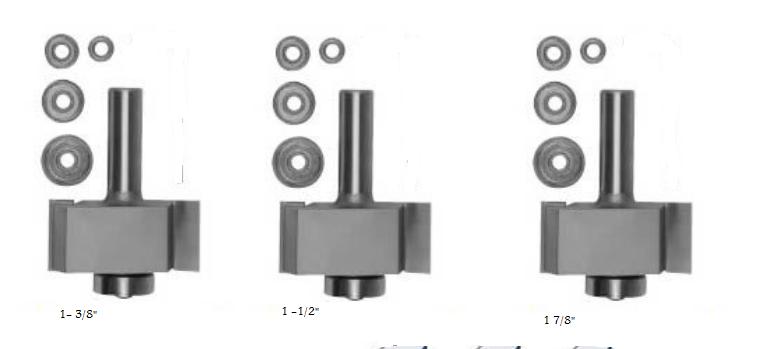

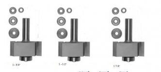

Clarification? Fair enough:
The width of the wings is important; popular sizes are (as shown)
1-3/8" 1-1/2" 1-7/8" (1960 Whiteside link)
There are drivers that need a "wide" shelf, 9/16" is pretty common; needed 3/4" not long ago.
The 1-1/2" wide wing can go to 9/16" if you can find the 3/8" mini bearing. A question would be where to find them? I have a couple borrowed from other bits. [I will check local]
Question II. Would like to send a handful of dull bits to be sharped, any thoughts?

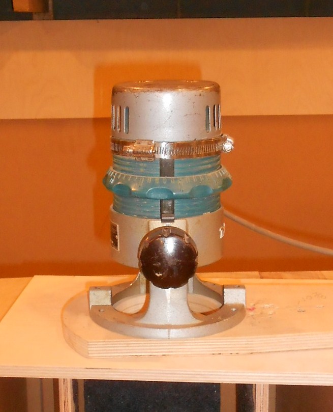

I was having problems getting an accurate depth adjustment in my router table with my Rigid. Easy to set as it has a T-handle to go in from the top ( base), but when I clamp it down, it moves. So I went to the store to see how all the rest are built, and the Rigid is actually one of the better. The Bosch is the same basic design, but seems to work a tad better. The problem is when you open the clamp, it is hanging buy the one block on the side, so it rocks in the base. This tilt is what causes the slop. So, either I fight it a lot, or I think that is why you buy a Bench Dog lift.
I can tell you what not to buy; I got stung on this router
You can see some fixes in photo - however the worst part is the plastic base (threads/screws) wears out and the router rocks in the base.
It useless for anything other than cutting a edge or something easy.
I may PLUNGE this router in the river
