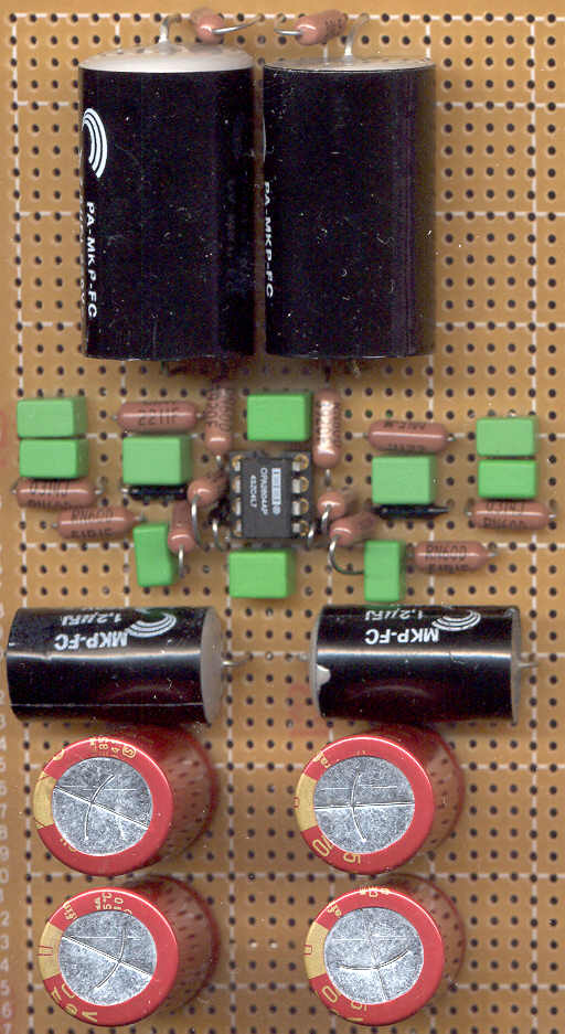

I recently purchased a turntable and am now in need of a preamp for it. I would really like to keep it as simple as possible, but still have very good sound (detailed, warm, smooth highs and mids).
I first was looking into Project 06 over at ESP, but decided against the multi-stage design because it would cost too much for opamps. Then I stumbled upon Thorsten's "El Cheapo Phono Pre" circuit... You can find it here if you need the reference (though I think most know of it).
I really liked this circuit... it was much simpler and is supposed to sound really good. I cannot get the parts he recommends, however... so I suppose mine will not sound as good.
I then was looking through the forums and found RJM's phono pre... it is on here somewhere. It is a tad simpler than Thorsten's, but not really tried and true. Not many (if any) people have built it and reported that it sounds good.
I am not sure which to go with... Thorsten's is just slightly more expensive, but which would be better?
(oh BTW- in Thorsten's circuit, could the value of the 681k resistor to ground from non-inverting input of the opamp be lowered to 562k-ohms? I cannot get 681k from my supplier)

There's quite a detailed thread on simple phono preamps here:
http://www.ampchipdiy.com/phpBB2/viewtopic.php?t=218
Also descried is how to reduce Thorstens circuit to MM input only, which should reduce the cost for you.
I'm sure you can reduce the value of the resistor you mention, then change it at a later date when you can get hold of a 681k

I build Richard's op-amp based phono pre three years ago, and it's quite good, especially if you follow all his (optional) enhancements to the power supply. MM only, however.

Ok, I think I have finally settled on a combination of both of these. I am going to use the values and parts specified in Thorsten's preamp, but have everything wired to a dual opamp as per RJM's. I will be using Wima FKP2, Solen, and Elna Cerafine caps, and Vishay/Dale and Holco resistors... so it won't be too bad off of what Thorsten recommends. Maybe a tad on the dark sounding side if anything... but if I use a different opamp I might be able to brighten things up a little. I just hope I didn't forget any parts...
needtubes said:and Vishay/Dale and Holco resistors...
You really don't need to splash out for exotic resistors. Spend the money on two opamps instead of a dual one, and pay close attention to the power supply.
If you can handle SMD you may want to consider the AD8610 opamp in Thorsten's circuit.
The resistors aren't really much more than the normal ones I use... and I have used Holco before with MUCH better results than the normal resistors I have used previously. And besides... I already have tons of opamps (I build headphone amps for people).
My plan was to use the dual opamp config so that I could use any opamp I wanted. I could just very simply drop in the dual opamps I have, or use the Browndog adapter to use two single opamps in the same config. I also could save on the power supply caps... since those were the most expensive parts I bought.

I finished the preamp today... and it sounds great. 🙂
I had a thought half way through the first channel, though... I have Vishay/Dale resistors standing up on their ends next to the opamp socket... so I won't be doing much opamp rolling with single opamps on an adapters, I guess.
Maybe I can work it out anyway.
Well... sound-wise, it wounds really good. I have a slight hum... but this could be from not grounding the TT to the preamp... or form the cartridge picking up motor hum (the motor does emit hum that you can hear... and it domes through the speakers, too)... the hum could even be from not having the preamp shielded- it isn't in a case yet. But, ignoring the hum, it sounds great. Bass is really solid, treble and mids are very clear and clean. Gain is just about right, too. Sounds much better than it did before.
Perhaps a little dark sounding, but I understand this is because I used Wima FKP capacitors in the RIAA filter. I am really enjoying it, though... and suppose it will probably sound better still after the components start to break in. So... back to listening now. 😀 I will post a picture of the board later. 😉
