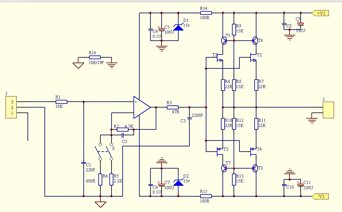

I recently dusted off this ebay-bought pcb I had sitting in a cupboard for a year or so. Whilst I do have the schematic (see pic below) and recall that the circuit uses 2SK170 and 2SJ74, I don't recall what opamp it was designed for. Is anyone able to assist?

Is it a single or a dual?
It needs to be unity gain stable.
Definitely single - there is one socket per channel
How did you determine it needs to be unity gain stable?
What is a good starting point for a unity gain stable DIP single channel opamp, which runs at +/-15v?

It seems to be the same schematic as on this one
eBay - New & used electronics, cars, apparel, collectibles, sporting goods & more at low prices
And they stated to use OPA627.
