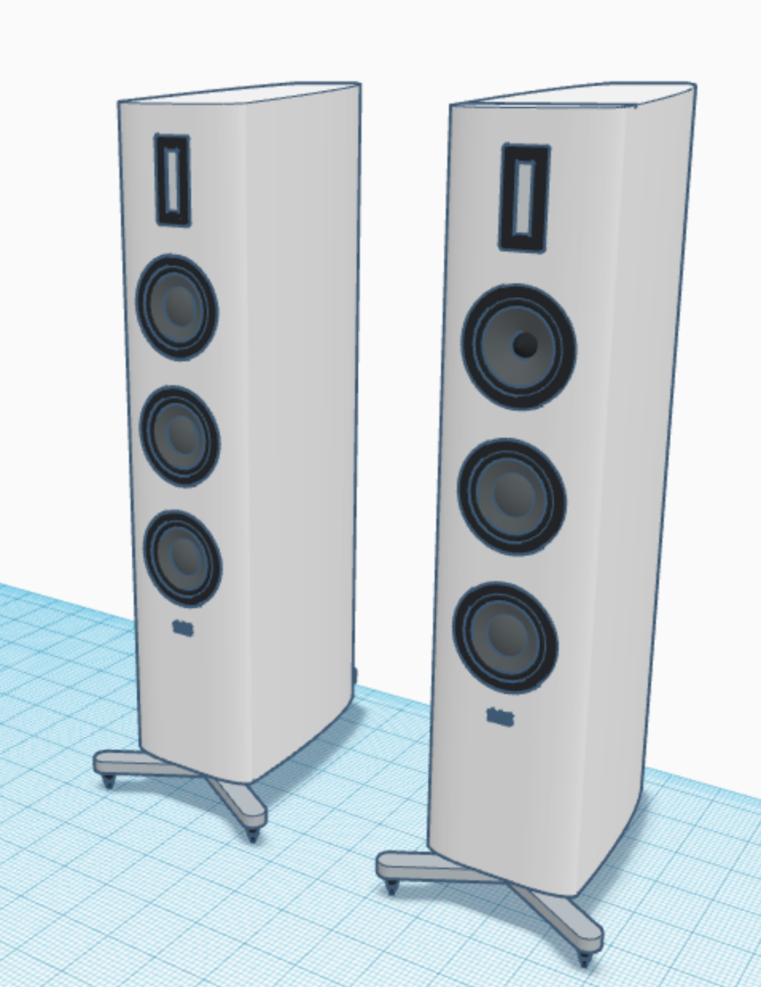

I've recently listened to the Sonus Faber Olympica III and they made the magic that comes out of those mid woofers made me realize how much I want beautiful, dynamic, warm and lifelike midrange and I started worrying about having a good enough mid woofer in my 3-way towers the deliver the midrange I want.
So what do you guys suggest would sound better (with that I mean more natural, dynamic, lifelike, warm, clarity and perhaps detailed) as a mid woofer, a Dayton Audio RS180P-4 or ES180Ti-4.
The one with the Reference Series RS180P-4 will be coupled with two ES180Ti-8's as woofers. The 7" RS has a phase plug, paper cone which are known to be good for midrange, and that paper cone is driven by a 1-1/2" voice coil which can handle 60 watts RMS. The results are a butter smooth frequency response, especially in the range it will play in my application, and it sounds good (see above what I mean with good) according to the reviews, I already expect anyway because of the phase plug, paper cone and everything around it.
The concept also has some cons though. The woofers I will use with it are two ES180Ti-8, I can't chose different woofers because I already have two of these. There are two versions of this woofer, the Ti and the TiA. The Ti, which is the one we're talking about now, I chose because I were originally building bookshelf speakers and the Ti version has a slightly higher sensitivity than the TiA which is nice for getting the most output from such a tiny speaker for when I want it but I recently noticed the Ti also has a enormous impedance peak around 40 Hz, right in it's operating range, which might not be too big of a problem to with help of the crossover, actieve DSP driven in my case, but it would still be nicer to not have it there. Also, now that I'm using two woofers in a tower instead of one these woofers can play very, very loud, so loud that it's very hard to about match the output with a single tweeter and especially mid woofer.
The concept with the ES180Ti-8's as mid woofer and two ES180TiA-8's as woofers on the other hand solves the problem of the huge impedance peak in the operating range of the woofers, this peak at 40 Hz is way smaller with the TiA woofers. And the ES180Ti-8 as mid woofer won't remotely play 40 Hz, so that problem is solved.
Also, I certainly don't doubt the Reference Series woofer will have very good midrange performance because Dayton Audio might be a relatively budget brand, in the Netherlands €70,- for a Dayton Audio Reference Series woofer is certainly not cheap and I know that Dayton Audio products are known for performing like something twice their price but I still wouldn't mind an upgrade, and I'm pretty sure the Esoteric Series woofers will definitely be one.
Almost double the power handling and in diameter twice as big voice coil as that of the Reference Series woofer will for sure make for an even beter impuls respons, reviews also seem to be even more stoked about the dynamics and clarity than they are about the Reference Series woofers which might not be a surprise given it's more than twice higher price but that doesn't say everything because of the completely different construction with it's woven glass fiber cone without a phase plug.
But it also certainly has some cons. The maximum output is over 5 dB lower than that of the two TiA woofers together, that of the Reference Series woofer is only 2 dB lower so that would be wat less balanced and it would badly limit how loud the system can play when I want it to. And also there's the double price.
Also the army with three of the same Esoteric Series woofers does certainly not look bad in my opinion but a truly dedicated looking mid woofer looks way more fitting to me.
But at the end it's mainly the resulting sound quality that matters here so what do you guys suggest would sound better at the end of the day? If we don't consider the extra expense, aesthetics, politics and certainly not the WAF since I'm a 15-year-old.
Would like to hear your opinion.

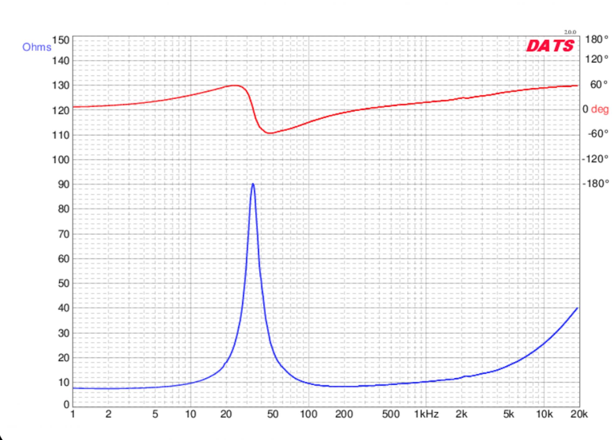

"impedance peak around 40 Hz" - this is normal, nothing to be concerned about

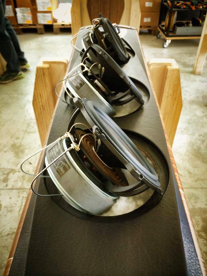

Just look at these huge magnets on the 7" woofers, i wonder where they come from. Definitely not a Scan Speak.
might actually be Scan Speak, quite a few Revelator series woofers quite look like that.

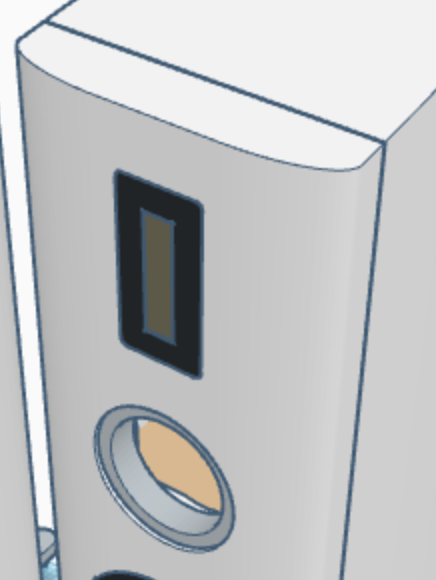

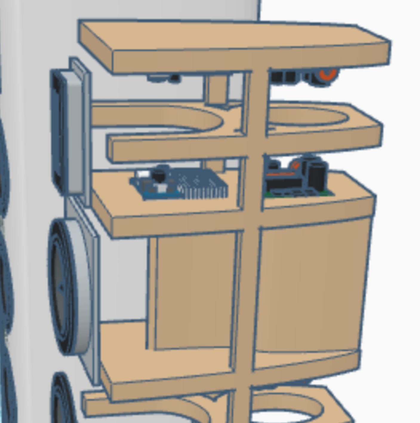

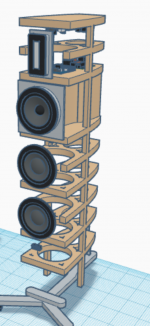

My enclosure design is on point. I've measured the height of my ears when sitting in the couch on which I'll be listening, 1,1 m, the tweeter is placed just about 5 cm higher than that, perfect.
I already decided to make the midrange chamber sealed because of the better impuls response, it also has a shape in it which very subtly leads to nothing (don't know what it's called).
In terms of size and available volume for the woofers it's just alright as well. When I design my speakers I first determine how high it has to be for the tweeter to be at the right height and then look at how wide the baffle has to be at a minimum. The I start 3D modeling and I determine the the ratios of the dimensions of the enclosure which I find to look the best, cm by cm. In this case it turned out to be 125 cm high, by 27 cm wide by 50 cm deep making for about 80 L (2-1/2 to 3 ft3), which is so motherF-ing big that I'm gonna make the woofer section a MLTL.
Further the enclosure has curved sides, rounded edges, an slanted top and metal feet to place the entire thing on and tilt it, which doesn't only make the design complete and as beautiful as it in my opinion can possibly get, but also helps realigning the phase.
Further features of the design are decoupled tweeter and mid woofer to minimize the vibrations the pick up from the woofers, mounted on soft mounted aluminum adapters which I will watercut with my uncle.
The woofers aren't decoupled because that's more or too difficult and also isn't it really that necessary because the tweeter and mid woofer already are decoupled and the huge enclosure with lots of studs made out of 2,5 cm thick MDF and a double layered front baffle will already be able to handle the vibrations of the woofers by itself.
I have already found and bought a tweeter though, the Fountek NeoX3.0 ribbon tweeter. It's maximum output can totally compete with that of the woofers, and there's obviously also the sound quality and sound quality to price ratio reasons why I chose a ribbon. I love them.
And just to let you know, the entire thing is actieve powered by triple mono HifimeDIY T3 mono amps with the Jantzen caps upgrade with two MiniDSP 2x4's as actieve crossover and DSP.

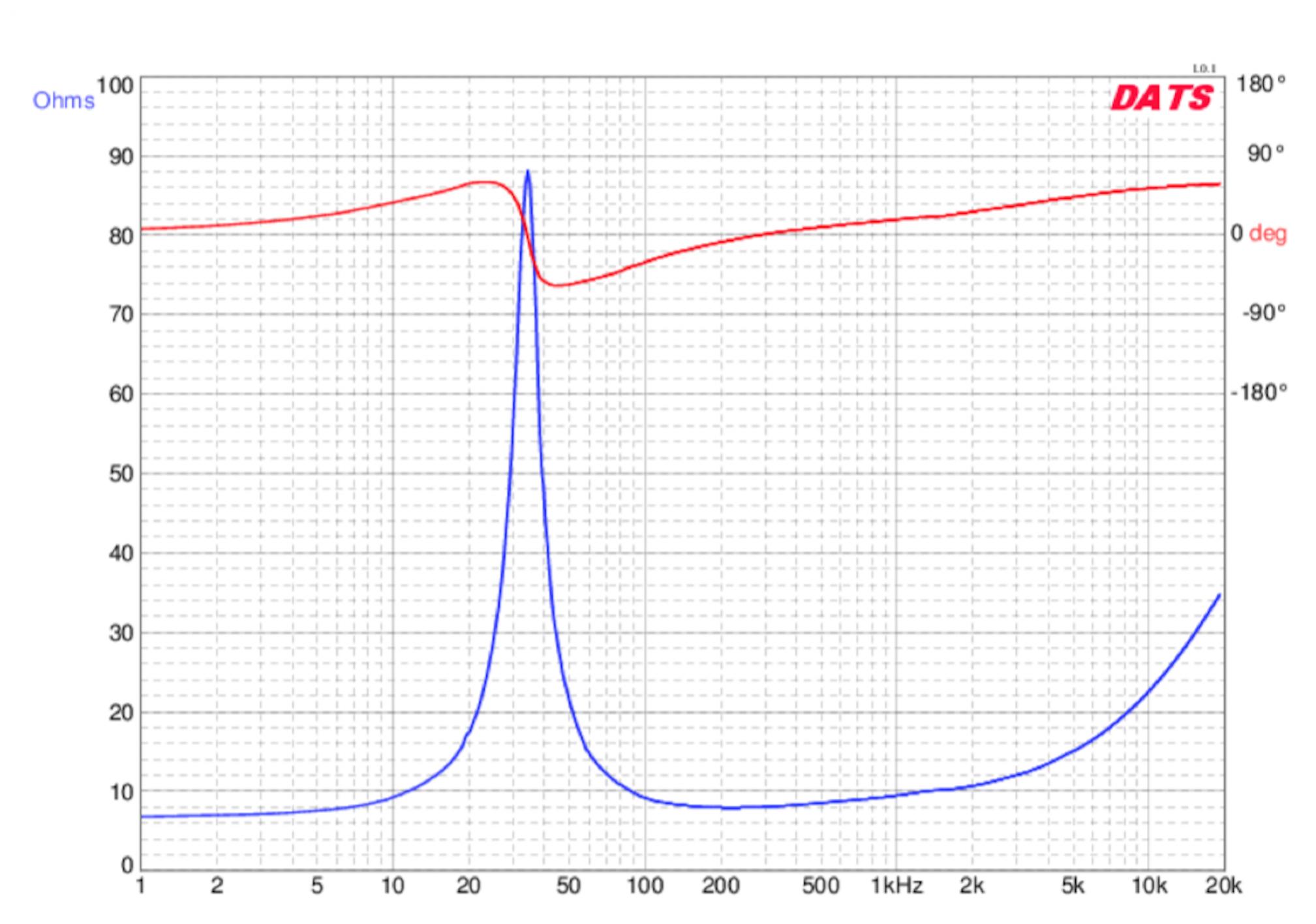

Oh my god guys, I'm so sorry and already internally laughing myself to death. The impedance peak is exactly the same with both woofers, it's just because of the smaller sized graph making the peak look way bigger, if I would have actually red it instead of just looked at it this would have never been a problem. Man I feel so stupid.

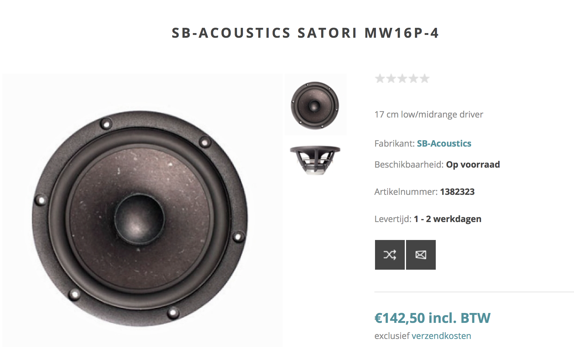

Then, the SB Satori MW16P-4, I don't really know anything special in terms of extreme features but it just does look very high end. It has a nicely shaped paper cone and that very high end sort of motor structure and in terms of specs it's pretty good as well. It can handle 60 watts RMS and has a sensitivity of 90,5 dB, the highest of the list I compared, so that's exactly the same as the Dayton Audio Reference Series woofer making it the second loudest one on the list with 108,1 dB max output but with a price tag of €142,50 it's the most expensive one on the list though.

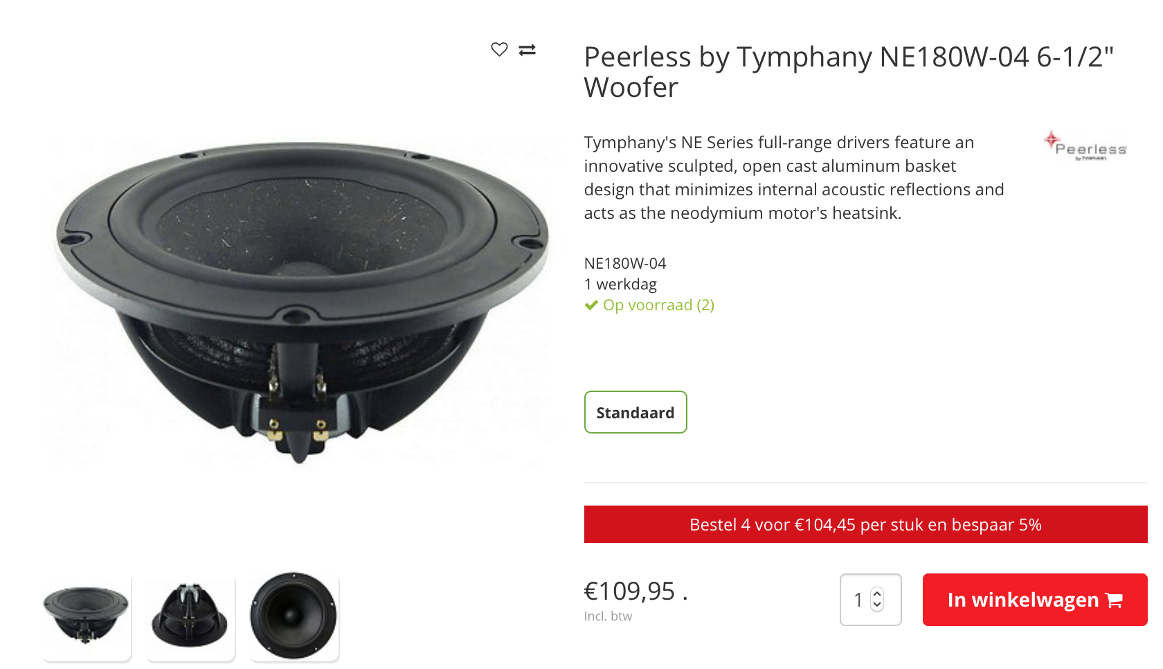

Then, the Peerless by Tymphany NE180W-04. It has that same high end kinda motor structure as the Satori but just a little simpler which is understandable because with €109,95 it's the least expensive on the list. It also has that same sort of very promising looking paper cone like the Satori but surprisingly, this one can play very loud. it has a sensitivity of 88 dB but for it's price a pretty bulky power handling of 80 watts RMS making it capable of reaching 109,1 dB, which is the highest.

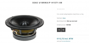

But now, last but certainly not least: the SEAS U180RNX/P H1571-08. This thing is by far my favorite. You know when you're just scrolling through the products list and see something nice you go like ooh but when you see absolutely amazing you go like (inhales like being scared) holy! with rounded Trump-like lips and get an erection? When I saw this woofer, I had that last one. A beautiful black phase plug (which is good for midrange obviously) in the middle of that unbelievably gorgeous woven polypropylene (which is good for midrange) nicely curve shaped (which is good for midrange) cone. Visually it's the most beautiful mid woofer I've ever, period. The similar looking cone material also makes for nice unity between the woofers and mid woofer.
And not only visually, for sound it's pretty good as well. The cone shape and material is obviously a pro. It's the only one on the list with a phase plug which is a huge pro, and looking at the specs of the motor it's pretty good as well, 80 watts RMS an motherF-ing 250 watts peak (higher than the woofers!) from a decently sized 1-1/2" voice coil driving the second lightest cone on the list with a mms of just 13,4 g. And it's medium price tag of €112,72 is nice as well.
I think the SEAS is the clear wi new for me but still tell me what you think.
