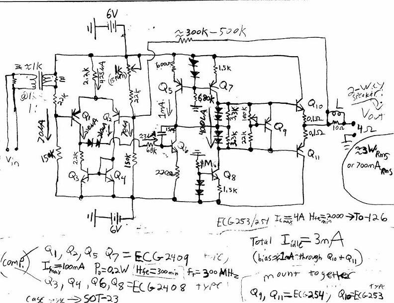

I thought that this may be interesting to use descrete componants for a portable small amp, with good dynamic range.
I took it upon myself to do some calculations, please check them.
This circuit would require two 6V lantern batteries, and could be constructed inside a small speaker box.

Hi Cunningham,
Thx for your effeort! I will check it out. I probberbly need to modify a bit to make it run of a single 9V supply. I would like to test it in 8 Ohm bridged.. not many 4Ohm small speakers around :-( .. Could there be a way to bootstrap the VA-stage in both directions? getting another 0.6 Volt PP from that?
