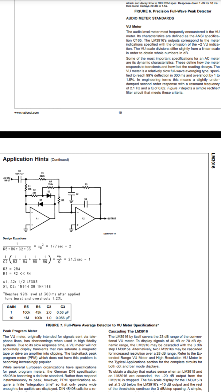

I'm getting ready to build up a VU meter with a pair of lm3916 for show, and also to monitor input to some amplifiers, and was curious as to which circuit from the datasheet would be a better general purpose use design, figure 5, figure 6, or figure 7.
I want peak hold, bar (not dot) style and average volume level to be read out. Would figure 5 or 6 be best for this? Any tips or ideas to make it better?

If you want a VU meter then use the VU meter style of circuit, i.e. fig7 into SIG.
If you want peak detecting, then feed Fig6 into the SIG.
Looks like you use pin9 for bar mode.
Looks like figure 7 it is then.
Do you think building it up with a gain of 1, or gain of 10 would be more useful? I'm thinking 10 would be best, as it can simply be attenuated if needed.

Yup, per the thread title, I'm going to build the lm3916 up. The original question was which circuit from the datasheet would be best for the input circuitry.
I've attached the screenshot of the circuit, figure 7.
