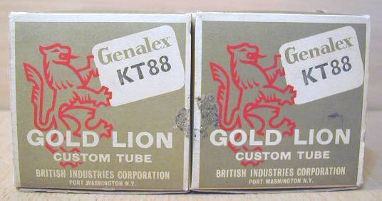

If u dont have budget limit, Gold Lion (Genelax) is the choice.
But if u need to consider the price, China made GECKT88 from shuguang (not expensive and they simulate the design from GEC)
There is another tube name CV8286 (with top cap) which is GEC made equivalent to KT88 BUT u need to make some modification on your amp.

Yeah...kind of the monoblock version of it.
I'd fit the 6CA7.
Yeah....Show one that's actually a real one.
Oh...and I'd still not part with my money anyway.....
Wait a minute...the entire world if a fraud, isn't it?
Scam, scam and scam....

Surely the boxes look good but I've seen too many frauds to go by the looks...
Oh, even if and when they're real, are they worth it?

GOOD Question!!!!!
Worth or not?!?!?!
Just like NOS WE300B, PX25, Telefunken EL34......
My opinion is as long as u have built a nice amp., make use of all your effort, all your feeling......thats already enough.
What is the best amplifier? All depends.........
